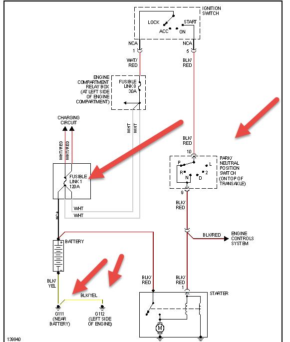

Check items in pic fusible link may ony have a few strands causing problem or fuse not making good contact with fuse box.

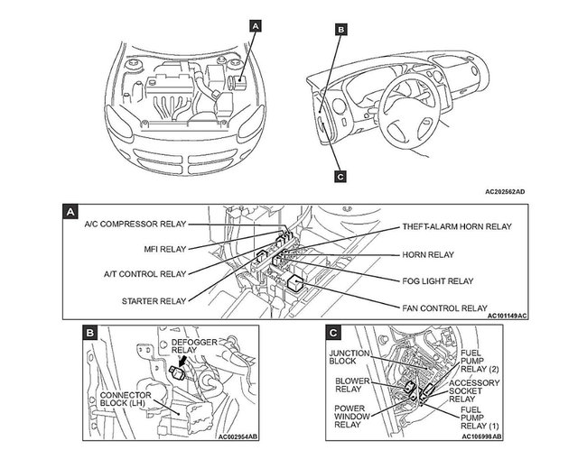

I've checked all of the fuses one by one and they are all good. The battery voltage is good. A friend was filling the AC system with the car running and the car just died. Just shut down, quit. Car will not crank, SOB! I jumped the starter with the key on and it cranked very well but no hint of starting. No spark or fuel. Is there an anti-theft module on this car and if possible, can I re-sink the modules with a scanner? I will have to borrow one. The instrument cluster says, "No bus." VIN is 3C3EL45H4YT245468. It is a 2000 Sebring JX convertible. I also found out that the car had been in a major accident a long while back and was pieced together with another car! OOOOOHHHH BOY!
Friday, October 18th, 2019 AT 1:47 PM (Merged)
KHLOW2008
  • 41,814 POSTS
Hi Bralden,
Getting a scanner to check for trouble codes would be a good idea before we continue further. If any codes are present, it may tell us what has gone wrong but it sounds liker the instrument cluster has gone bad which is common. (starter relay location below)
We shall start with the starting circuit first
From the schematic, check if power is available at the starter relay terminal # 87, hot at all times and terminal # 82, hot in START position.
https://www.2carpros.com/forum/automotive_pictures/192750_Starting00SebringFig35a_1.jpg
https://www.2carpros.com/forum/automotive_pictures/192750_Starting00SebringFig35b_1.jpg

(1)I borrowed a tester from a friend but will not communicate with the car to retrieve any fault codes.
(2) the dash indicator lights are showing, i.E. Red oil cup for oil pressure, "Service Engine Soon" lights up after you attempt to start and release the key, that is when the window that displays the PRNDL shows up "No BUS, the fuel gauge registers 1/2 tank which is about right.
(3) Yes, the red wire from the Battery + post to fuse #8, to terminal #87 is hot all the time, yes terminal #83 gets hot when the key is in the start position. However, there is no response from the starter. The best way to describe this is like you have your gear shift lever in "R" or "D" or some position other than "P" or "N". Now, I have learned that by running a jumper wire from terminal #83-tan wire w/red stripe, to the ground stud on the left strut tower, then the starter will activate with the key as it should, but the engine still will not fire the plugs. I determined this by placing a new spark plug in the #2 wire and grounding the spark plug-no spark.

The starter test indicates the engine computer (PCM) is not grounding the circuit for the starter relay to work.
The tester not communicating indicates the PCM is not sending any signals to it and it could be a faulty PCM or its wiring circuit.
SES indicator turning on could be due to above fault so we need to check why it is not communicating.

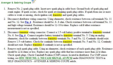

Are the cranking rpms, ok? Fresh gas, can you check fuel pressure?
Have a helper crank it, while you check for spark at the plugs.
