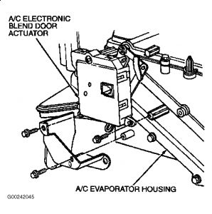

Last weekend, I lost all heating ability in my 99 Taurus wagon. Now, every morning, there is a cllicking sound behind the dash at the temp control panel area. My water temps seem normal and radiator level is good. I haven't noticed any extra moisture within the passenger cabin. Should I try replacing thermostat first, or start with the heater core, or something else?
Tuesday, June 22nd, 2021 AT 11:30 AM (Merged)
2CARPRO JACK
  • 11,533 POSTS
Sounds like it may be the blend door actuator.It is located below the pass side of the dash, you will have to remove the sound guard and the front right side of the center console (if so equipped). Verify this is where the noise is coming from first. If so remove 4 screws and remove it. Try to work the door by hand to be sure it isnt broken internally. If the door works (air will get hot) the it is probably just the actuator

DONNIE JOHNSON
I removed the blend door actuator and got a new one fixed!
