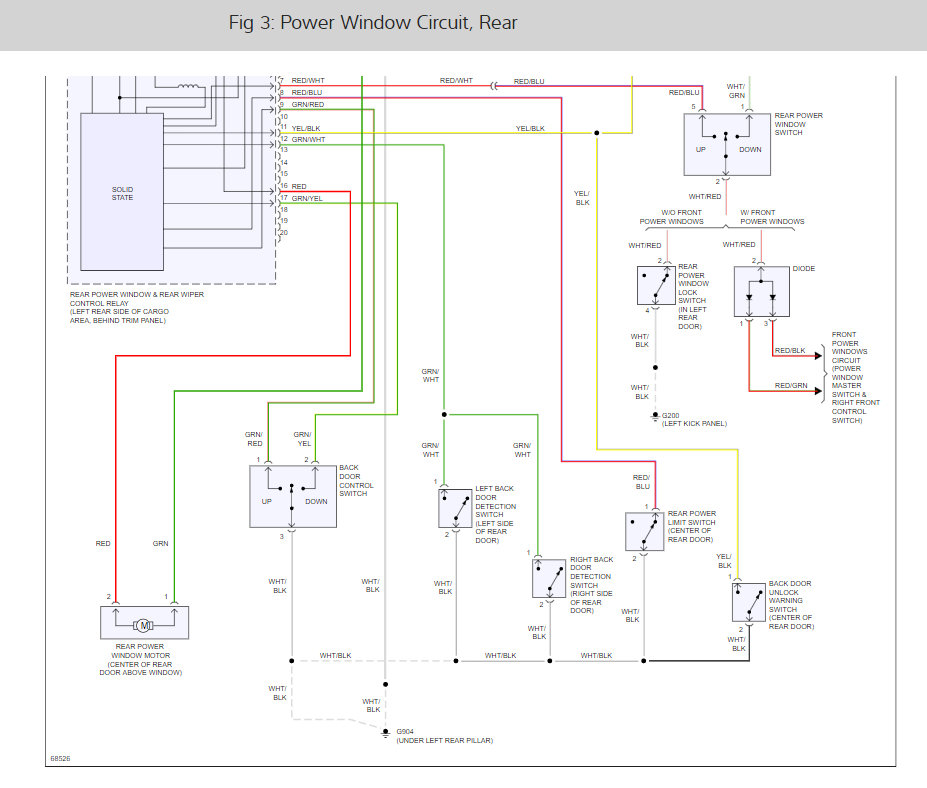

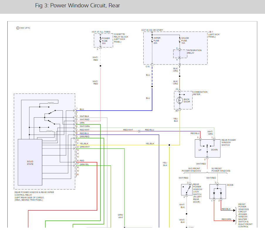

Can't roll window up or down but motor is good. can find white wire with green stripe,

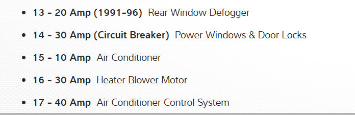

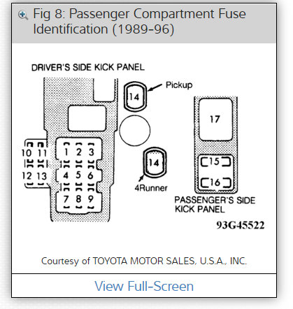

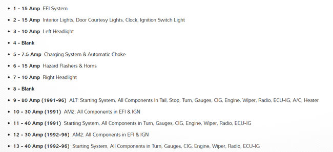

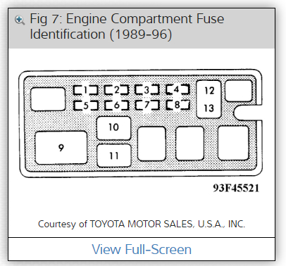

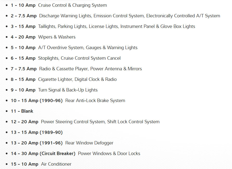

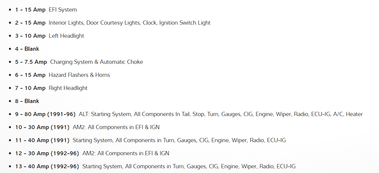

It sounds like a fuse or relay issue. here is a guide to help you check for power with the rear window wiring diagrams so you can see how the system works and which fuses and relays to test:
