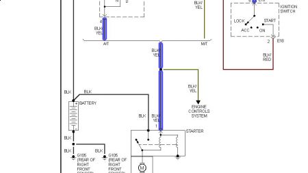

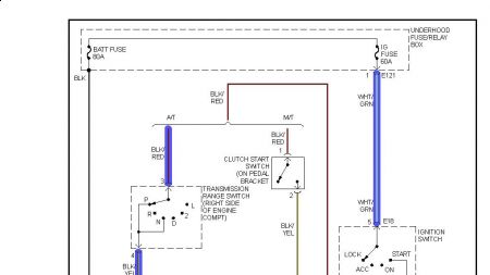

I drove it to work just fine and now it won't start. I tried jumping it both with another vehicle and with a portable battery/starter. It doesn't spin and occasionally makes a clicking noise when key is on at top of engine. I also attempted starting in neutral.

Have helper hold key at start position and you check for power at the starter black and yellow wire-power there defective starter -No power could be the transmission range switch and ignition switch.

If it does not start in neutral, does that rule out transmission switch?
Tuesday, December 8th, 2009 AT 12:46 PM
  • 75,992 POSTS
If it doesn't start at neutral the transmission range switch is either defective or needs adjustment-should start at both position
