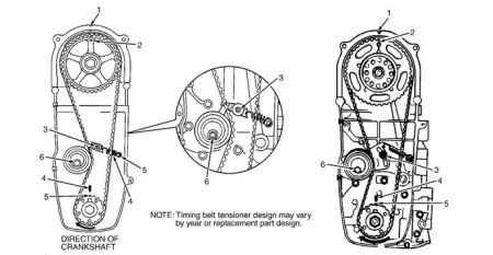

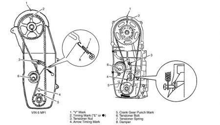

There are 2 slots on the cam sprocket. I & E. There are also a I, E & dimple stamped on the sprocket.
Where is the sprocket positioned with the crankl at TDC?
Thanks - need help
