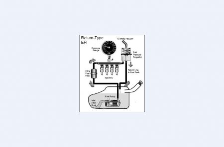

I dont know alot auto repairs. So how would I go about checking the fuel pressure?
Monday, January 19th, 2009 AT 12:22 AM
  • 75,992 POSTS
Hook up the fuel pressure gauge at the fuel filter or on the fuel rail test port
https://www.2carpros.com/forum/automotive_pictures/12900_fuel_pressure_system_circuit_9.jpg
