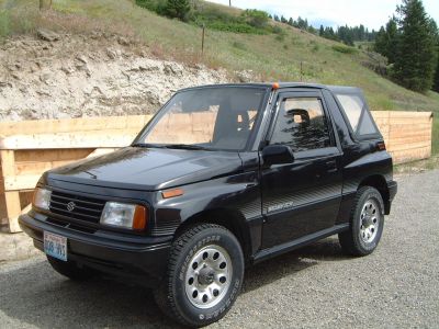

When my husband first hooked up a trickle charger, he mixed up the terminals? Since then the car won't start. Battery charged successfully. Fuel flows out of carburetor, spark plugs sparked. I understand that mixing up the terminals can cause an electrical problem of some sort. Is there something I can check to determine if that is the problem?
I should say that this is the first time the car has been started since December but I've done this every winter and never had a problem before.
Thanks, Pam

Thanks for the suggestions. I had emailed my neighbor who has two older model suzukies and he said that if he flooded his, they were done for the day. He suggested that I spray starter fluid where the fuel had come out of the carburetor and try again without giving it fuel. Worked like a charm!
Thanks for responding to my dilemna!!
