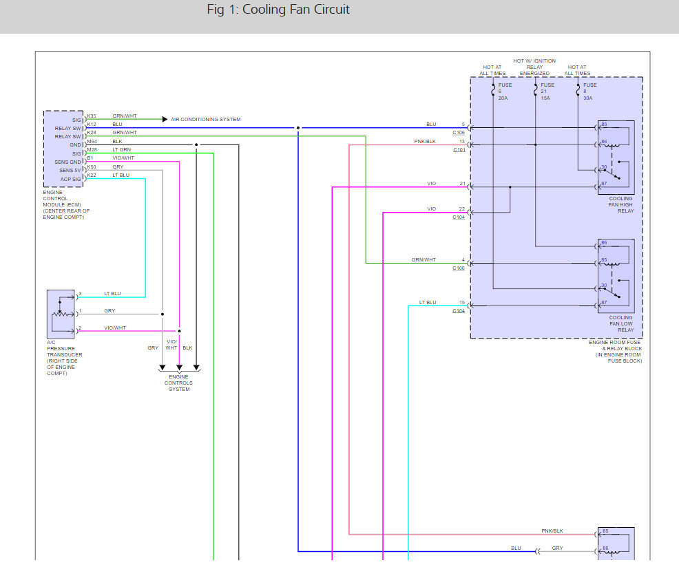

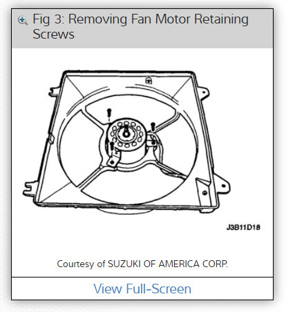

My radiator fans don't come on seem like a lot of pressure in the cooling system. I have a similar problem with my Suzuki Forenza 2005. The radiator fan is not turning on. Did you fix your problem? How? Do you have a wiring diagram for the car or manual?
Thanks
Saturday, October 15th, 2011 AT 3:13 PM
6 Replies
KEN L
  • MASTER CERTIFIED MECHANIC
  • 43,055 POSTS

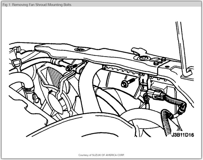

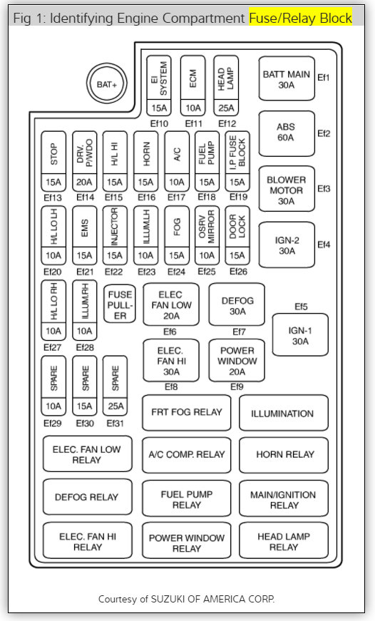

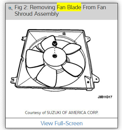

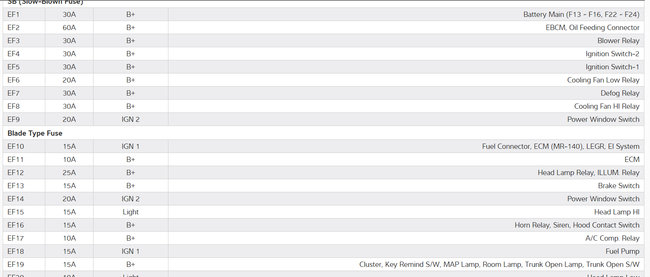

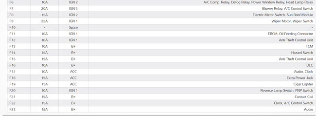

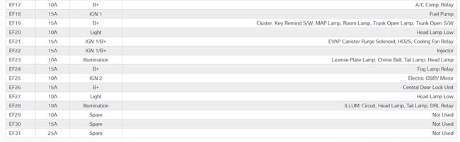

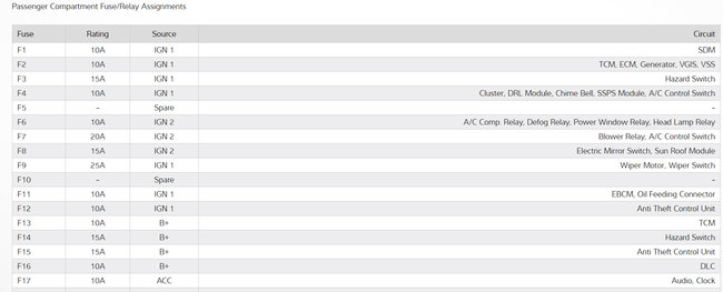

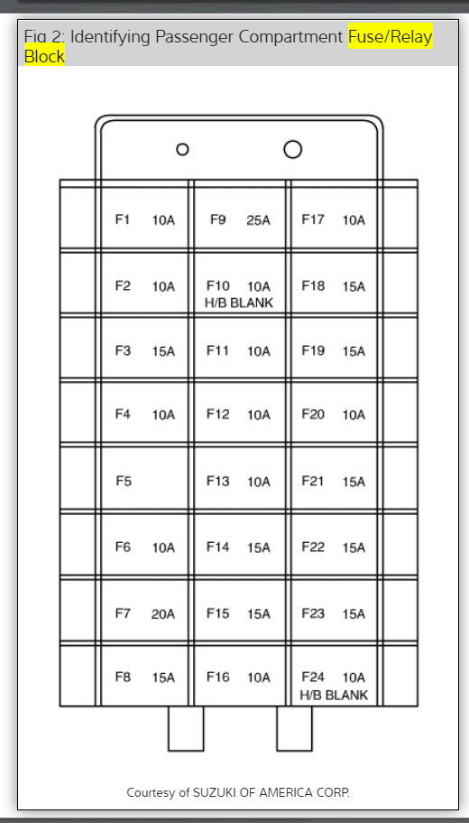

It sounds like you have one of three things that can be wrong but with a few easy tests we should be able to figure it out. First would be a fuse next a relay and third the fan motor is no good.
Here are a few guides and diagrams to help us get started.
and
and
https://www.2carpros.com/articles/replace-electric-fan-motor
Here are the diagrams (BELOW)

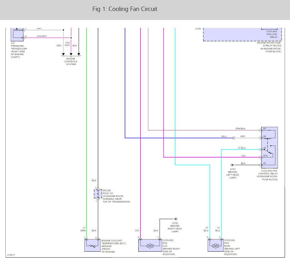

Which wires are the positive and negative wires for the
Cooling Fan Relay Switch for the driver side cooling fan
On a 2005 Suzuki Forenza so that I can directly hook the cooling fan to the car battery so that the cooling fan will come on to keep the car from overheating

BEAMTEAM
  • 0 POST
My fans quit too. I followed the diagram on the earlier post and found a bad relay. Replaced it for about $25.00 and its back on the road
