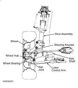

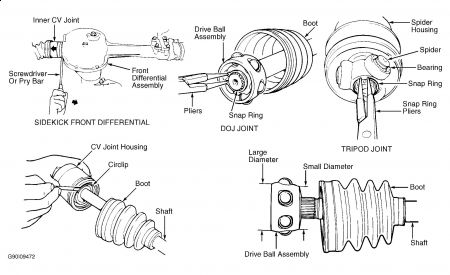

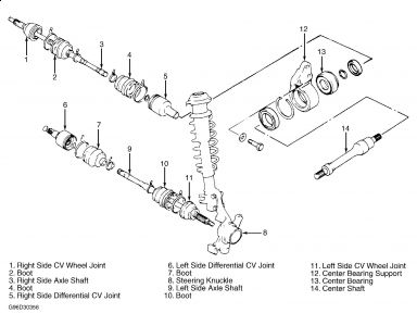

Thanks! Would you happen to have pictures/diagrams to go along with the text?
Thanks.

Hi there,
There is not much on the data base, i hope that this helps, there is no pics of the removal procedure.
Mark (mhpautos)
