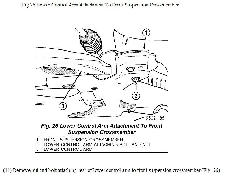

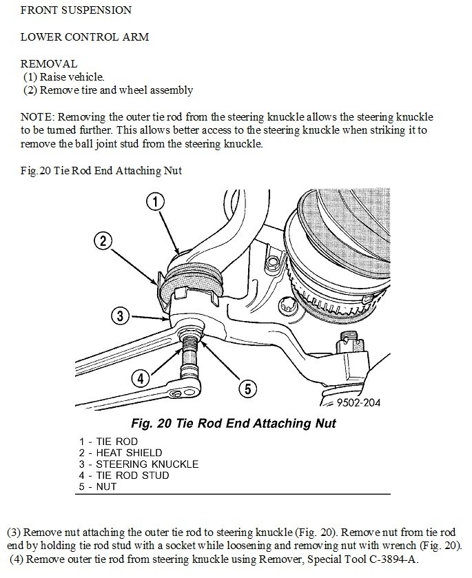

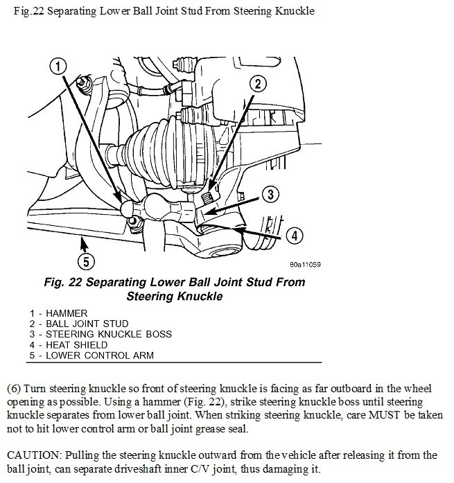

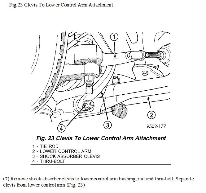

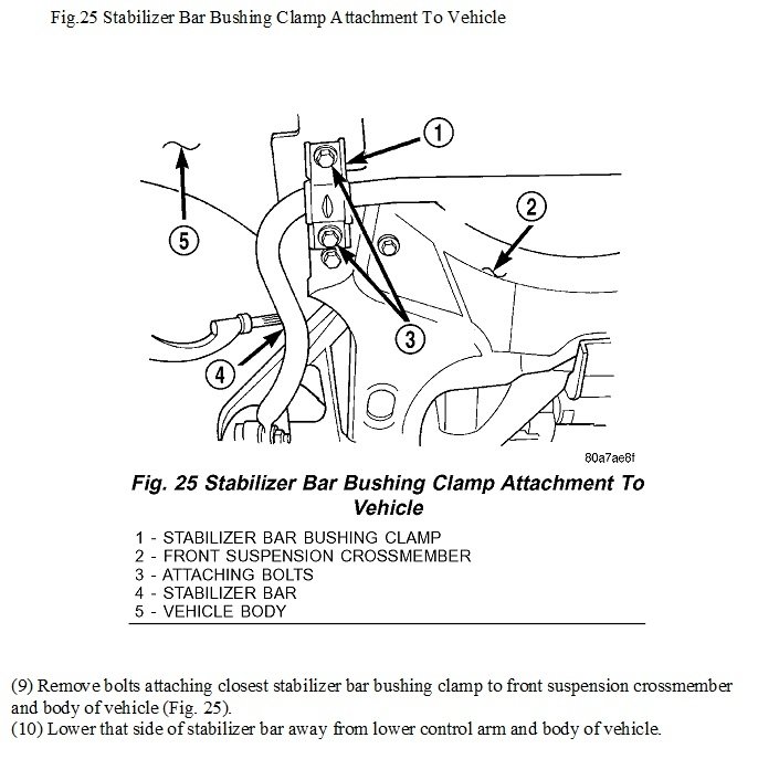

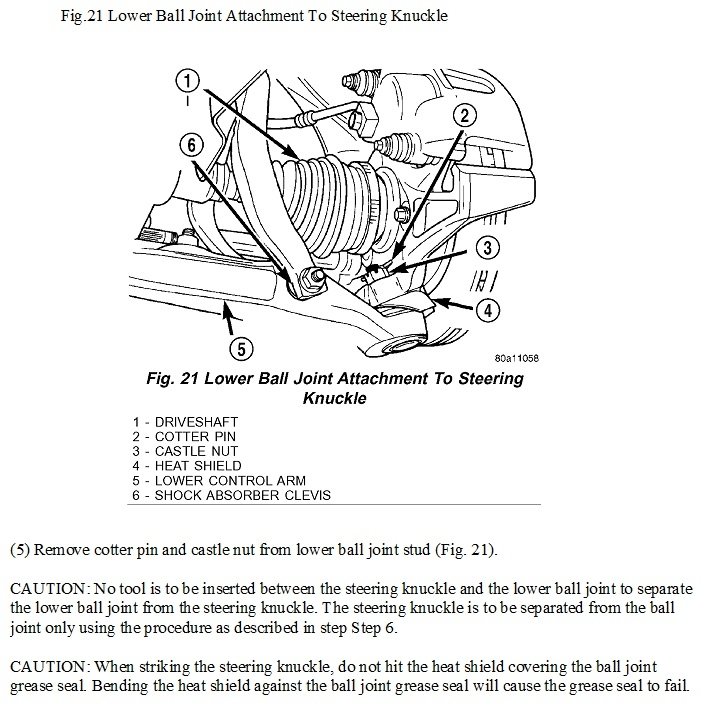

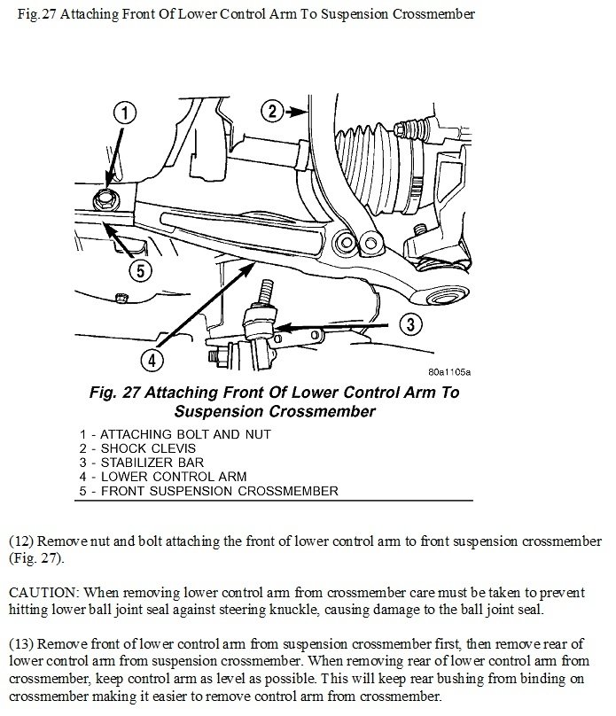

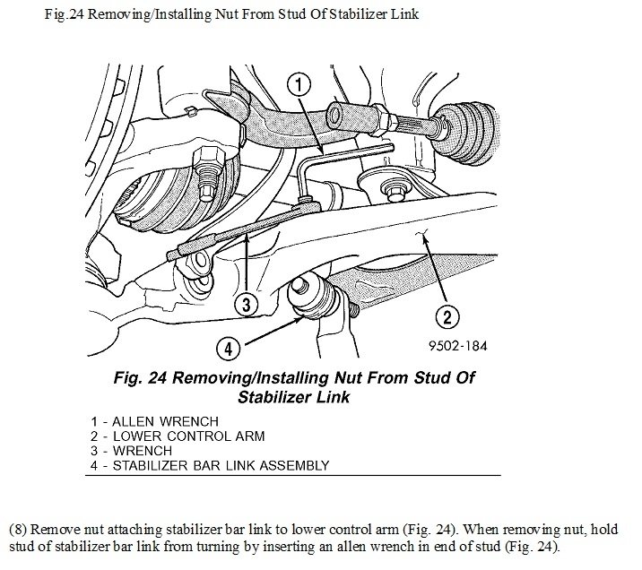

Control arm bushings are twisting when you bounce the car up and down, but they would have to be really badly deteriorated to cause a squeak. A better suspect, given your multiple observations, would be the lower ball joint. The ball rocks back and forth as the body moves up and down, and it rotates when the steering is turned. It can squeak rather loudly if it is worn / tight. That lower ball joint comes as part of the lower control arm assembly.
To verify this, reach behind the wheel and touch your fingers on the bottom of the ball joint, then feel for the binding or snapping while a helper turns the steering wheel. You can also listen with a stethoscope on the joint.
There's two version of this model; a sedan and the convertible. These instructions should be appropriate for your car. Reverse the order when installing the new part. One word of warning. The front bushing has a pivot bolt going through it. That bolt must not be tightened while the car is supported on jack stands with the suspension hanging down. If it is, when the car is lowered, that bushing will be clamped in a permanent twist that will shorten its life. The car needs to be resting on the tires at normal ride height, and bounced a few ties to settle it, then that bolt can be tightened.

SKOOTER24
  • 275 POSTS
Okay, in the stuff I have it says something about don't turn the bolt in the clevis hole because the bolt has serration on it and it will damage it.
Sunday, May 9th, 2021 AT 8:48 PM
CARADIODOC
  • 34,491 POSTS
All they're saying is you're going to find that bolt will slide in but you won't be able to turn it because of those serrations, or teeth, under the head. You turn the nut instead, and that will pull the bolt in. The same thing happens when you take that bolt out. The nut spins right off, then you tap the bolt straight out without turning it.
