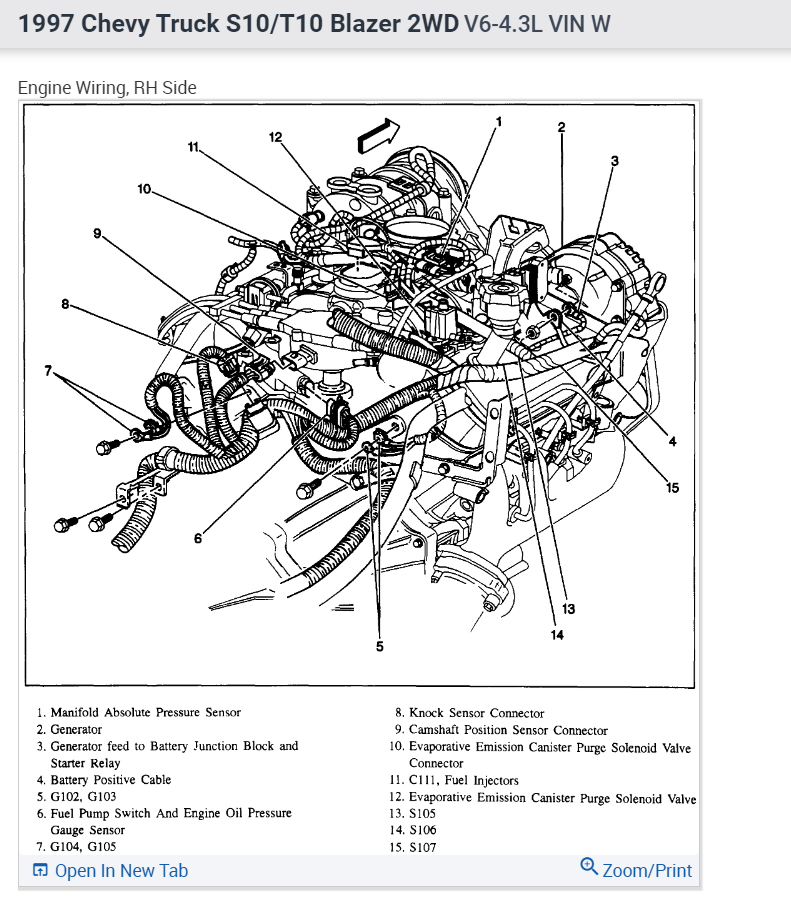

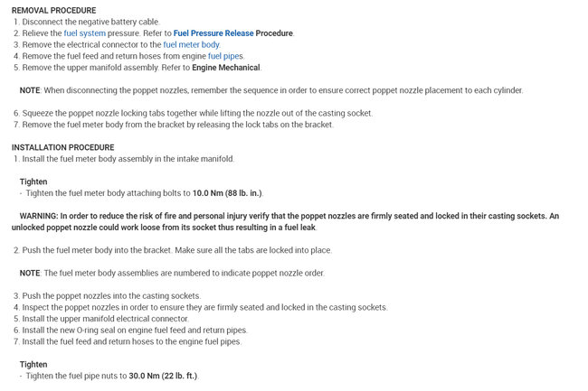

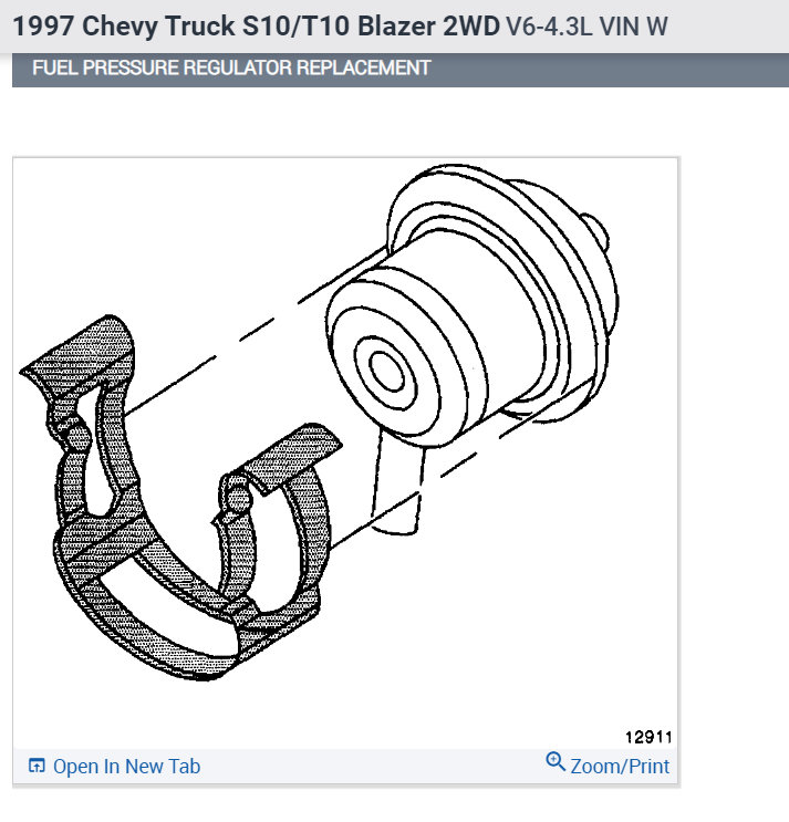

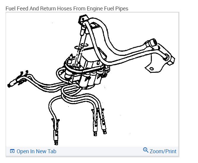

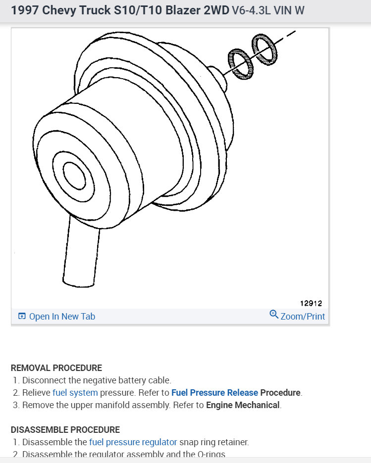

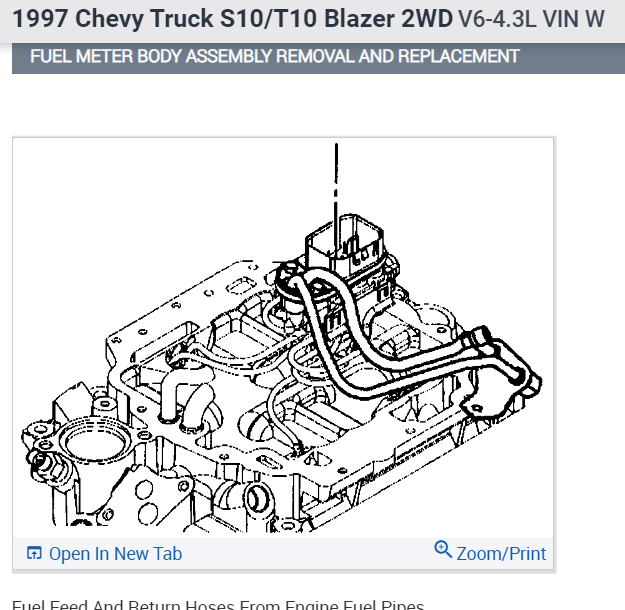

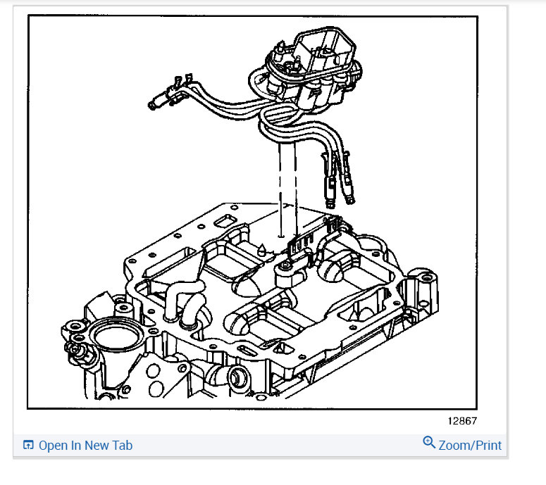

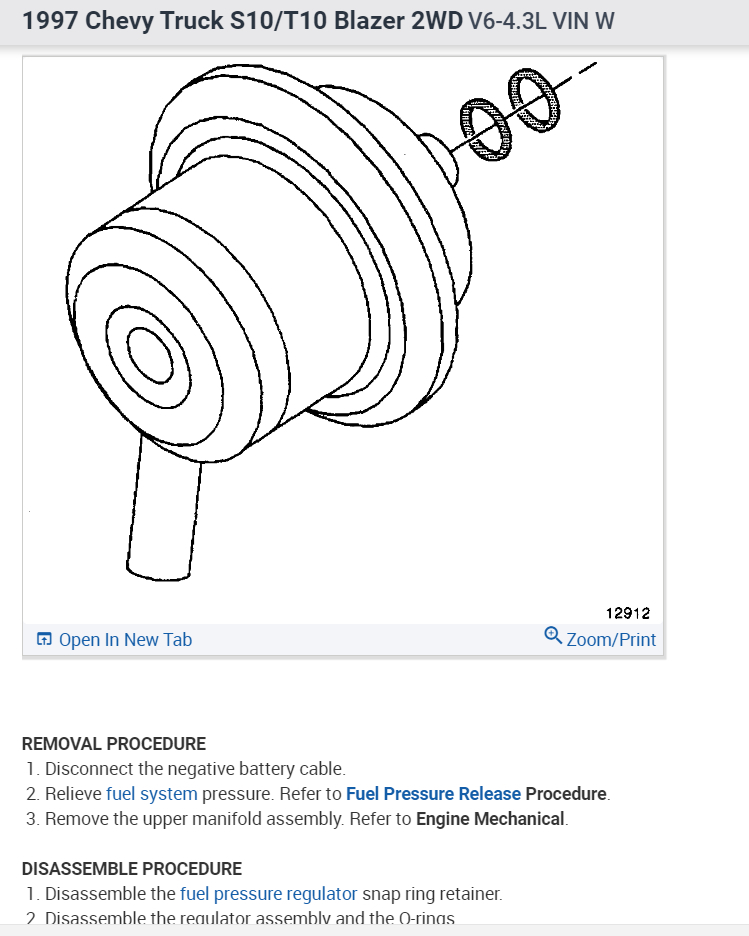

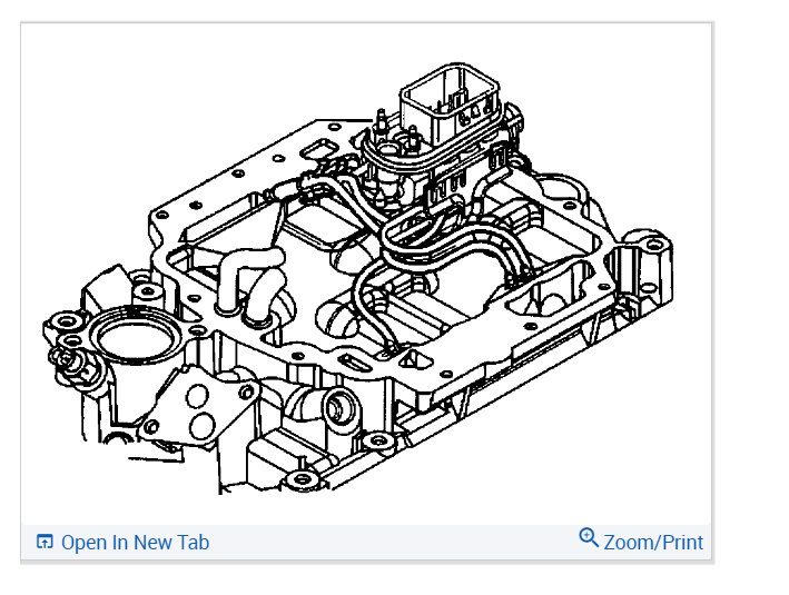

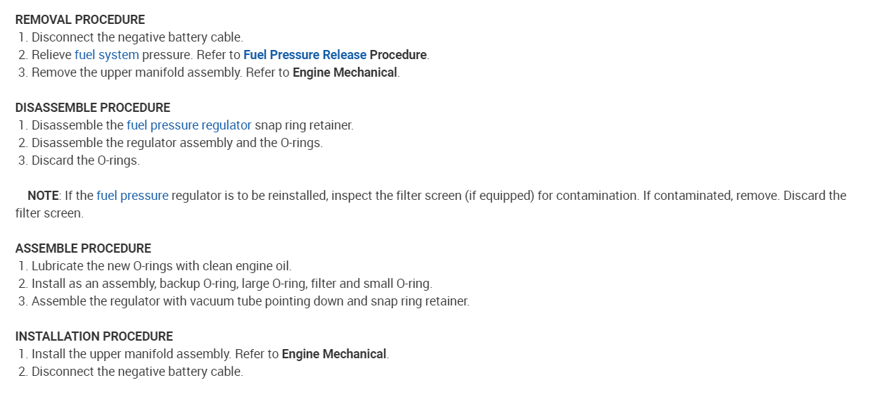

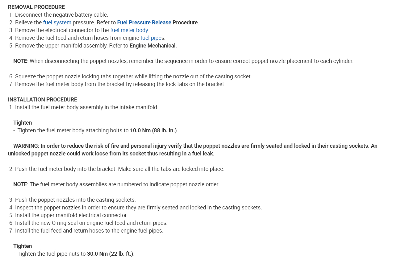

Thanks for the video it helps a lot. These engines had a problem with the fuel pressure regulator inside the intake manifold to leak raw fuel inside the intake. I would get an AC Delco unit; the regulator sits at the rear of the fuel injector (spider). Check out the diagrams (below). Please let us know what happens.
Friday, July 22nd, 2022 AT 5:46 PM
HITTN8SWITCHES
  • 7 POSTS
Okay, replaced the spider today. No change. Thought this might be it as I found the top of #3 injector suspiciously clean. I thought it could be leaking at the injector, so I switched it out. Still goes through the same cycle. Video from today after putting back together. Still no codes.

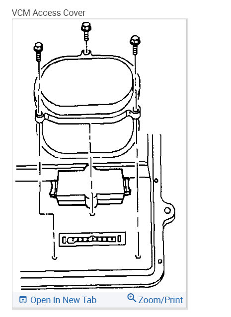

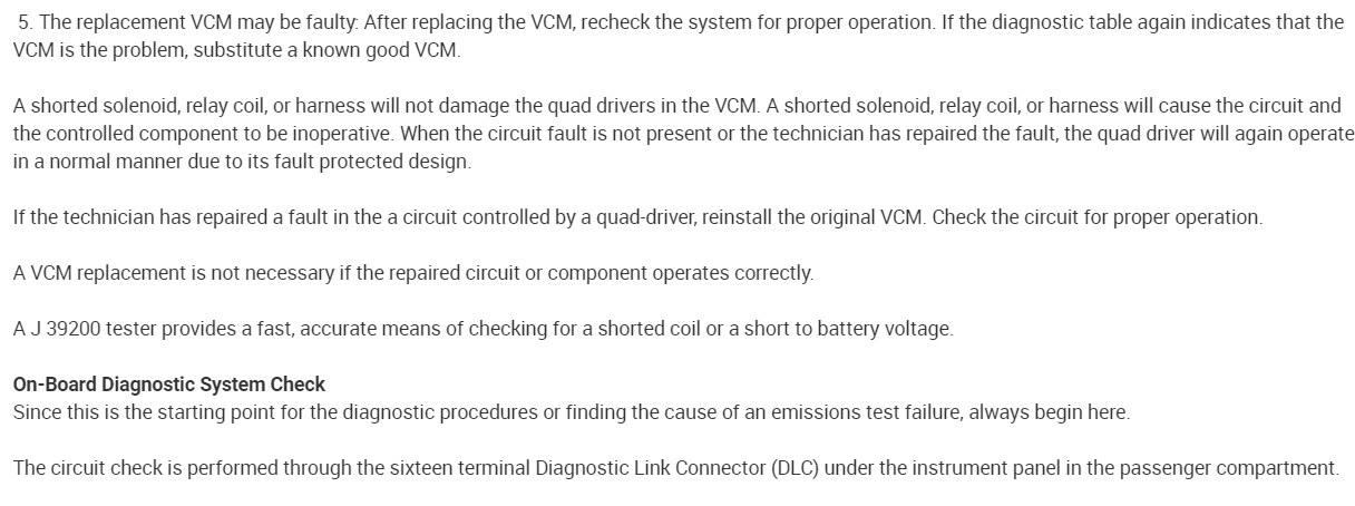

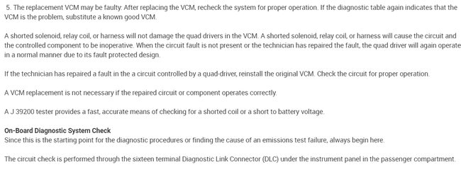

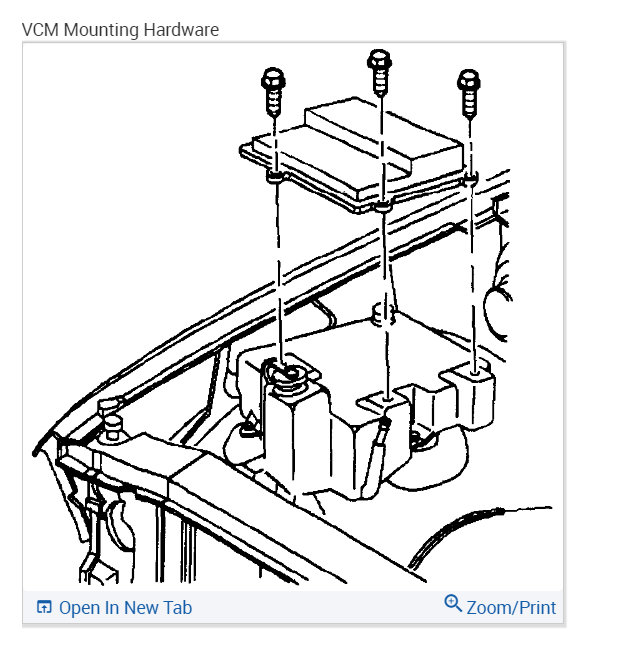

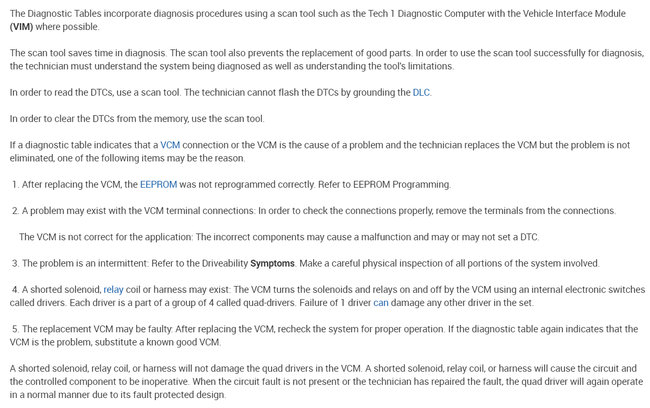

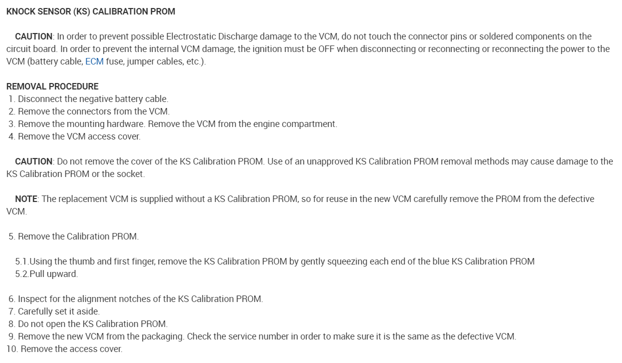

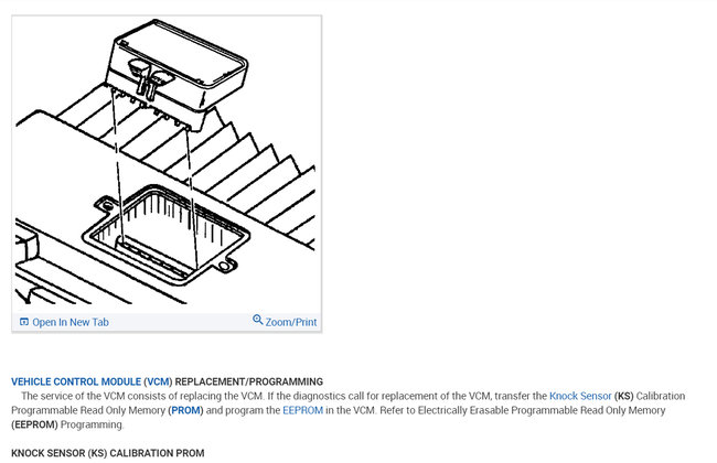

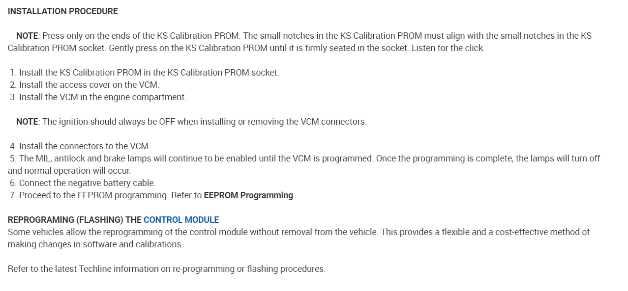

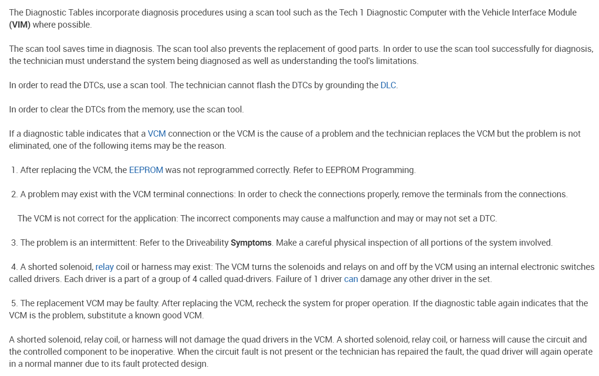

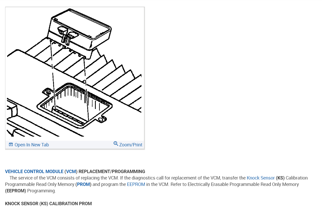

The IAC cycles because the PCM is "hunting". When you drive the truck does it have good power? You might have a bad PCM. Also have you checked for a vacuum leak? This guide can help check when the engine is cold:
Sunday, July 24th, 2022 AT 12:01 PM
HITTN8SWITCHES
  • 7 POSTS
Last time the truck was drivable there was no noticeable loss of power. Vacuum leaks are one of the first things I looked for. Found one on the PCV tube. Haven't found any others. How can I check the PCM?
Sunday, July 24th, 2022 AT 5:16 PM
KEN L
  • MASTER CERTIFIED MECHANIC
  • 55,486 POSTS
A CAN scan maybe able to detect a problem you can get a CAN scanner from Amazon for about $30.00 here is a video to show you how.
https://youtu.be/u-4syLc-ifQ
here is a scanner link
https://amzn.to/3o41KcZ

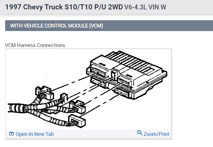

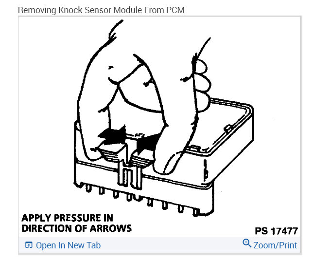

Or you can just swap it out for another unit here are the directions. Check out the diagrams (Below). Please let us know what you find.

Solved, turns out it was the mass airflow sensor.
