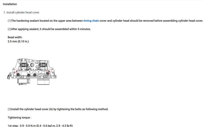

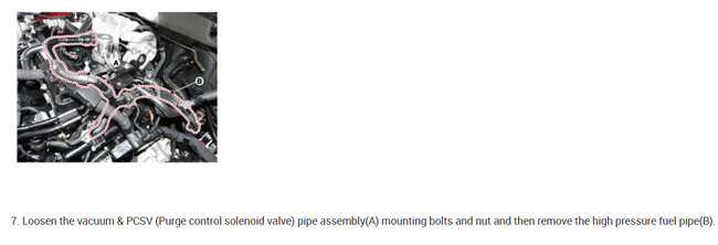

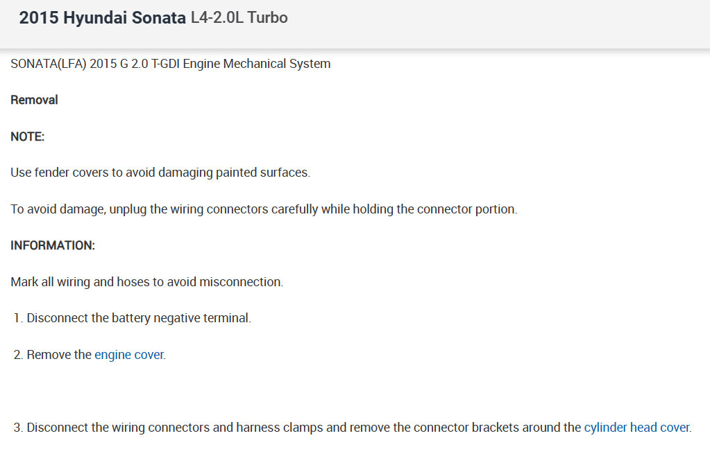

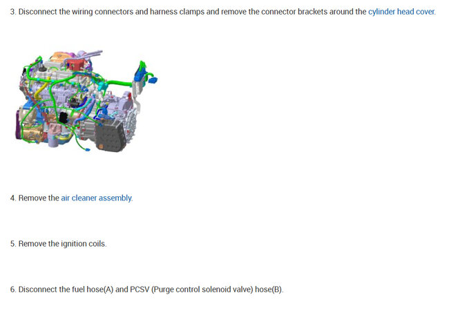

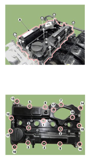

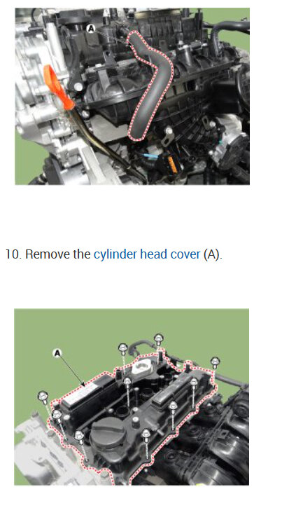

Yep, this will happen when the valve cover gasket starts to leak because oil will drip onto the exhaust manifold which is what you are smelling, or the oil leak is down low like an oil pressure sensor and getting onto the exhaust system that way. The issue is to find the leak which this guide can help you find:
https://www.2carpros.com/articles/engine-is-leaking-oil

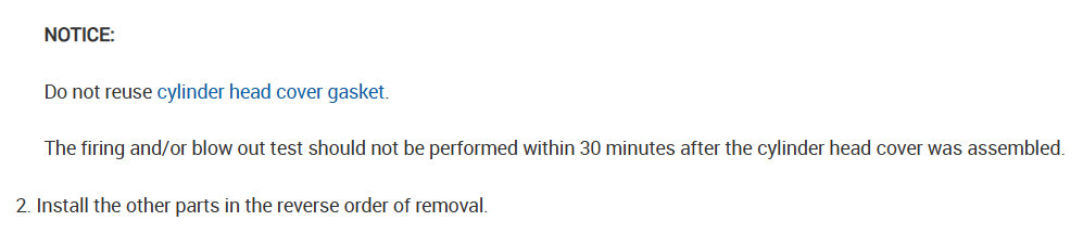

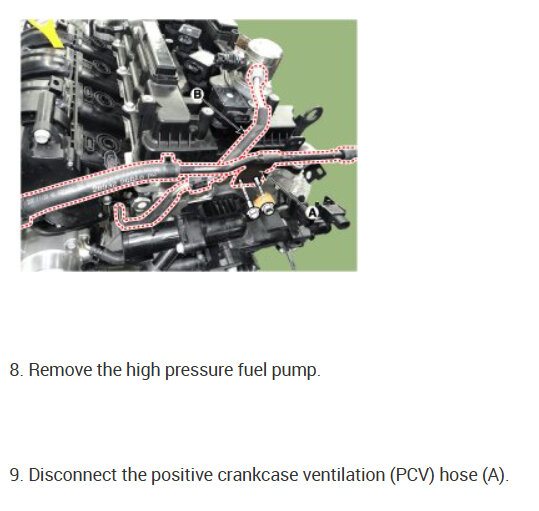

Here is how to change the valve cover gasket out which is probably the problem. Check out the images (below). Please let us know what happens.
