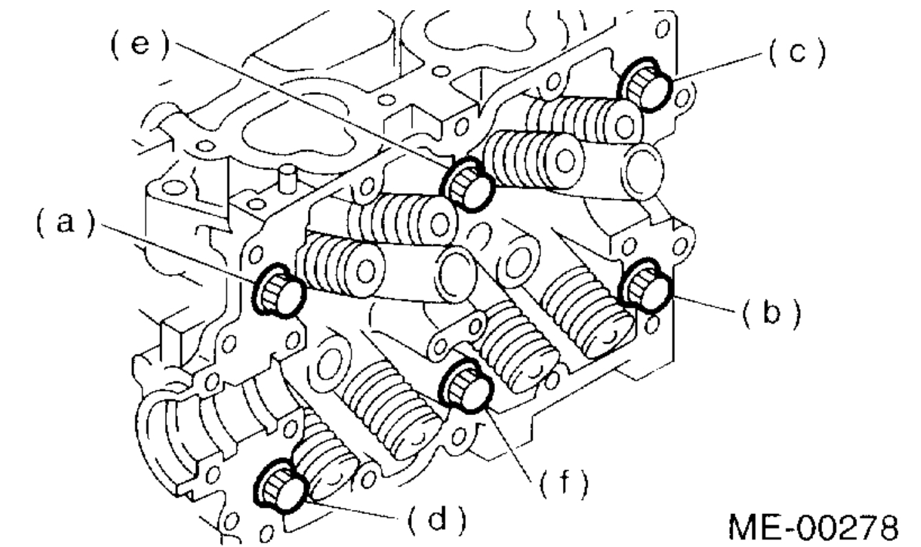

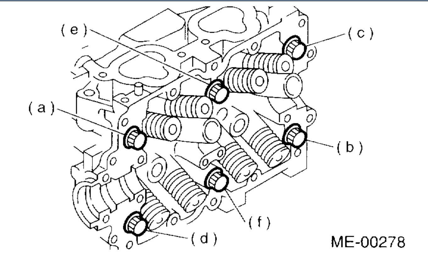

10) Remove the cylinder head bolts in alphabetical sequence shown in the figure.
NOTE: Leave bolts (a) and (c) engaged by three or four threads to prevent cylinder head from falling.

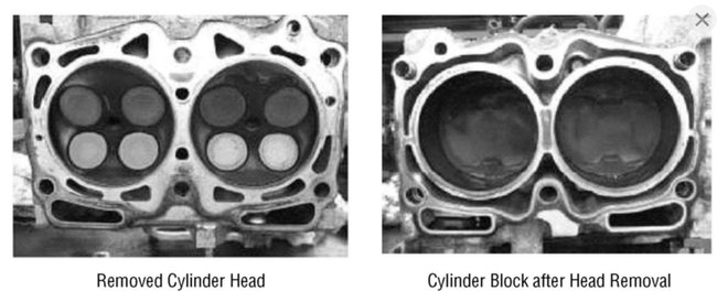

11) While tapping the cylinder head with a plastic hammer, separate it from cylinder block.
12) Remove bolts (a) and (c) to remove cylinder head.

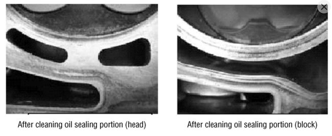

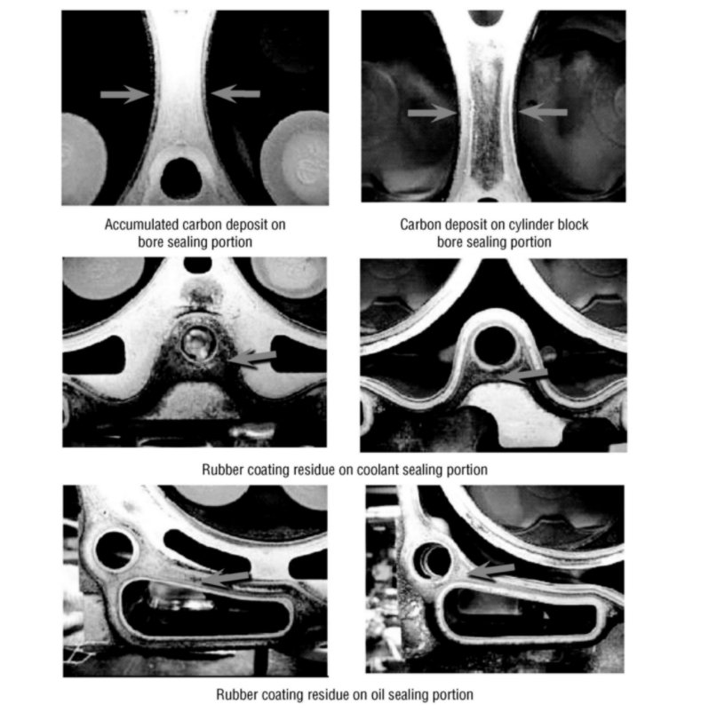

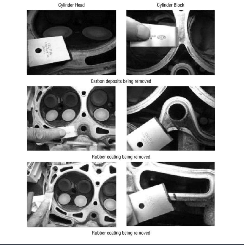

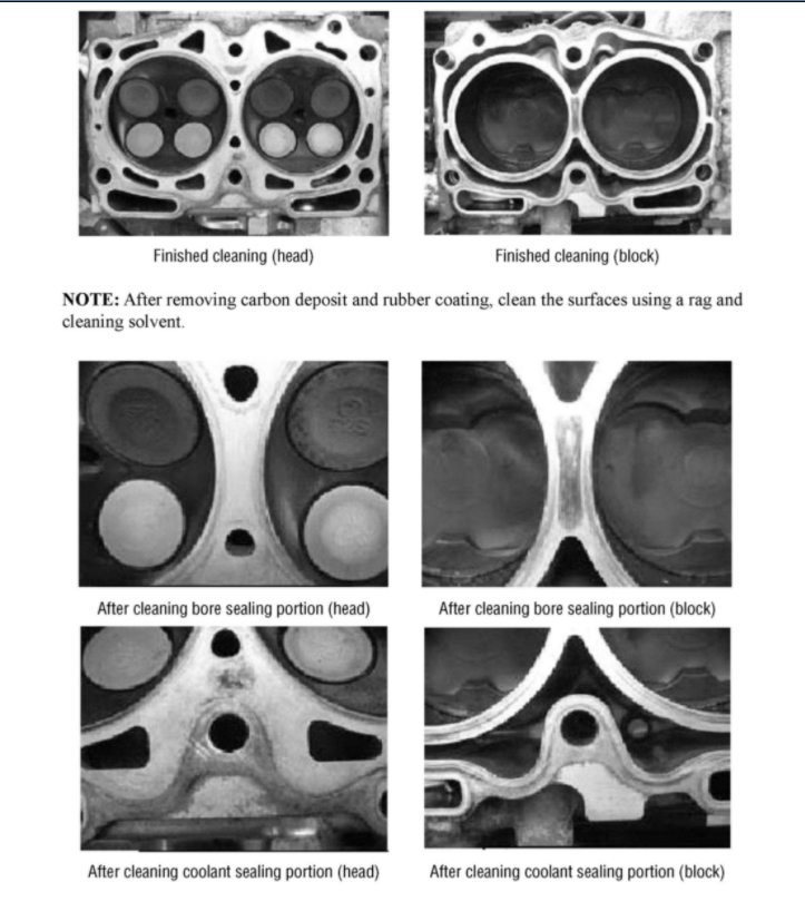

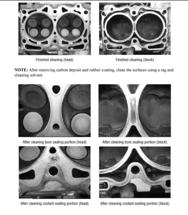

13) Remove the cylinder head gasket.
CAUTION: Do not scratch the mating surface of cylinder head and cylinder block.
14) Similarly, remove the right side cylinder head.

1) Install the cylinder head and gaskets on cylinder block.
CAUTION:
Use new cylinder head gaskets.
Be careful not to scratch the mating surface of cylinder block and cylinder head.
2) Tighten the cylinder head bolts.
a) Apply a coat of engine oil to the washers and bolt threads.
b) Tighten all bolts to 29 Nm (3.0 kgf-m, 22 ft-lb) in alphabetical sequence.
Then tighten all bolts to 69 Nm (7.0 kgf-m, 51 ft-lb) in alphabetical sequence.
c) Back off all bolts in reverse order of assembly by 180° first; back them off by 180° again.
d) Tighten the bolts (a) and (b) to 34 Nm (3.5 kgf-m, 25 ft-lb).
e) Tighten bolts (c), (d), (e) and (f) to 15 Nm (1.5 kgf-m, 11 ft-lb).
f) Tighten all bolts by 80 to 90° in alphabetical sequence.
CAUTION: Do not tighten bolts more than 90°.
g) Further tighten all bolts by 80 to 90° in alphabetical sequence shown in figure below.
CAUTION: Ensure that the total "re-tightening angle" [in the former two steps], do not exceed 180°.
