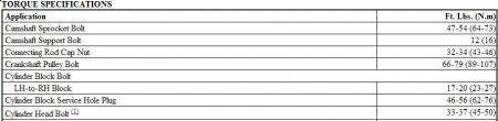

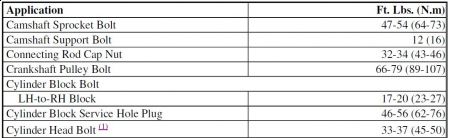

what are the torque specs for replacing a head gasket on a 1990 Subaru Legacy?

MERLIN2021
MECHANIC
17,250 POSTS
Thursday, November 19th, 2009 AT 3:13 PM
