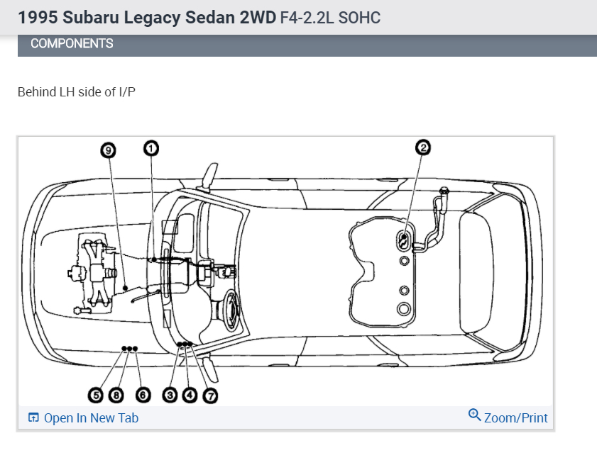

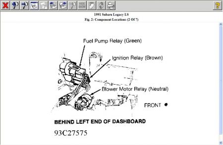

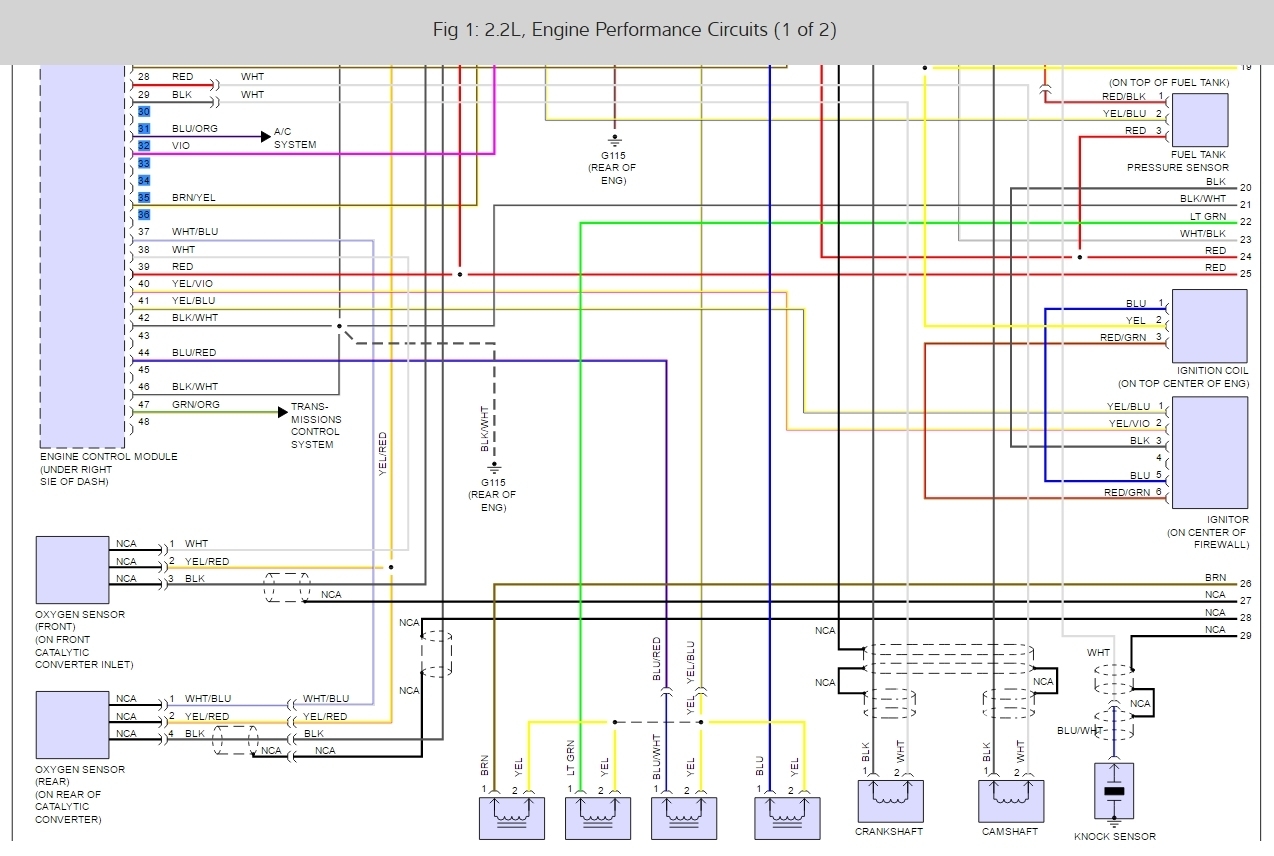

Where is the fuel pump relay switch on a 98 subaru legacy?
Monday, January 18th, 2010 AT 6:26 PM
20 Replies
KEN L
  • MASTER CERTIFIED MECHANIC
  • 55,499 POSTS
Hey Nick,

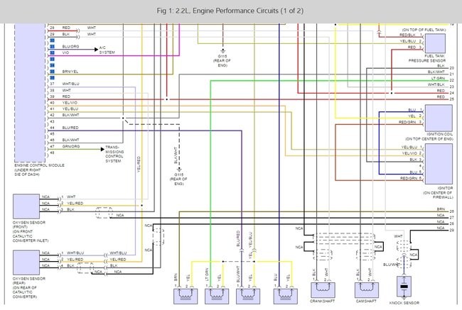

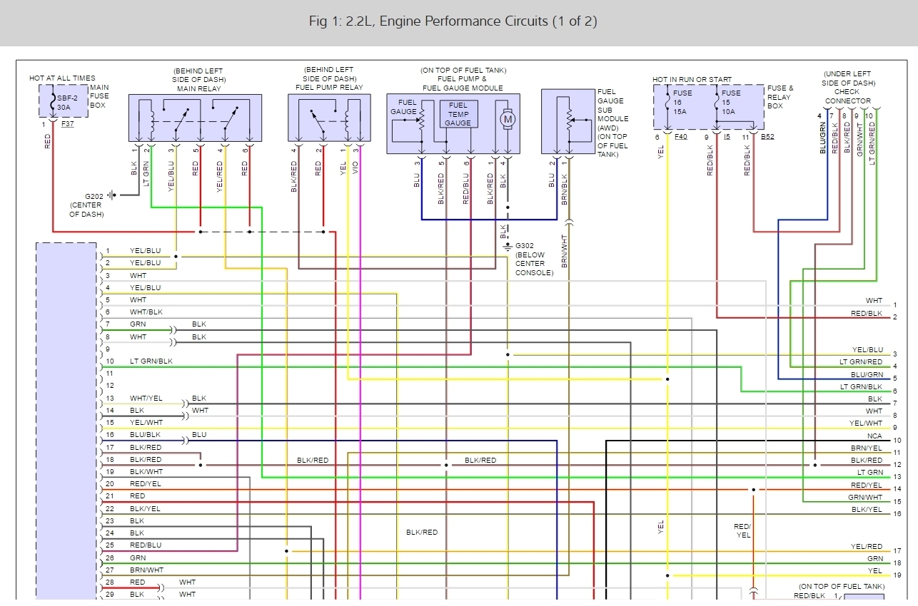

I did some digging around and found this wiring diagram for you that tells its behind the left side of the dash, check the wiring colors to make sure you get the right one. Check out the diagrams (Below). Please let us know what happens.

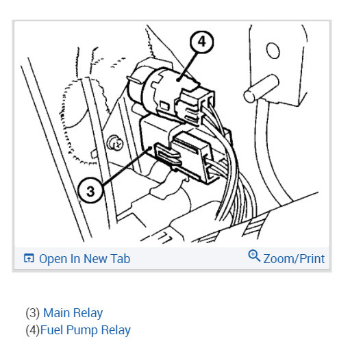

Does anyone have a diagram of where the fuel filter relay is located as it is not listed and I don't have the owners maual? I have a 1995 AWD subaru legacy LS with a 2.2 liter 4 cyl.
Thursday, August 27th, 2020 AT 11:25 AM (Merged)
MERLIN2021
  • 17,250 POSTS
Here is a guide to help you test the relay with the location of the fuel pump relay below.

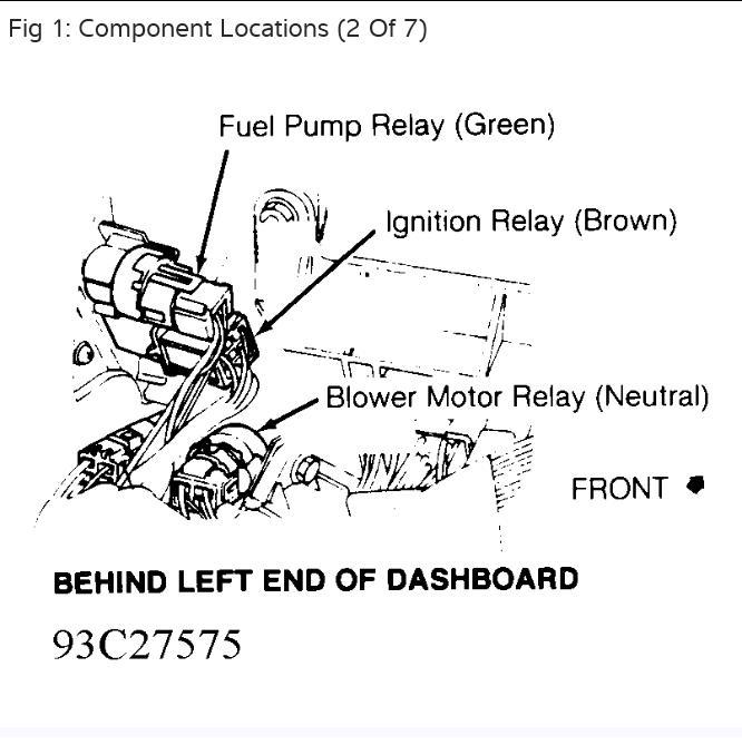

I am so close to the fuel pump relay I can smell it but cant see it ! I'm under the dash at the drivers side and I cant locate this relay. I have a 92 Subaru legacy. I was wondering if three's something else that I have to take off to see it. I have the bottom panel off but when I look at other diagrams on the net, it shows me that they have all but all the top dash off. Is there a diagram that you can send to my email so that I can get a better idea what to do to replace this relay.
Thursday, August 27th, 2020 AT 11:26 AM (Merged)
KHLOW2008
  • 41,814 POSTS
It is the Green colored socket.
SPEEDY2U
I took the bottom panel off the dash but still cant see it. Is there something else that I have to take off to get to it because I don't see it. THANKS !
KHLOW2008
  • 41,814 POSTS
You should be able to see the relays after taking off the panel, near the kick panel.
SPEEDY2U
Well. All I see are plugs and nothing that resembles a round relay. In really stomped here. If its there, it must be way up in and I have no idea how to get to it ! ( BIG SIGH )
KHLOW2008
  • 41,814 POSTS
You need to get under the dash and look upwards.
+1
SPEEDY2U
It is so far up in the dash that you want even touch it. There's a access panel in the lower part of the dash that I can see it but there is no way you can touch it. The only way I see how to even get to it is to loosen and pull the dash up so it can be accesed from the top end. Please correct Mr if in wrong. Its in a 92 subaru legacy special edition. THANKS
KHLOW2008
  • 41,814 POSTS
If you need to pull the dash to reach it, then it should be so but so far I have never come across any vehicle that requires pulling the dash to access the relays. Removing the lower dash panle might help in gaining access.

ADARKPHOENIX
  • 1991 SUBARU LEGACY
  • 4 CYL
  • 4WD
  • 210,000 MILES

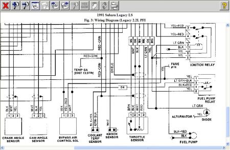

I changed everything the fuel filter the pump and the strainer but my car still wont turn over I was told that it might be the relay but I can't find the darn thing I need help bad can't afford to hire anybody to help it turns but wont turn over the pump no make a gurge sound near the tank but I don't know what to do anymore I only took auto for 1 semseter thanks to all that read and help
Thursday, August 27th, 2020 AT 11:30 AM (Merged)
  • 75,992 POSTS
Test fuse no.16, ignition relay and fuel pump relay
Relay location see below
https://www.2carpros.com/forum/automotive_pictures/12900_fuel_pump_relay2_2.jpg
https://www.2carpros.com/forum/automotive_pictures/12900_fuel_pump_relay_11.jpg
