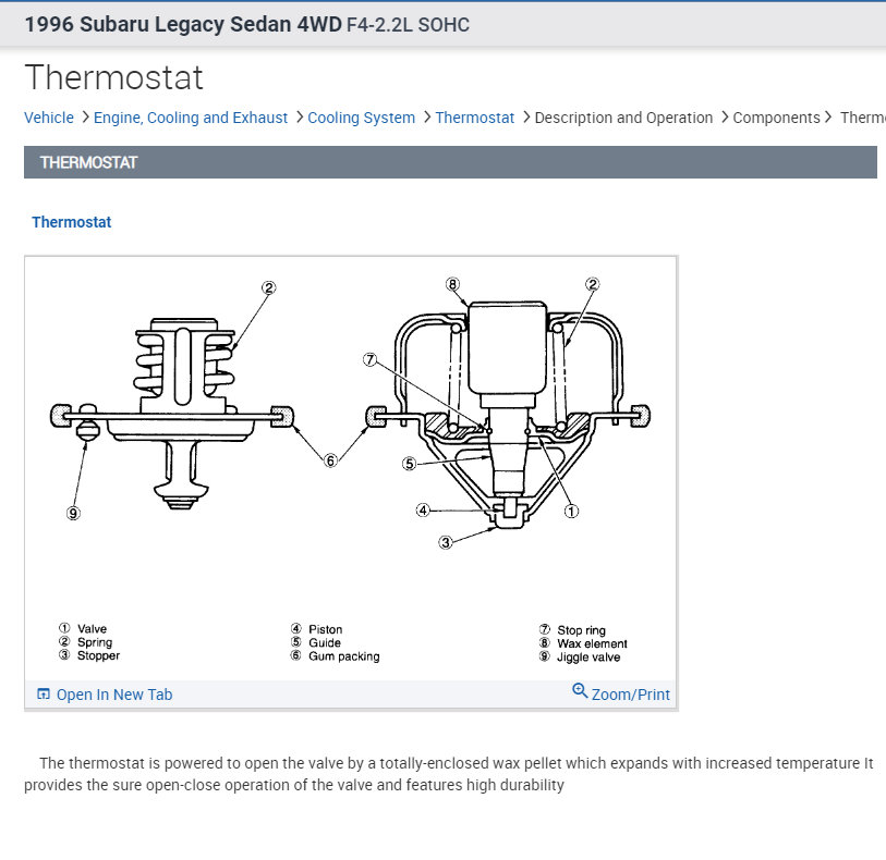

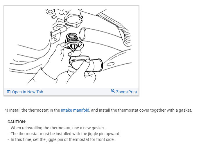

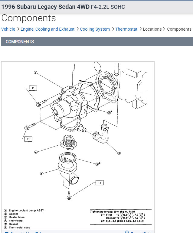

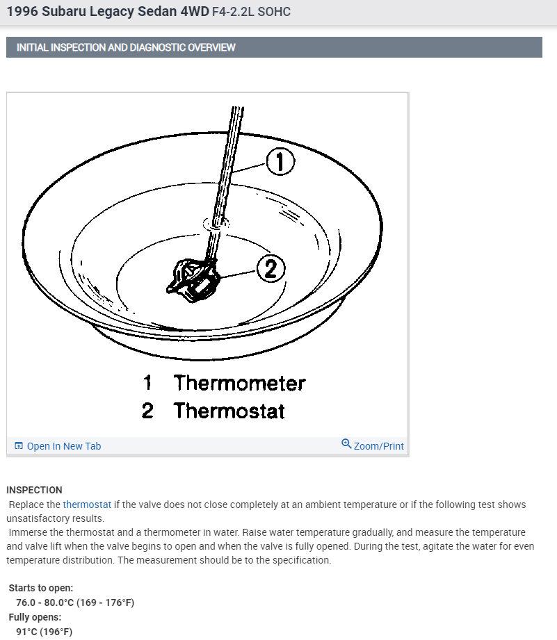

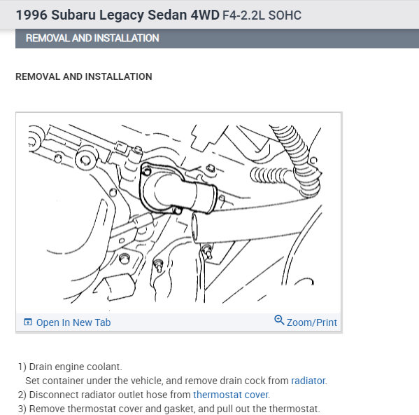

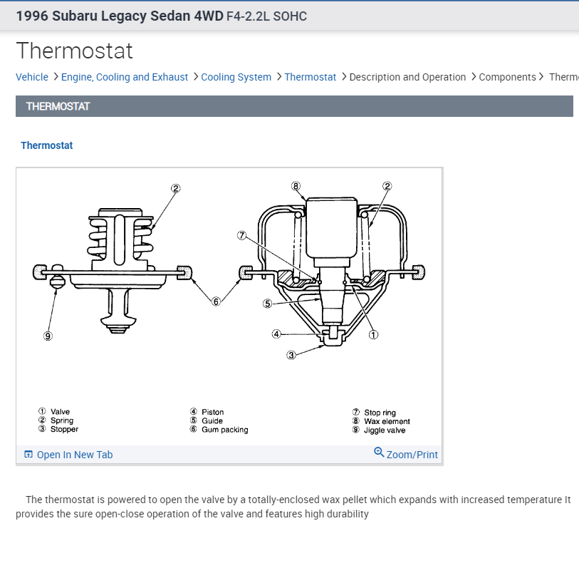

If the engine still overheats with the coolant being full, it could be due to a stuck closed thermostat among other things like the radiator or the water pump.
