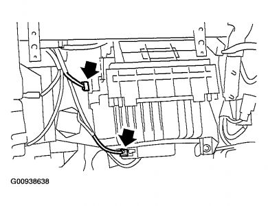

When the heater/ac fan is on there is a significant rattling, vibration. Doesn't affect the RPMs. On high fan setting the noise is loud, almost sounds like something is caught in the fan. How can I check out the fan assembly?

Fan removal as per Mitchell 1.
https://www.2carpros.com/forum/automotive_pictures/61395_Capture_20.jpg
https://www.2carpros.com/forum/automotive_pictures/61395_sub_1.jpg
https://www.2carpros.com/forum/automotive_pictures/61395_sub1_1.jpg
https://www.2carpros.com/forum/automotive_pictures/61395_Graphic_148.jpg
