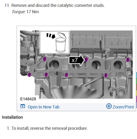

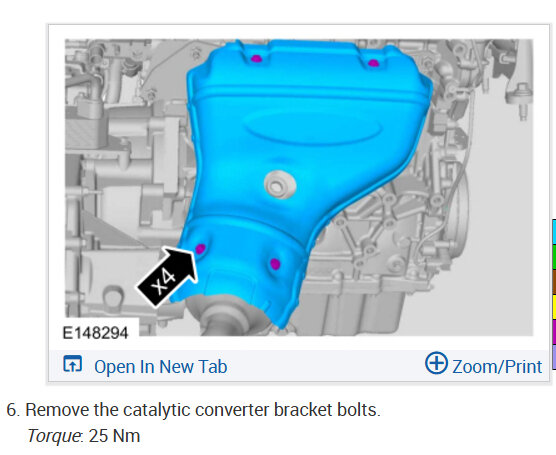

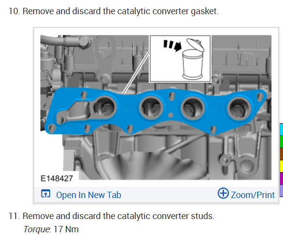

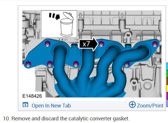

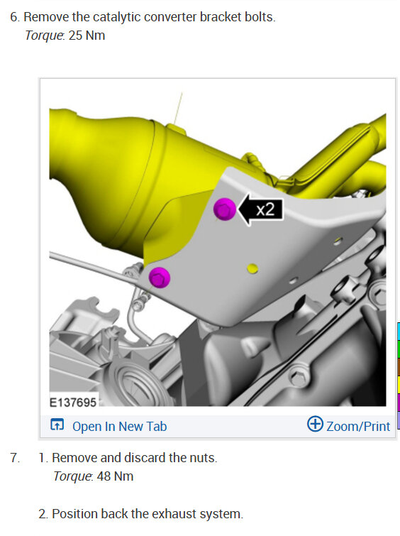

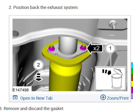

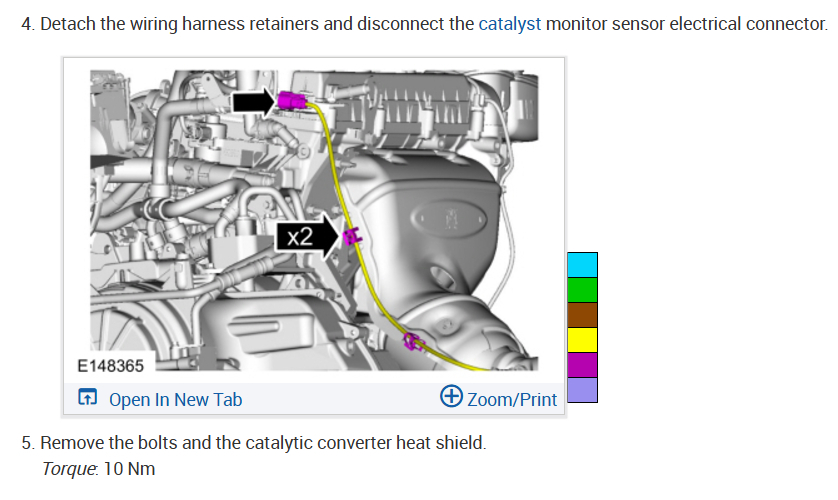

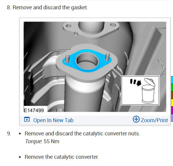

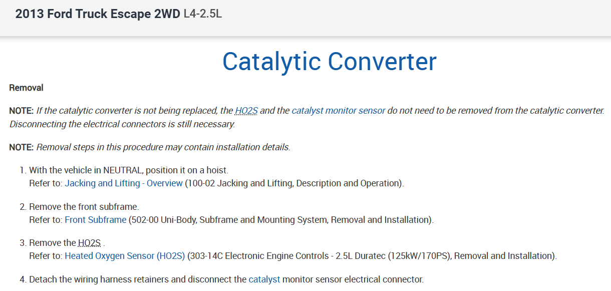

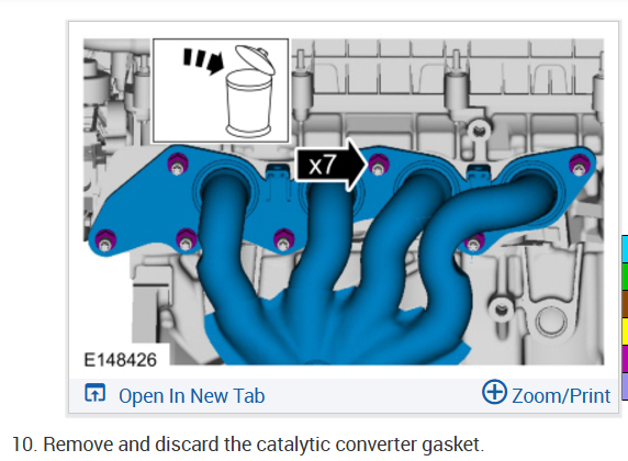

It sounds like the catalytic converter is clogged up, if you check the LTFT values (e.g., +15% or more) could suggest the engine is compensating for the restricted airflow by adding more fuel.
Here is a guide to help you see if the cat is the problem:
You may need to remove the cat for a physical inspection. This can also be because of a lack of fuel pressure. also, I have seen the fuel pressure sensor cause this problem but usually there is a code for it. If when you rev up the engine and it starts to stumble, spray starting fluid into the intake to see if the engine changes. This can help determine if the problem is fuel or not.

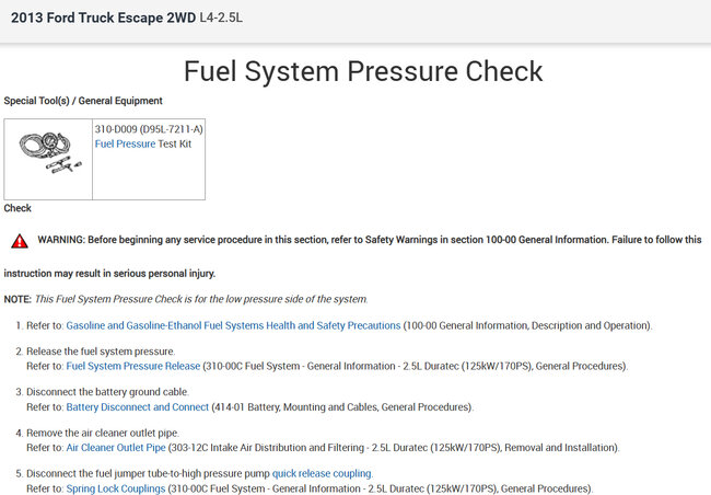

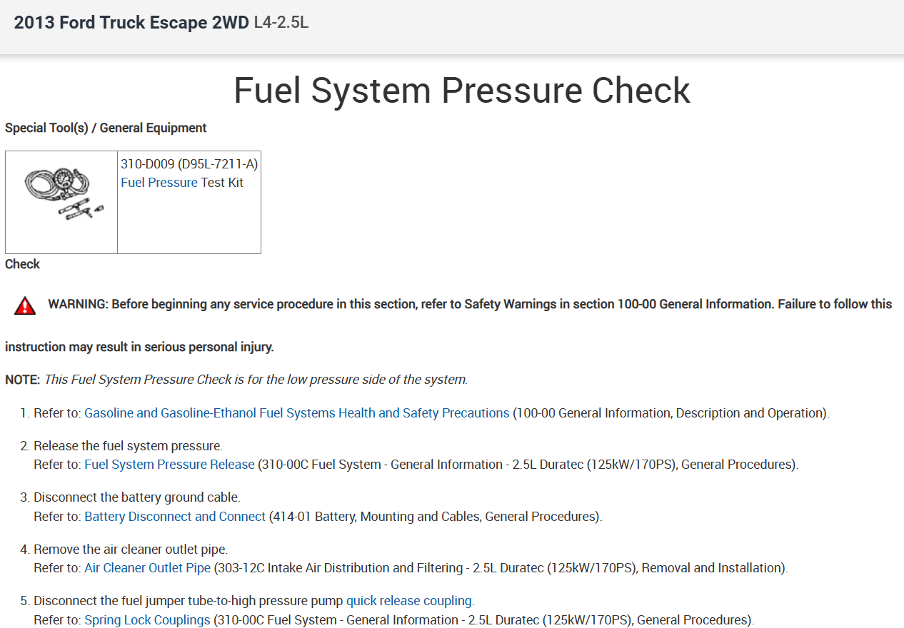

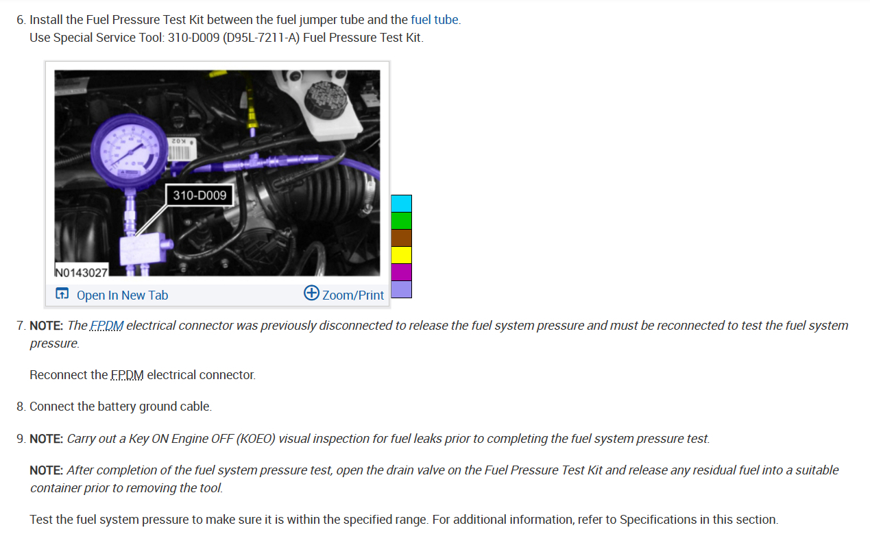

Here is a guide to help check the fuel pump as well:
Fuel Pressure
Engine running - 2.5L 350–415 kPa
Key ON Engine OFF (KOEO) 350–415 kPa
Here are the instructions for your car. Check out the images (below). Please upload pictures or videos in your response of any problems so we can see what to help you with. You can rent a fuel pressure gauge at the auto parts store for cheap or free.
