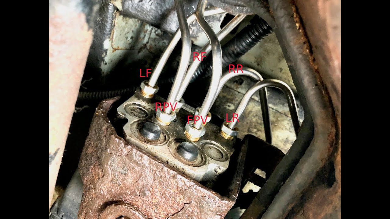

Do you have the ABS modulator valve lines positions diagram?
The image attached is the way I took the lines off.
RPV = Rear port on Proportioning Valve
FPV = Front port on proportioning valve
I had to order a used one because one of the threads stripped, the module has 2 cracks in it and someone welded the bracket to the frame.
If I get a Foxwell NT680 pro that can reprogram the module, will a module from a Yukon work on an Escalade?
Thanks,
Blake
Wednesday, March 31st, 2021 AT 3:51 PM
  • 110,194 POSTS
As far as reprogramming it, it has to have the same part number. Make sure of that. If it is the same, you should be able to do it.
As far as the piping schematic, they don't show that in the manual. It looks like you have them mapped out in your pic. Is something different?
Wednesday, March 31st, 2021 AT 5:46 PM

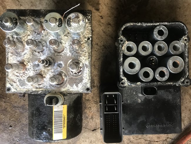

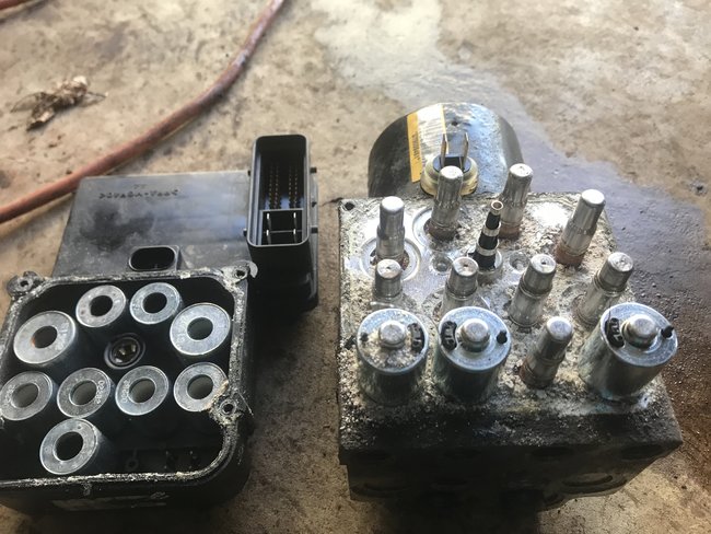

Just for grins, I took the old module off the pump and I don't think this thing has worked in years. The owner says he felt it work last winter.
I sure hope the used one I ordered doesn't look like this inside.
Thursday, April 1st, 2021 AT 1:58 PM
  • 110,194 POSTS
Wow! There is a lot of corrosion. I agree, it doesn't look like it has worked for some time. As far as ABS, I guess it's because of my age, but I like having control if I start to slide or skid. When the ABS actuates, it doesn't matter how hard you press the brake, it doesn't change.
