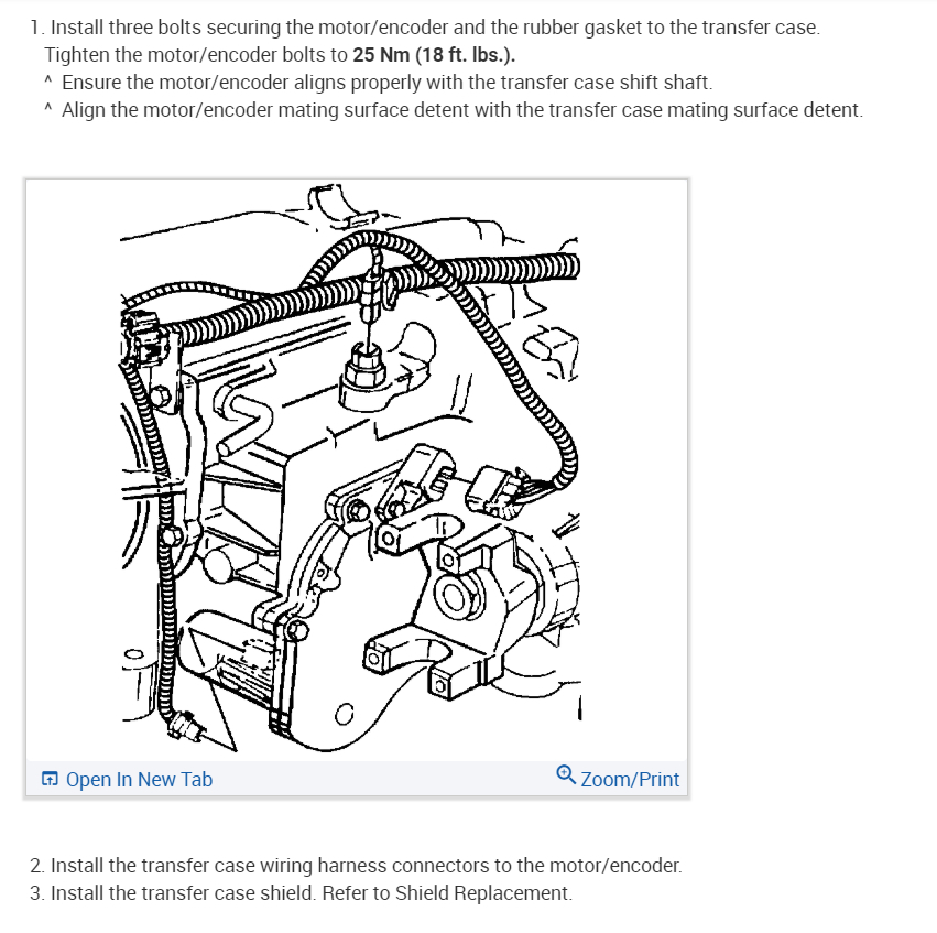

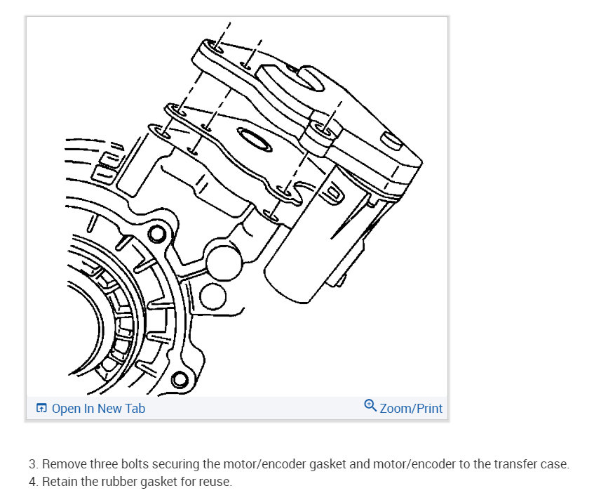

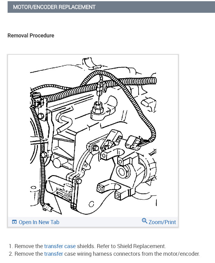

Scan for codes first and check fuses either can cause it then check encoder motor to see if it is working and getting power. That is a high failure rate item. Here is how you can change it out in the diagrams below.
