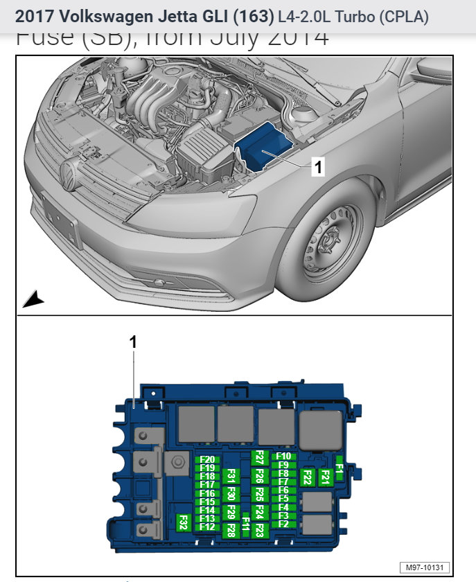

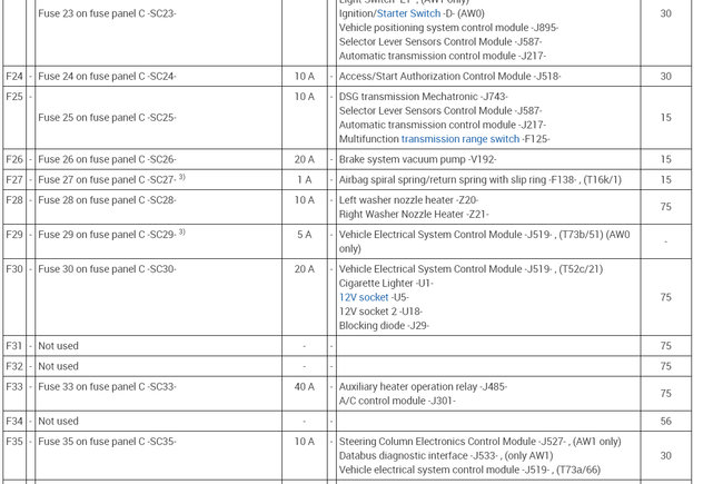

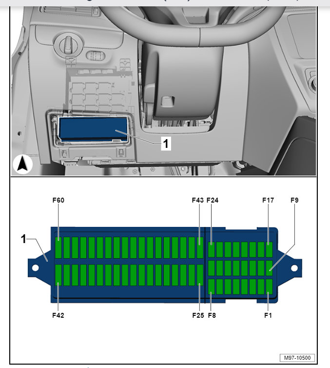

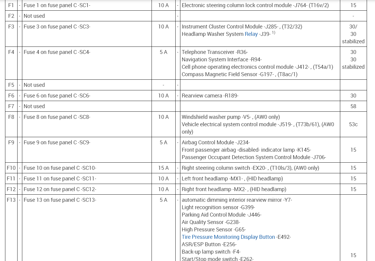

The head unit in my Jetta has suddenly stopped connecting to my iPhone, it just gives a constant connection fails error. In addition whenever I start my car the radio is basically reset, it doesn't remember any saved stations and it starts at the car play screen regardless of where it was when I turned the car off. I have to assume the two issues are related and my theory is that it is probably a fuse, but i'm not sure which fuse it might be. the manual doesn't have a fuse guide. I'm hoping someone can point me in the right direction.
Thanks
May 20, 2019 at 12:37 PM
  • 54,487 POSTS

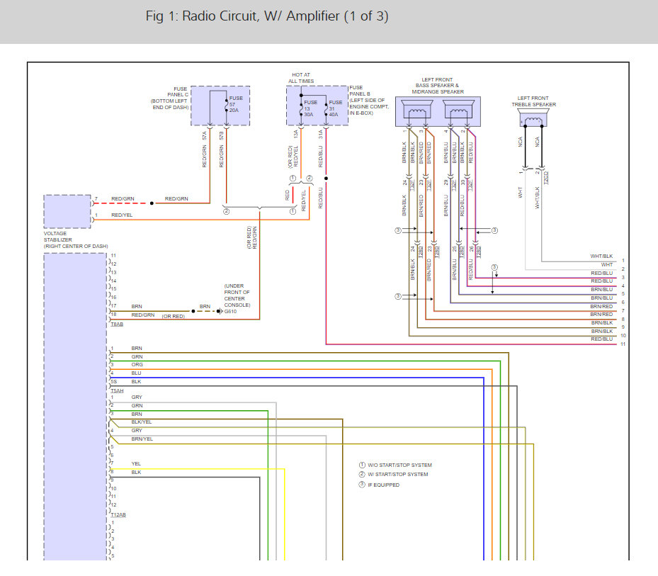

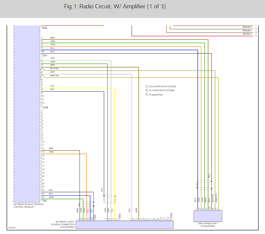

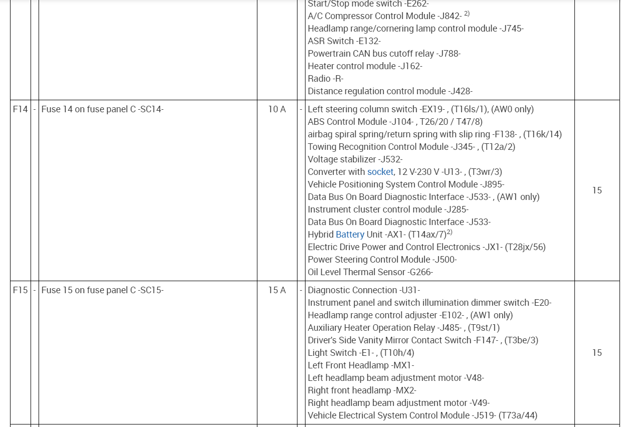

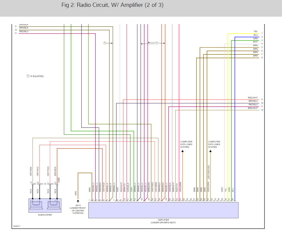

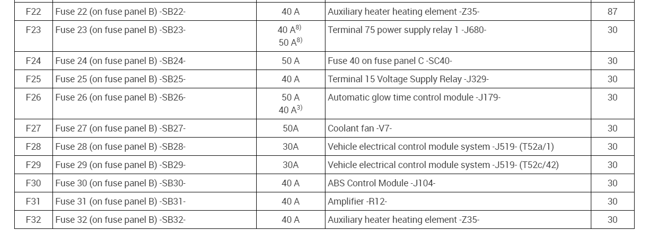

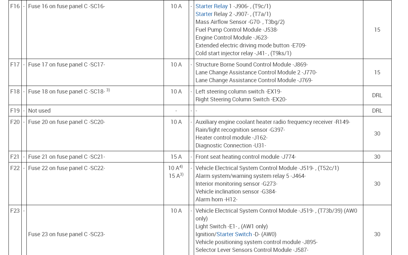

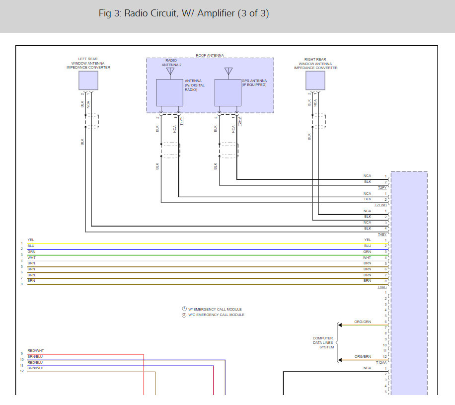

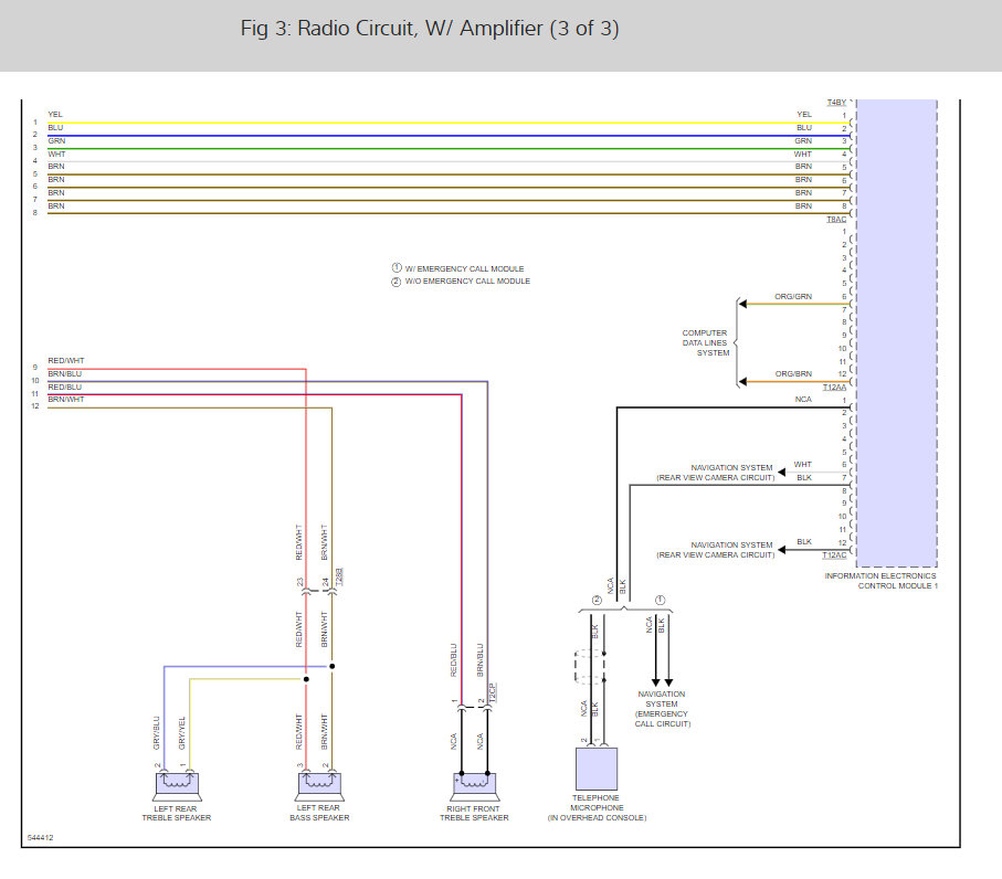

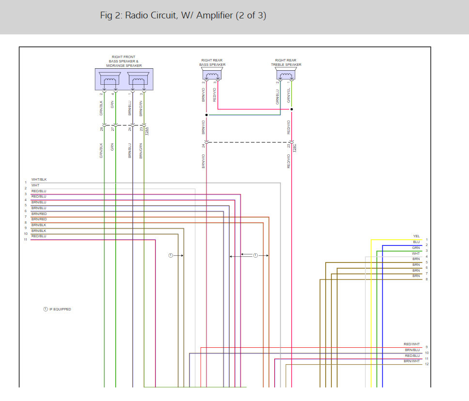

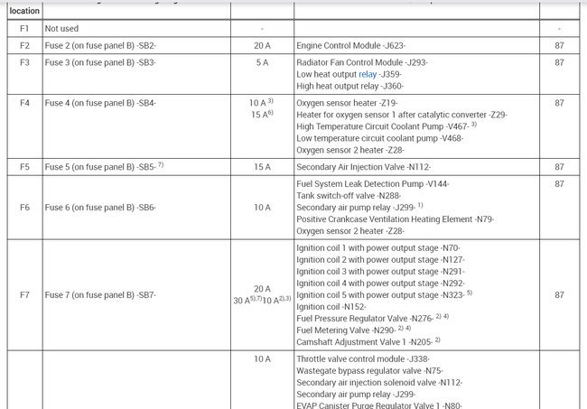

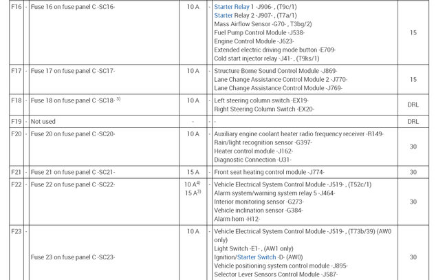

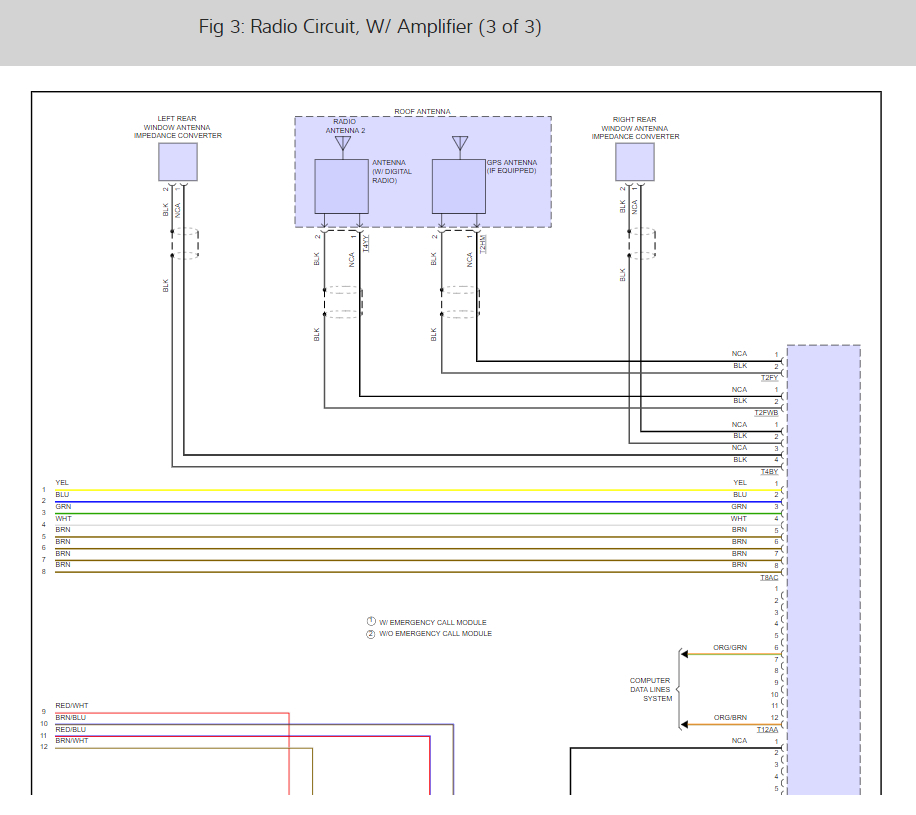

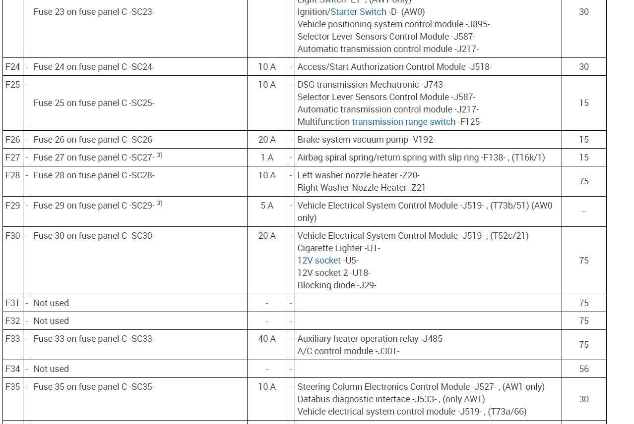

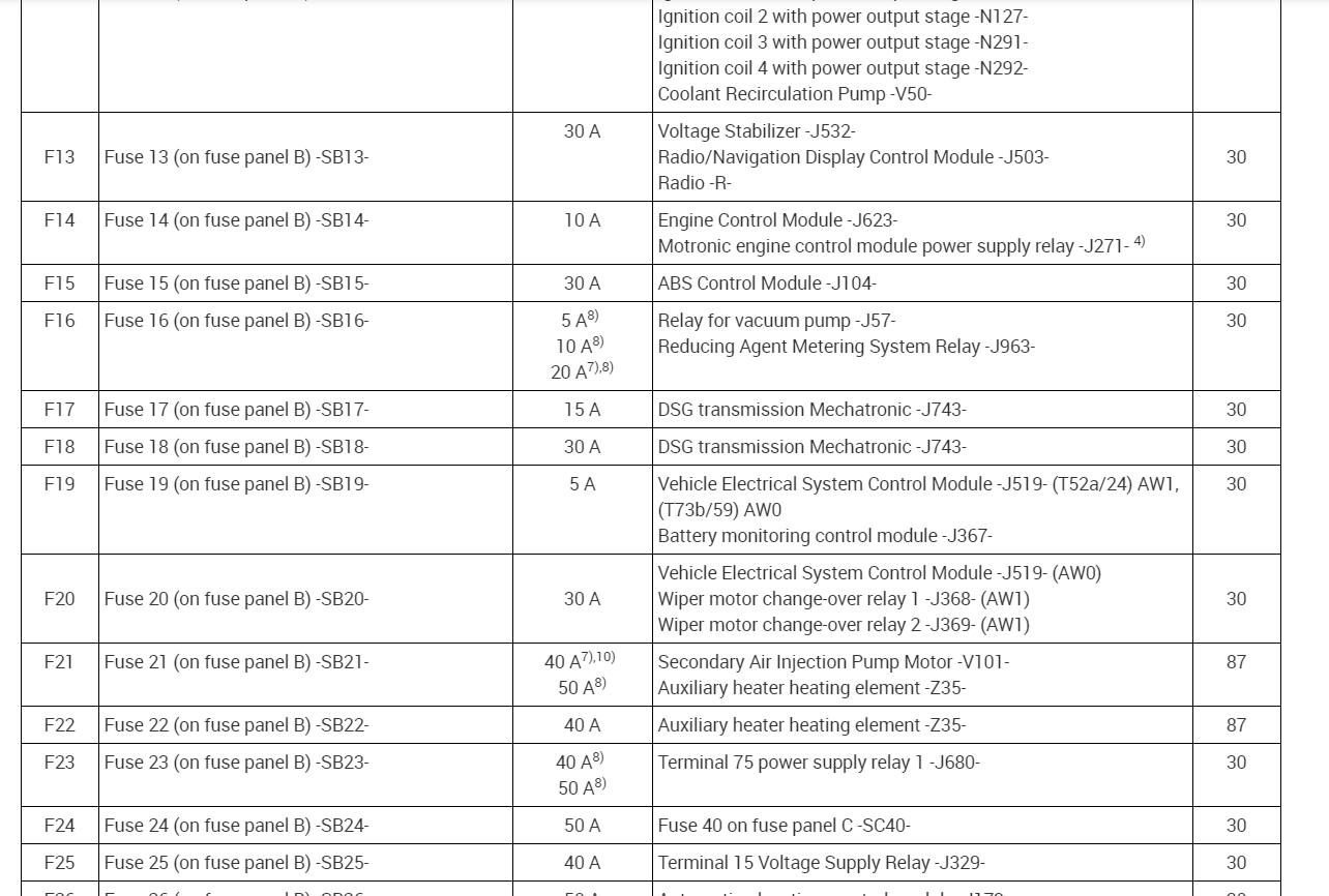

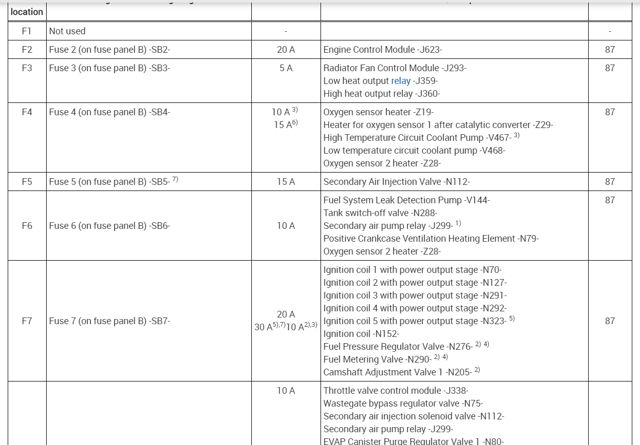

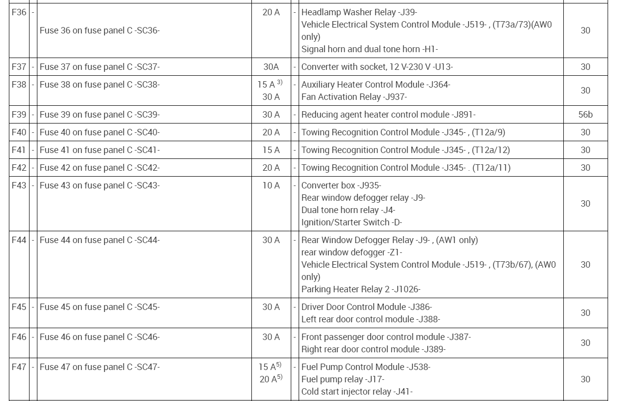

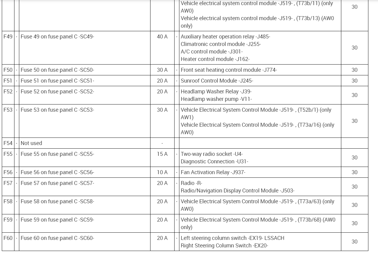

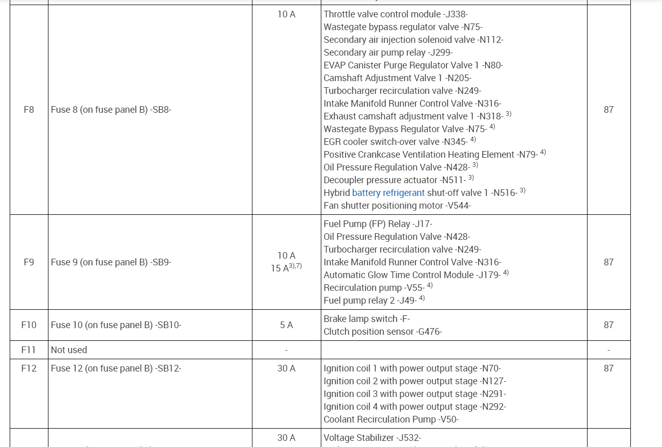

It sounds like one of the fuses blew (13, 31 or 51). However, to be sure here is a guide to help us test the fuses and the fuse location with the radio wiring diagrams so you can see how the system works:

the guide you provided didn’t match my car exactly. the layout is the same but my car doesn’t have all the fuses listed. I’m not sure if it matters but I have a Jetta SE. In the engine box 13,31, were missing. In the cabin 13 was missing but 31 and 51 was present and unblown.
