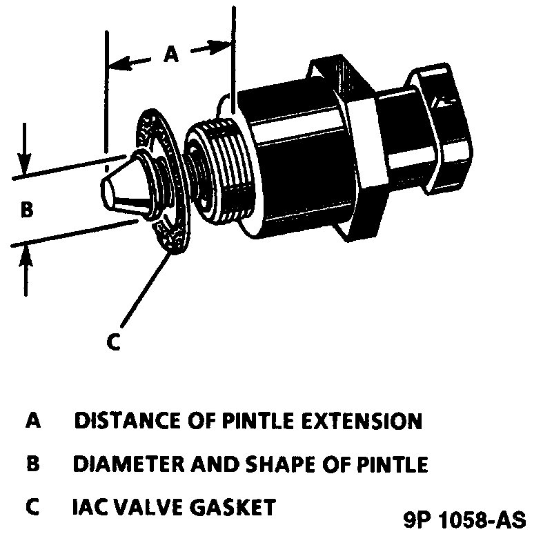

It is a 1994 Chevrolet Alero APV Auto. When I stop or just sit in the yard now let off the gas I will shut off but It will be right back up. What could be the issue with that? Could have been idler physician air flow thing.

This could be a couple things. Most commonly, the idle air control valve (IAC) is carboned or bad. The IAC is responsible for maintaining the engine idle speed. If it fails, the engine will stall when you take your foot off the gas.
Also, an engine vacuum leak can cause this type of problem. Here is a quick link that shows how to locate a leak:

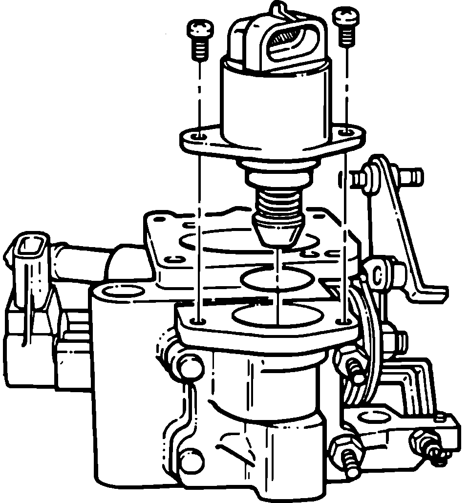

What I suggest is to first remove the IAC and inspect it for dirt or debris. Also, where the pintle enters the throttle body, make sure there is no carbon or debris there as well.
Here is a link that shows an IAC being replaced. It may help you with locations and procedures. Basically, it should help give you a good understanding of what will be done.
https://www.2carpros.com/articles/how-to-replace-an-idle-speed-control-motor-iac
Here are directions for replacement specific to your vehicle. The two attached pictures correlate with these directions.

1. Disconnect the idle air control (IAC) valve electrical connector.
2. Remove the IAC valve attaching screws.
3. Remove the IAC valve assembly.

NOTE: If installing a new IAC valve, be sure to replace with an identical part. IAC valve pintle shape and diameter are designed for specific application.
Idle Air Control Valve
INSTALLATION:
1. If installing a new IAC valve, measure the distance between the tip of the pintle and the mounting flange.
If greater than 28 mm, use finger pressure to slowly retract the pintle. The force required to retract the pintle of a new valve will not cause damage to the valve.

3. Install the IAC valve assembly.
4. Install the IAC valve attaching screws, and tighten to 3.0 Nm (27 in lb).
5. Connect the IAC valve electrical connector.
