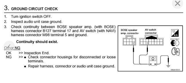

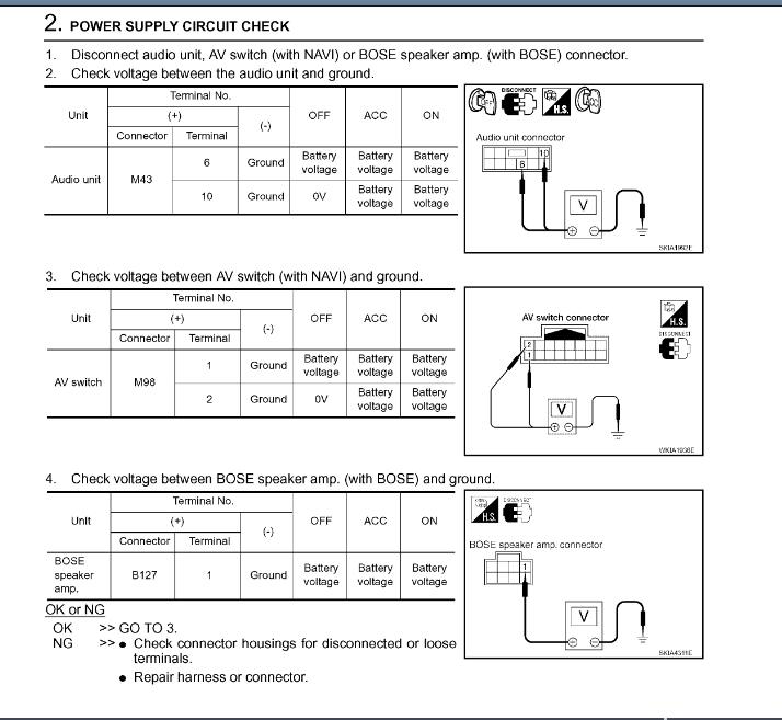

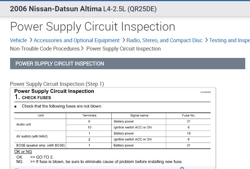

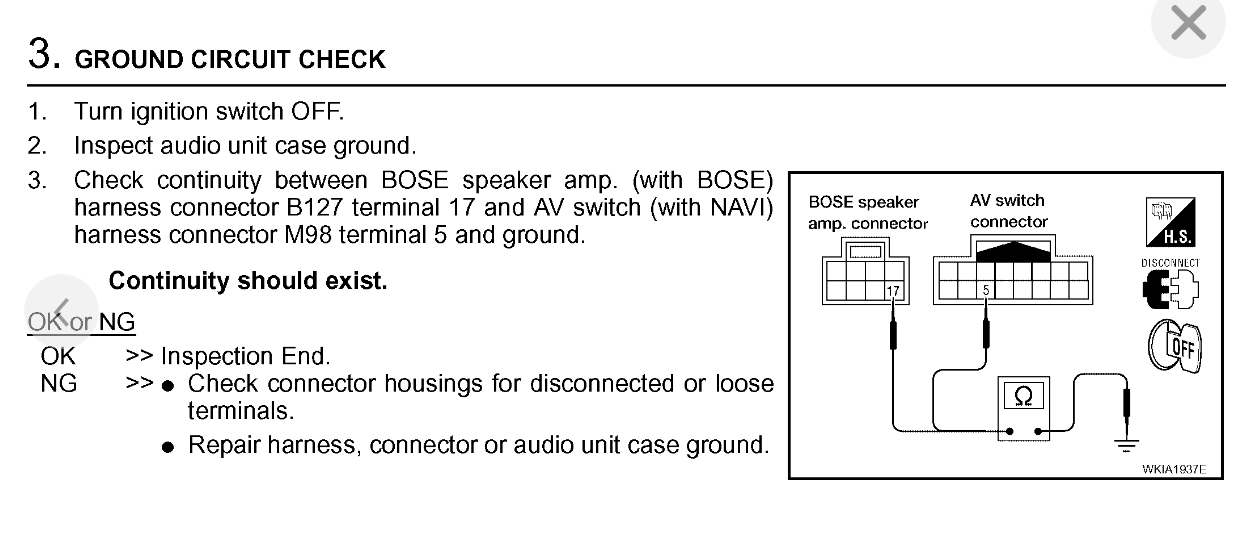

In the diagrams down below I have included the diagnostic troubleshooting guide for your vehicle for a "no power to stereo" condition. It will require you to use a Digital MultiMeter[DMM] to do these tests, so here is a link below on how to use one, if you are unfamiliar with how to use one:
Please go through this guide and get back to us with what you are able to find out.
