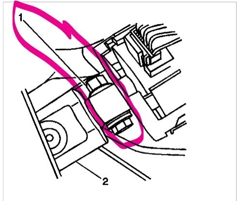

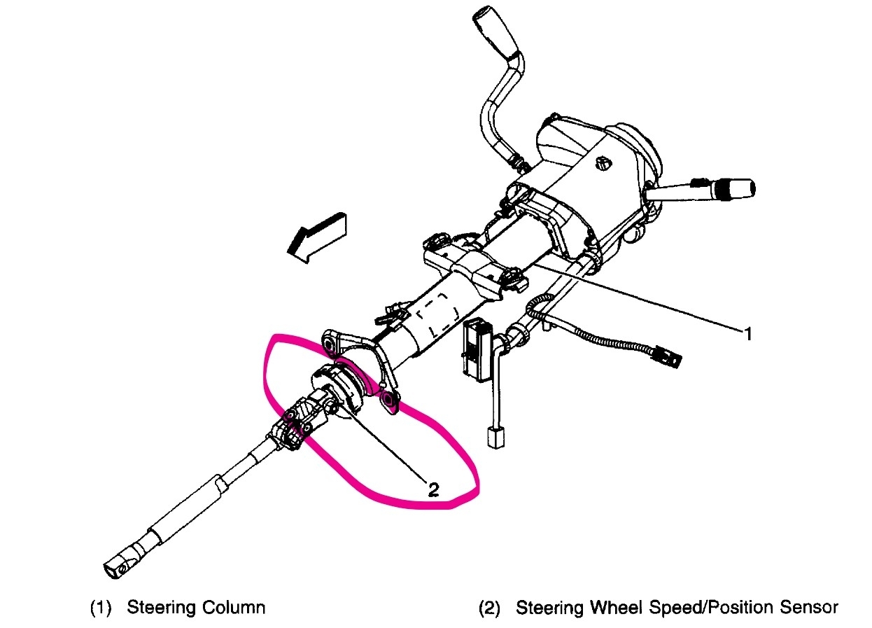

The C0205 is a code indicating one of the steering wheel position signals is out of range for more than one half second. These sensors are what tells the EBCM if you are turning the wheel and how fast.

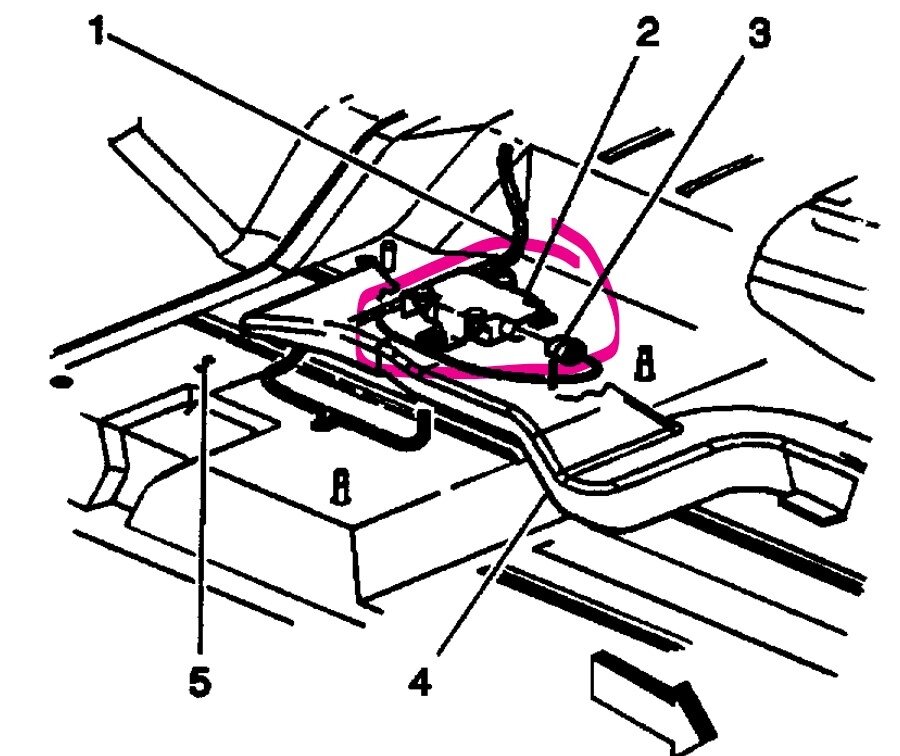

To test the sensors, you would use the scan tool to watch the live data from the 4 sensors while turning the steering wheel lock to lock and see if one or more is bad. It will also be used to read the information from the yaw sensor to see if perhaps it has a problem and is telling the system that you are swerving, and it should take control.
The yaw sensor is under the passenger side seat so it can get moisture in it causing corrosion. To get to it you remove the passenger seat then pull the carpet back and remove the three nuts, the electrical connector and the sensor. What you might try would be to try to pull the carpet back under the seat and disconnect the sensor. Then see if the truck still does the same thing (test in a safe area)? If it doesn't you could replace the module and see if it still operates properly.

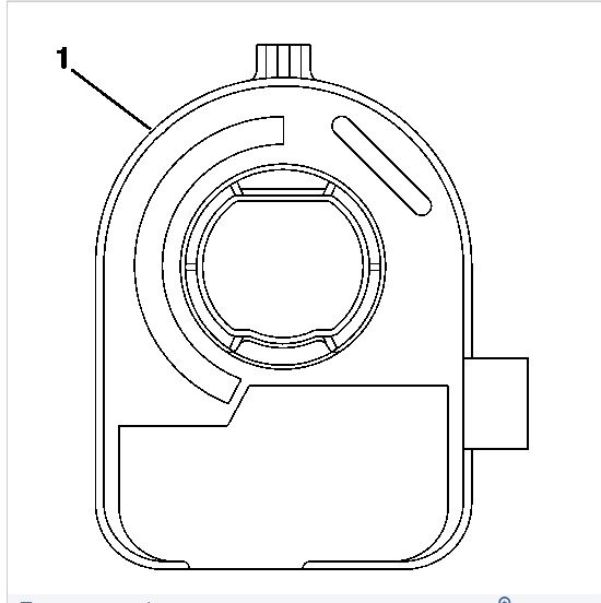

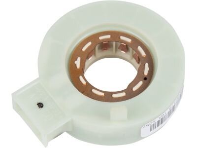

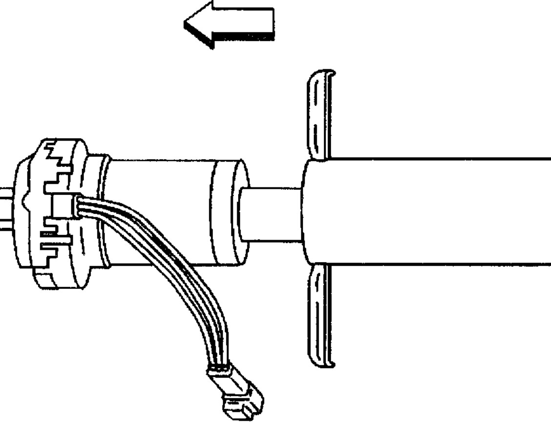

For the steering angle sensor, you lock the steering wheel straight ahead, then go under the dash and remove the bolt that secures the upper column to the intermediate shaft. Then you slip the shaft down. Next use a hook to pull the sensor wiring down enough to get to the connector and unplug it. Then you pull the sensor and bearing down off the shaft. Now you unclip the sensor, clip the new one into the bearing and slide it back into place. Put the shaft back into place and re-install the bolt, Torque it to 35 ft lbs. Either module could be a cause of the problem, but so could the PCM itself or the EBCM. That is why you need the dealer level scan tool to watch the data. The steering position sensor (Delco 26084178) is a set and forget part that usually comes with its own instructions.
