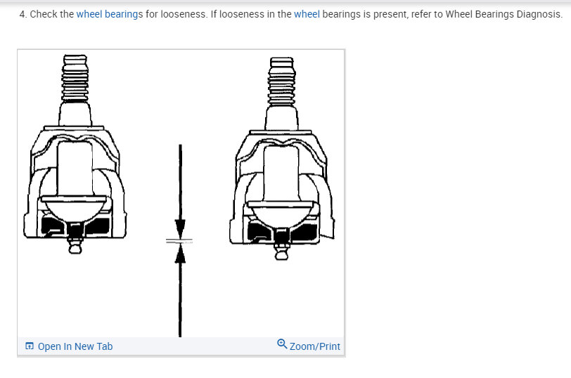

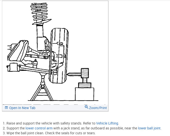

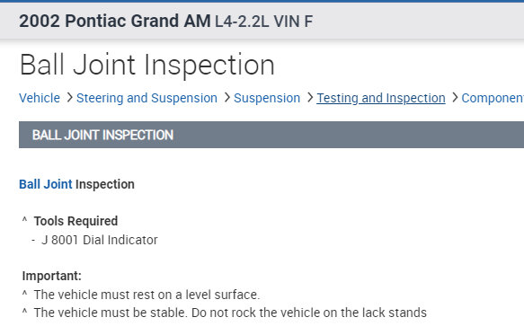

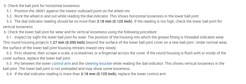

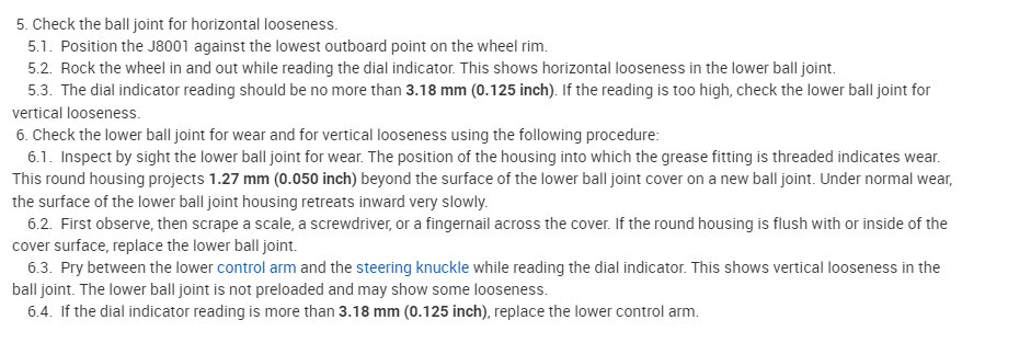

Hi Amy,
Is there anything you can think of that causes it to happen or causes it to stop? Are there any odd odors from the vehicle after driving it?
As far as struts are concerned, I don't see how they would cause vibrations. I guess the strut mounts, if bad, could make noise when turning the wheel. Do you know if the ball joints were checked when they had your vehicle? That could cause a creaking sound.
Is it loud enough for you to record the sound and upload it for me to hear? If so, could you do that?
I attached the directions for testing ball joints below. Let me know if that is something you feel comfortable doing.
