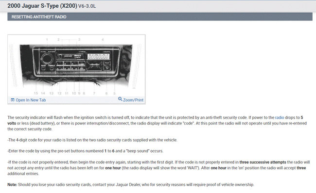

Nothing should have locked the steering wheel. I'm not completely sure I understand what is locked on it.

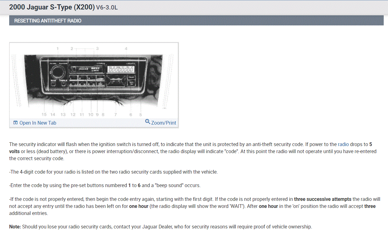

As far as the radio, they have different codes. Take a look at the attachment below. It indicated how to unlock the radio and where to find the code.
See pic below.

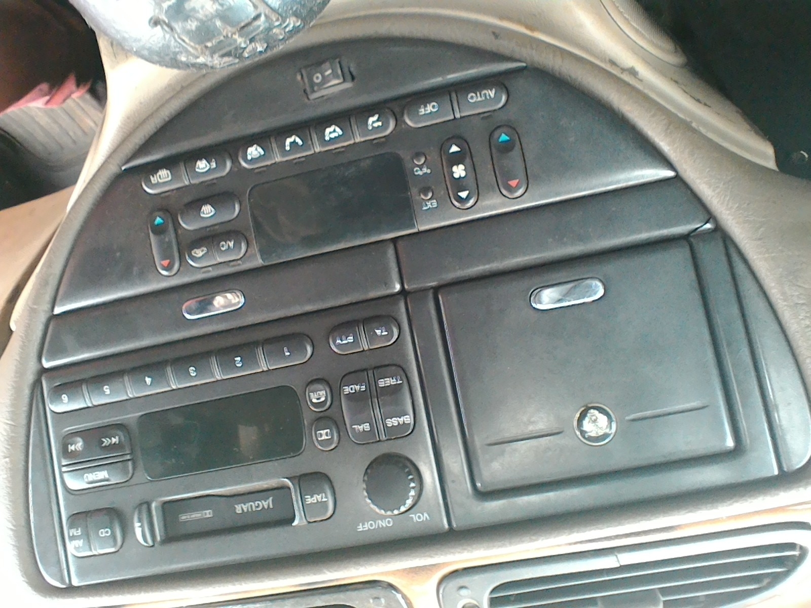

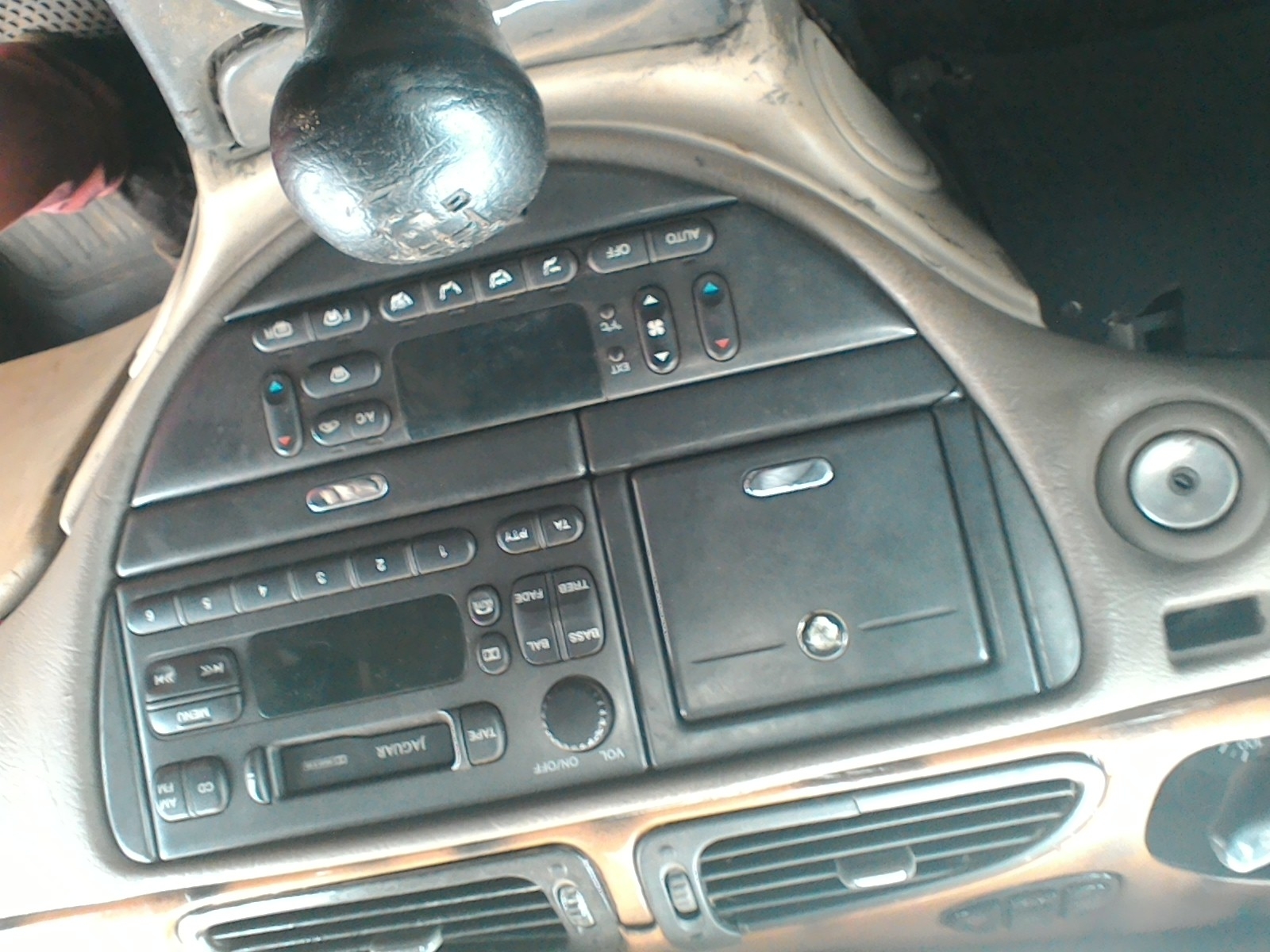

Hello! Good morning, thanks for your assistance but I want you to know that the radio is not touch screen and I don't think it will work. Look at the image below.
Wednesday, August 18th, 2021 AT 8:03 PM
  • 110,194 POSTS
Are the same buttons indicated in the video on this radio as well?
Wednesday, August 18th, 2021 AT 10:03 PM
MALLYBOY
  • 338 POSTS
Are the same buttons indicated in the video on this radio as well? No, that was why I said it will not work.

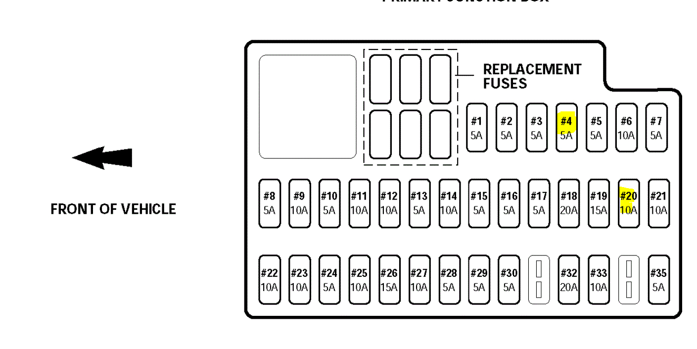

I have gotten the radio code from the manual and unlock the radio but the steering wheel is still locked. How do I unlock the steering wheel?
Thursday, September 2nd, 2021 AT 11:26 PM
  • 110,194 POSTS
The steering lock is secured to the lower casting of the adjustable steering column and consists of a locking pin and an electric motor. The electric is operated and controlled by the REM, GEM, and the instrument cluster. Have you checked fuses to these components?
The steering should unlock by the installation of the key. Check to make sure nothing is disconnected and inspect the GEM.
I attached a pic of the fuse box below and highlighted the fuses to check. Fuse 4 is for the REM and fuse 20 is for the GEM.
Make sure the fuse is good and there is power to it.
Let me know what you find.
See pic below.
