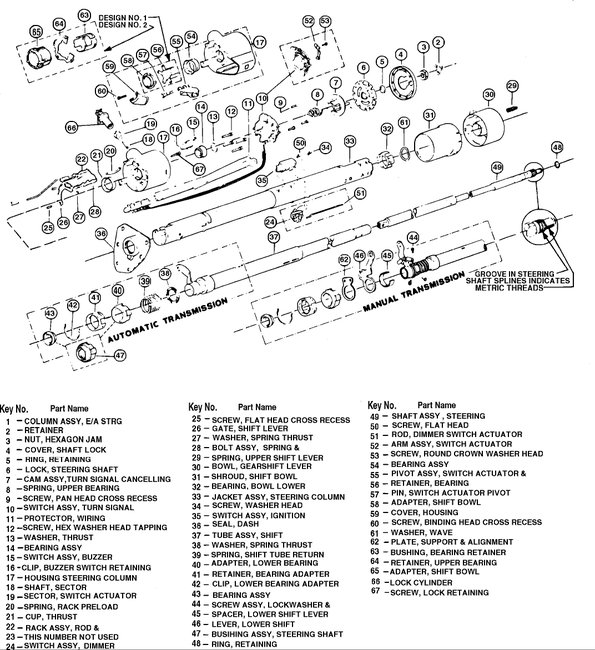

The blinker switch in the column was replaced by local mechanic six months ago. a few days ago I noticed the upper shaft which is attached to steering wheel with large center nut moves out of the steering column over half an inch by its self. The lower portion of shaft protruding from bottom of column does not move up or down. Apparently the shaft inside the column is two piece, but the wheel still turns the vehicle with the shaft out of the column a bit. Do you have any suggestions as to why the upper half is not staying in the column? How to repair the issue along withe a blow-up diagram of the column- for column shift automatic transmission 700R4, non tilt, wiper switch on dash (not in column)? Thanks all!

The shaft is a two piece design to allow it to collapse in the event you are in an accident. The upper section is "glued" to the lower section with a plastic that gets injected into holes in both halves. To repair it you need to remove the column and tear it down enough to remove the shaft. It is usually much cheaper and faster to just replace the column as the shaft is not a common part so it is a dealer or NOS item.
Plus you could add tilt if you wished.

Steve, The diagram you have provided is great for me to see the inner workings of my steering column. Much Appreciated! I am able to visualize the two sections of the shaft easily with your guidance, and reluctantly agree that a new column would be the best method of repair. Thank you for the quick response, professional diagnosis, and also the awesome diagram!

If you look at the exploded view you can see the upper bearing (14) in the column. If GM had bothered to make that a single roller bearing instead of a tapered one this issue would not happen. As it is that bearing allows force on the steering wheel to pull up on the shaft and break the joint at the bottom. On the tilt wheels they used a top/bottom bearing that negates that problem. But the tilt columns also have issues if they are used as a handle to get into the vehicle.
