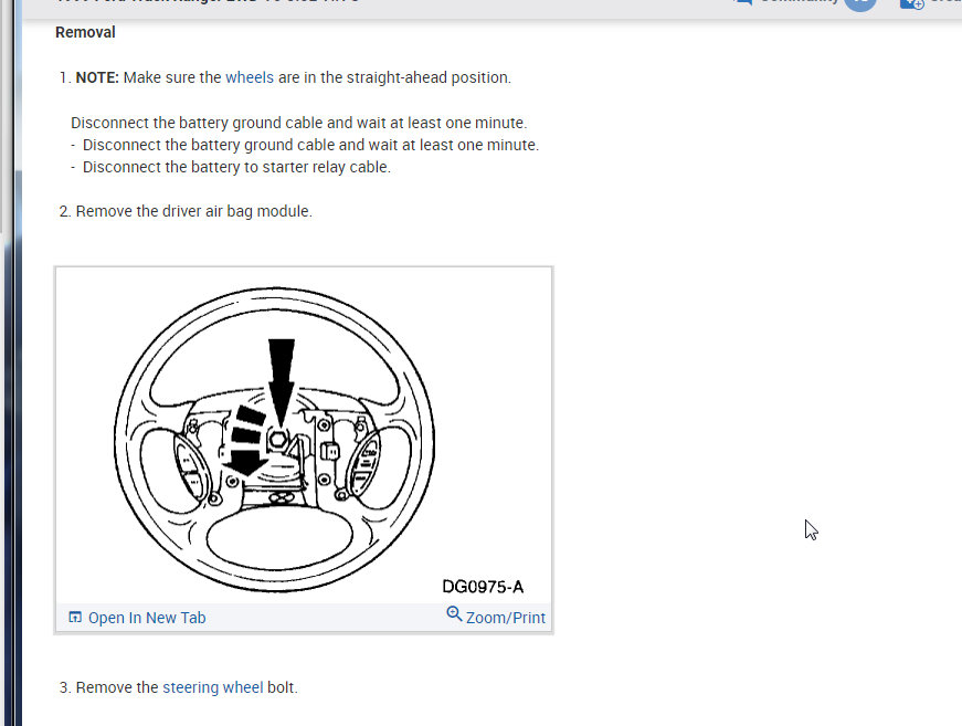

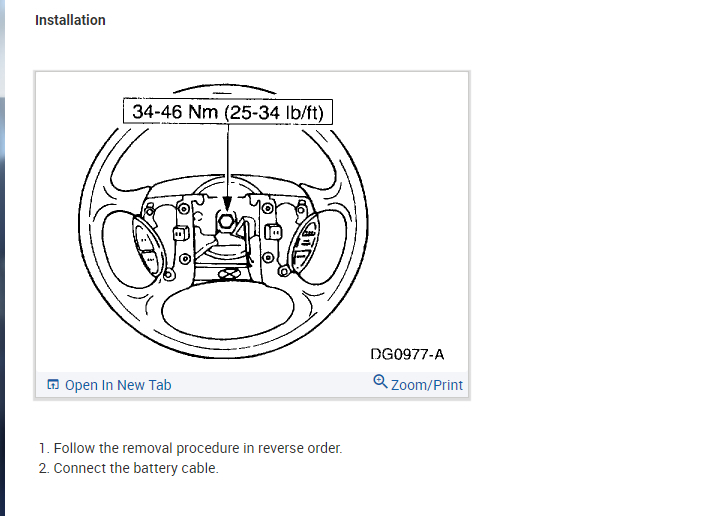

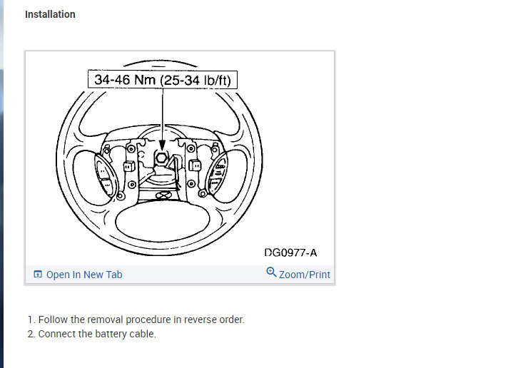

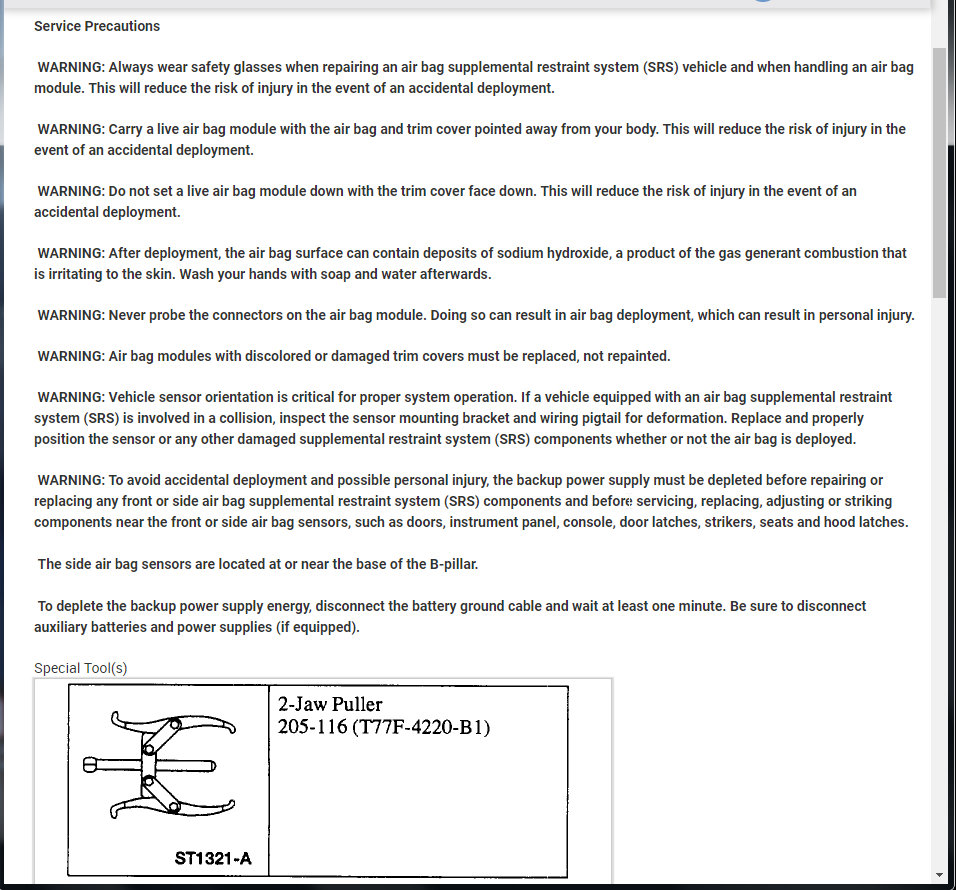

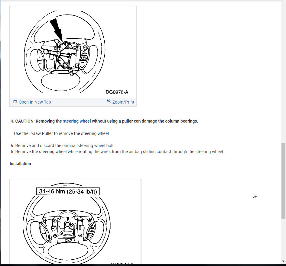

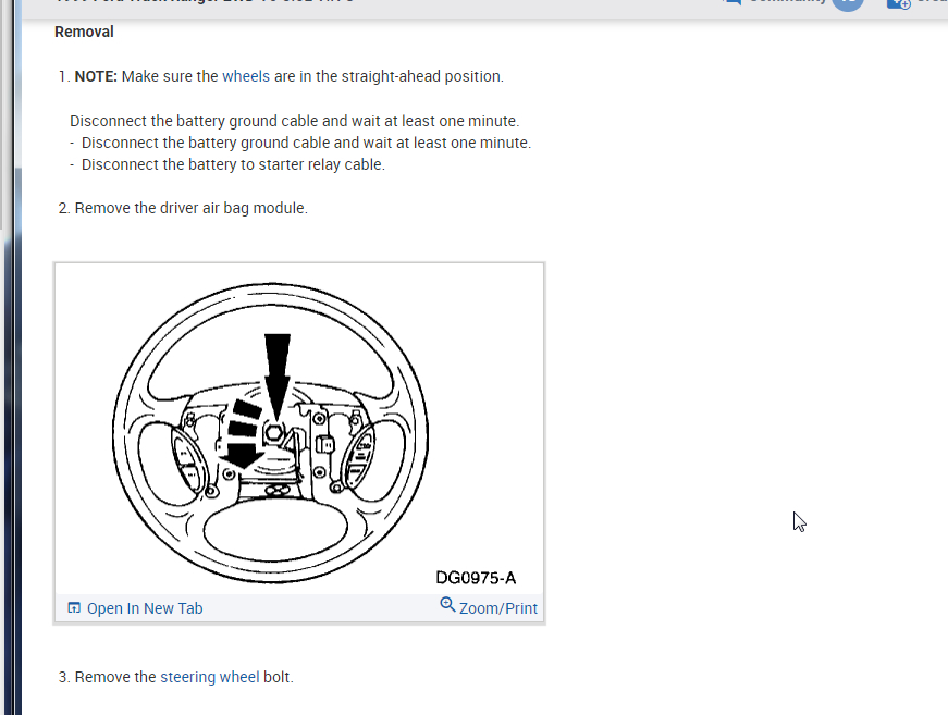

I'm trying to take the steering wheel off.

I am attaching the process from the manual. Let us know if you need more information.
Also, here is a guide that will help with a little more general information:
https://www.2carpros.com/articles/steering-wheel-removal
