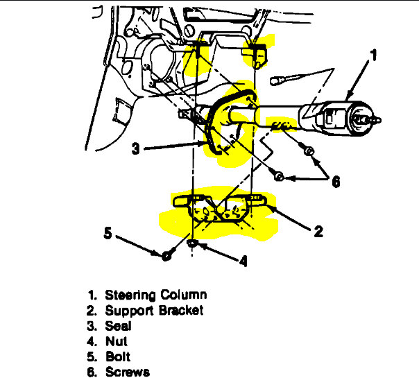

I put it in gear the whole column turn sometimes even tries to restart the truck.

That doesn't sound safe. LOL As far as the column, there is a support bracket, and the column is also bolted to the floor. See pic below.
Check to make sure everything is tight there and nothing has broken.
Let me know what you find.
See pic below.
