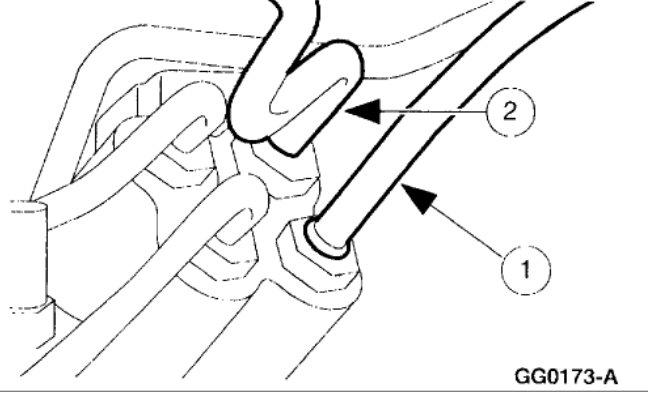

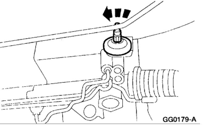

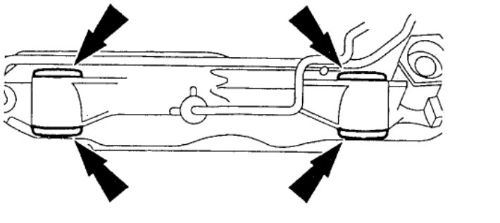

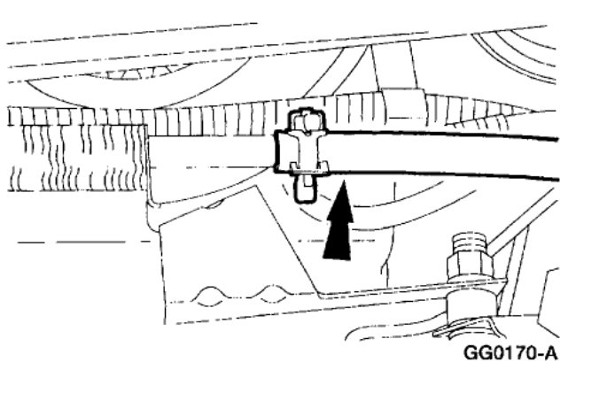

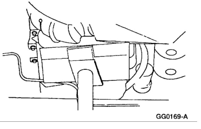

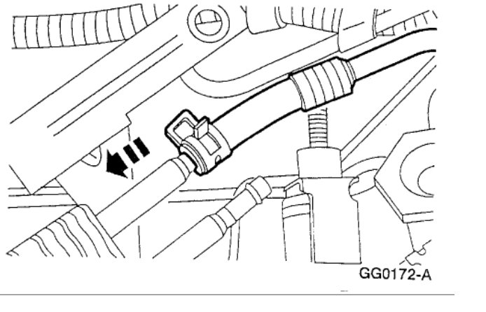

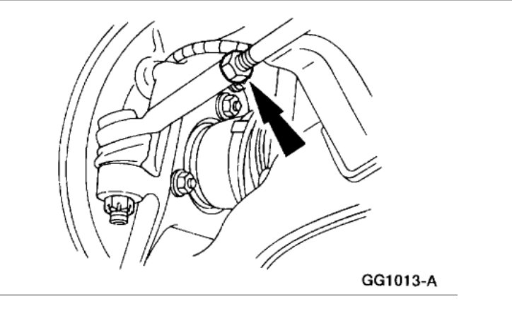

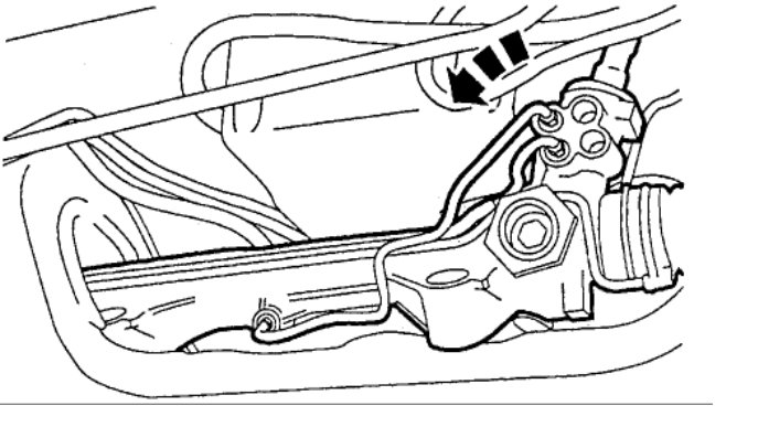

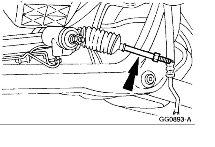

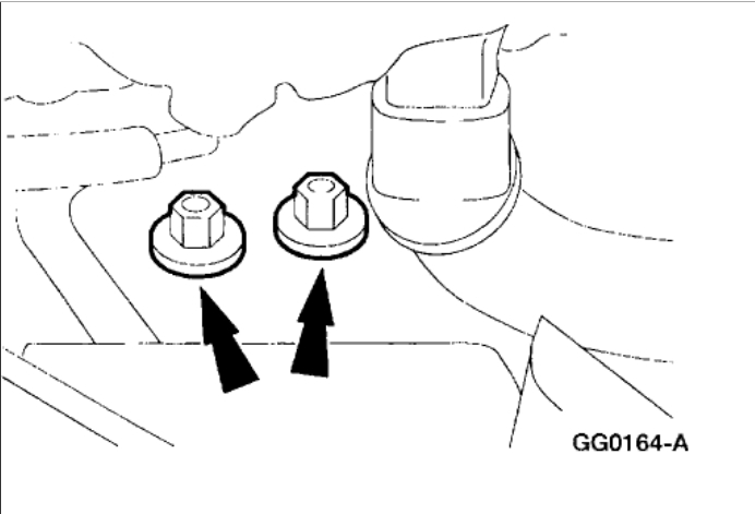

This is common when the steering pump or steering box goes out. Can I ask if the system makes any noise when you are trying to steer it. Also remove the steering fluid cap and start the engine do you see fluid moving around? If so it sounds like the steering rack went out. Step by step with instructions in the diagrams below to show you how on your car. Check out the diagrams (below). Let us know what happens and please upload pictures or videos of the problem.

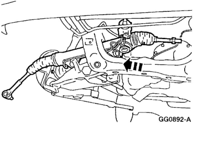

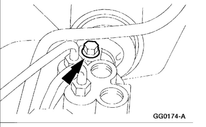

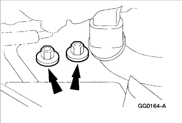

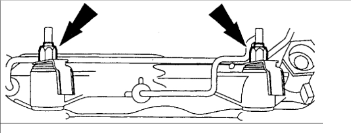

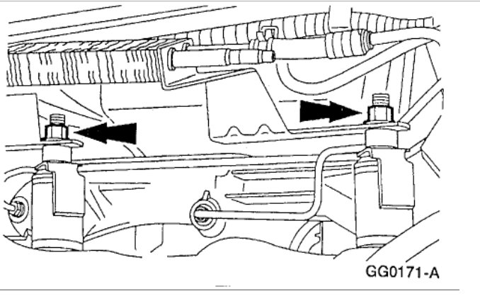

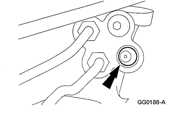

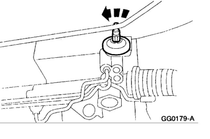

TOTALPERFEKTION
  • 1996 FORD EXPLORER
Steering problem V8 All Wheel Drive Automatic 244, 00 miles

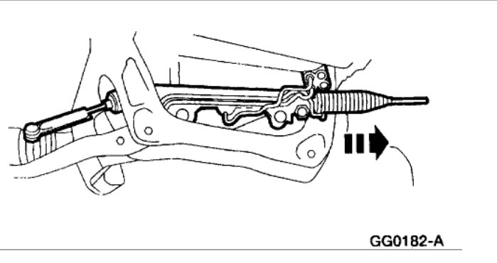

We are trying to remove the old rack and pinion. The Haynes manual says it needs to be rotated to the front in order to be removed. I have disconnected everything the book instructs, but the rack will not rotate to the front. Is there something that I am missing or a step the manual does not list?
Wednesday, January 20th, 2021 AT 1:05 PM (Merged)

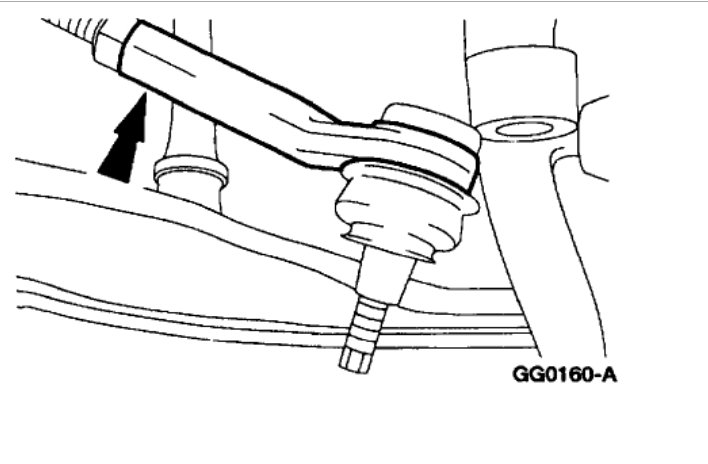

KEN L
  • MASTER CERTIFIED MECHANIC
  • 55,281 POSTS
Yep those can be tricky, use must do kind of a dance to get it out of there. Here are some guides to help you get the job done.
https://www.2carpros.com/articles/tie-rod-end-replacement
and if jacking the car up is needed.
Here is what the book says how the job is done you can see you need to pull the input shaft housing forward.
