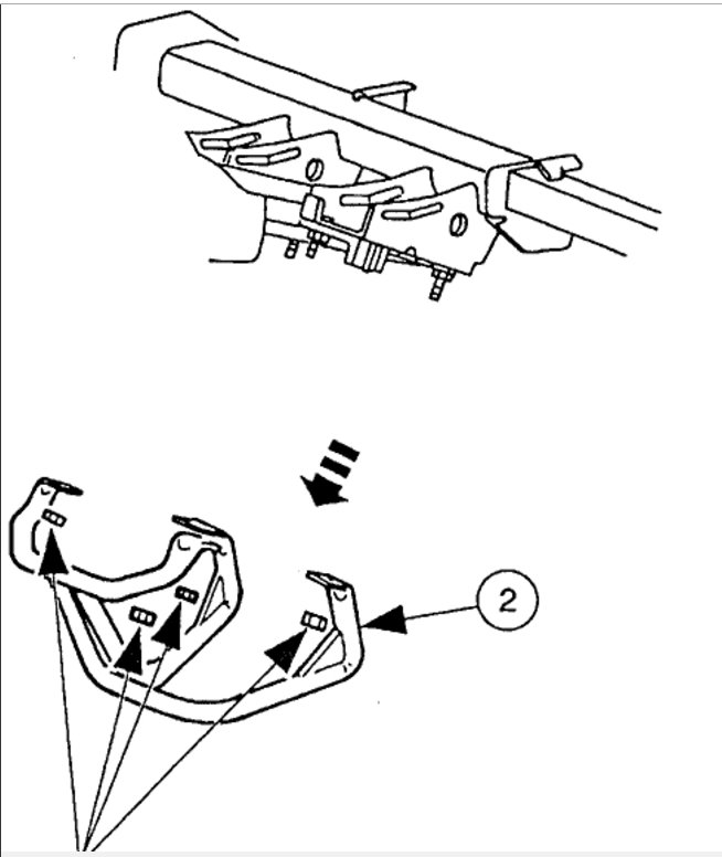

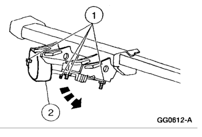

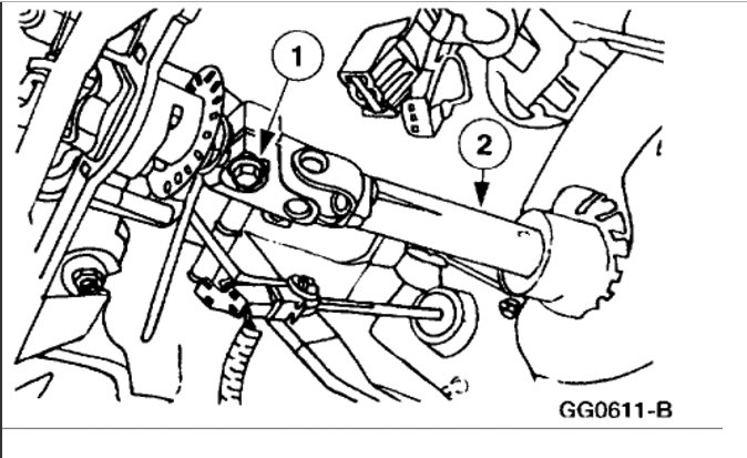

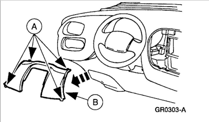

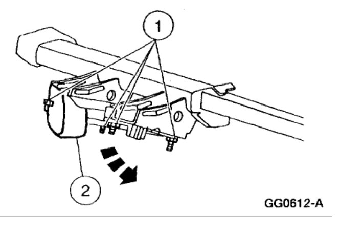

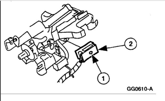

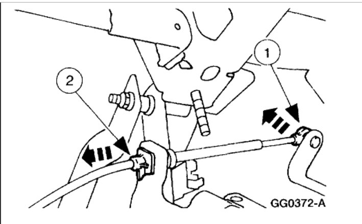

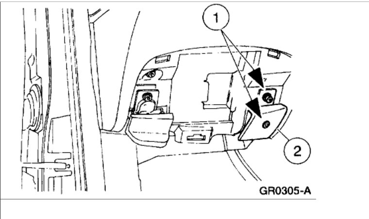

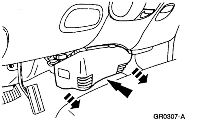

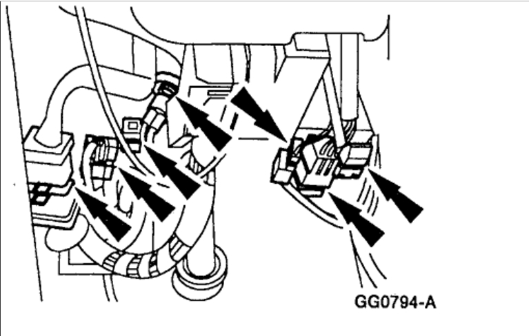

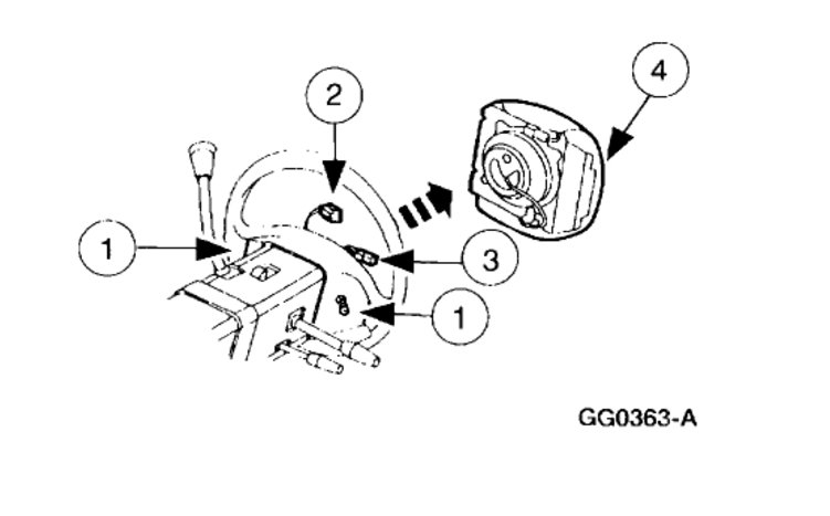

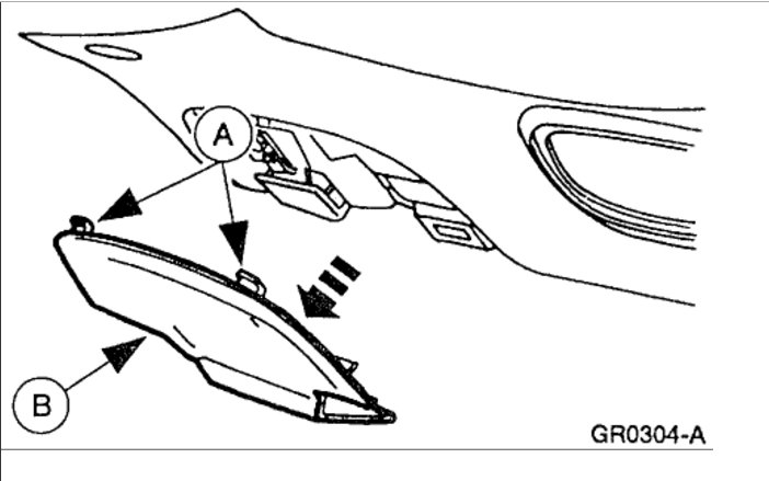

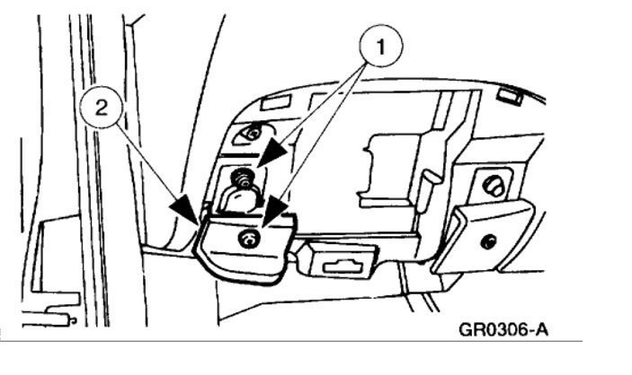

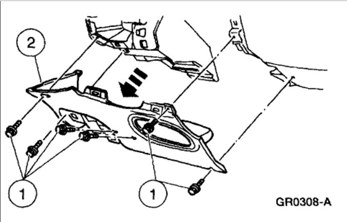

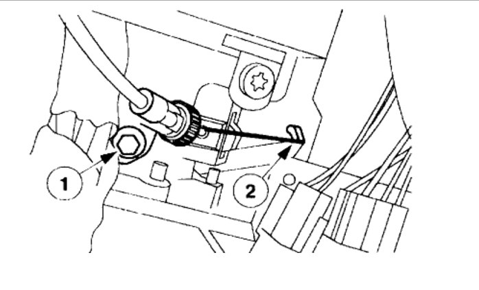

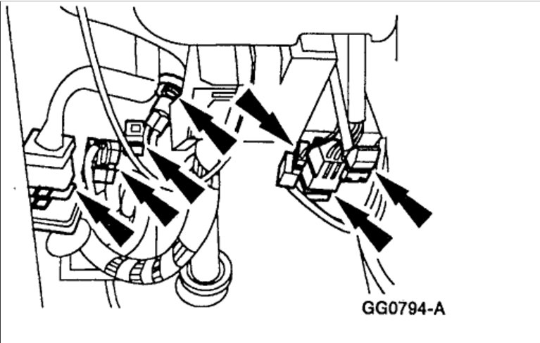

I am trying to find out how to remove a steering column and install it into my truck.
Sep 3, 2017 at 12:25 PM
  • CAR REPAIR CONTRIBUTOR
  • 54,441 POSTS
Start by disconnecting the battery. Here are some guides that will show you how it is done (below).
You will need to remove the airbag as well.
https://www.2carpros.com/articles/air-bag-removal-steering-wheel
