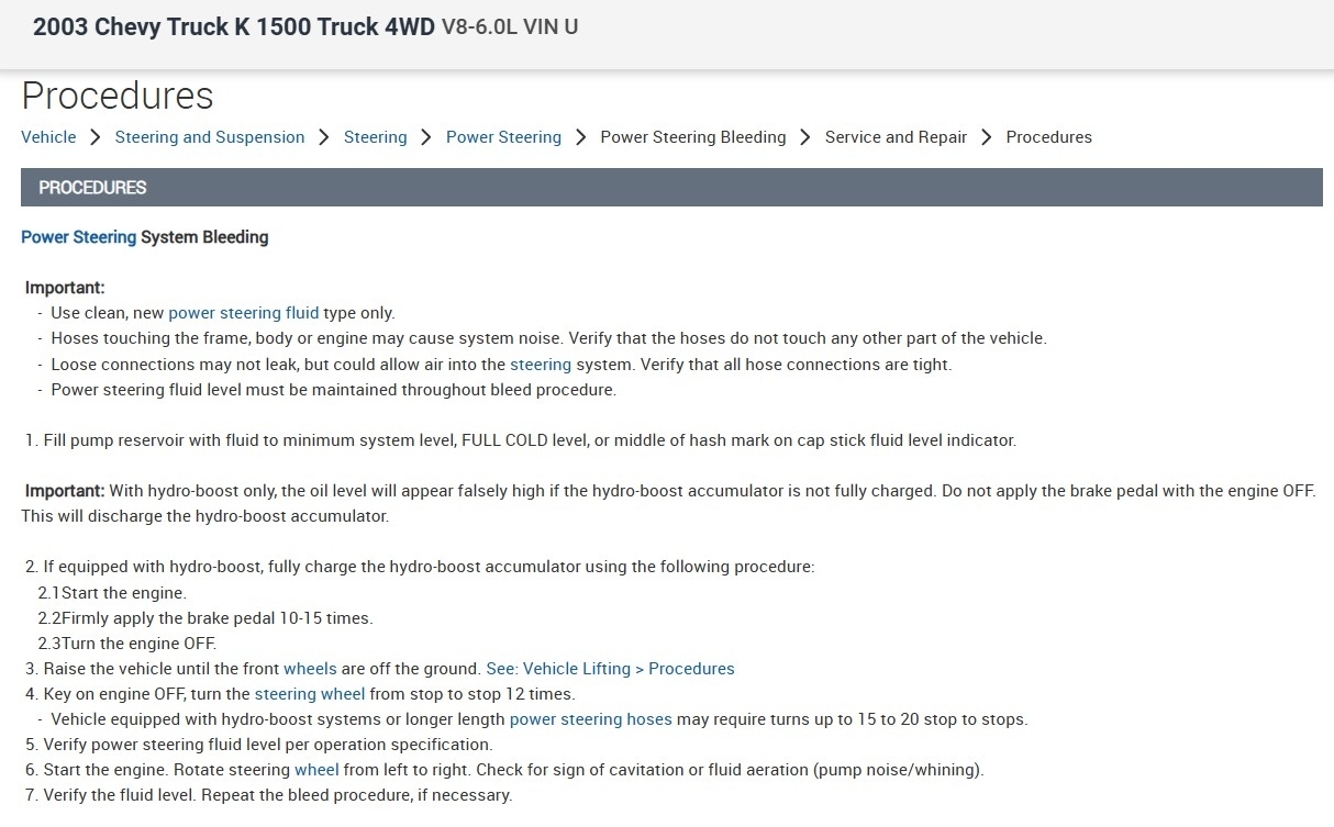

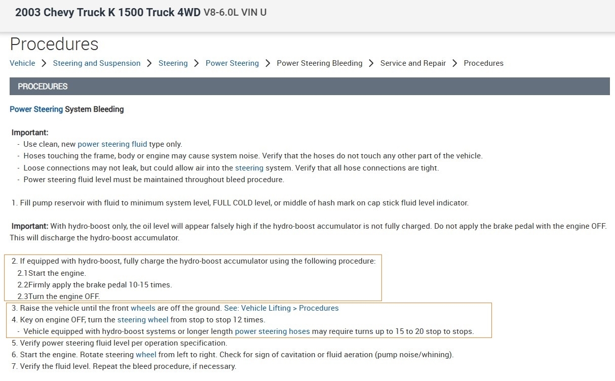

  • 5,541 POSTS
This is the procedure listed in service info for bleeding the power steering system. It sounds like the system may still be low on fluid if you read through this.

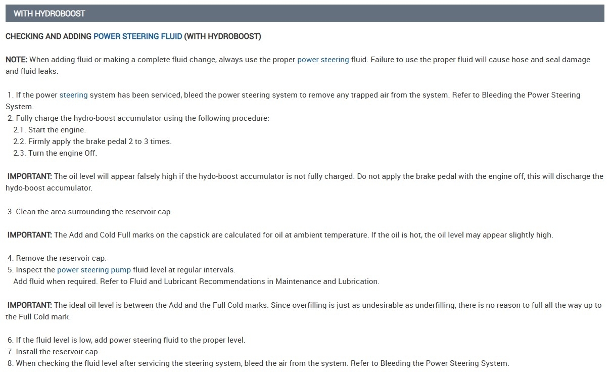

  • 5,541 POSTS
There is also a procedure listed for (w/ Hydro-Boost) here.
