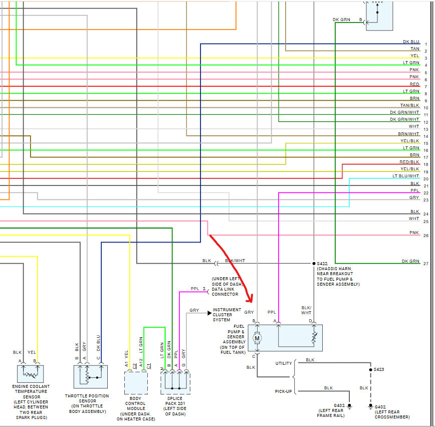

Getting ready to change fuel filter. Plan on connecting hose to outlet of old filter and pickup pump feeding old gas into a glass 1 gallon jugs. Is here a way to energize pump without pulling relay out and jumpering 30 to the other contact which I think is 87. Not sure. I don't want to damage the receptacle shoving something in it. Hoping to empty they 10 gallons of fuel in the tank. Turning key in only energized the pump 2 seconds. Please advise.
Thank you, my friend.
Tuesday, October 29th, 2024 AT 1:03 PM
KEN L
  • MASTER CERTIFIED MECHANIC
  • 55,512 POSTS
You won't hurt anything by draining the tank.
Here is a video to help:
https://www.youtube.com/watch?v=Q5MH2gnyFH0&t=37s
Let us know what you find. Here are the wiring diagrams for the fuel pump.

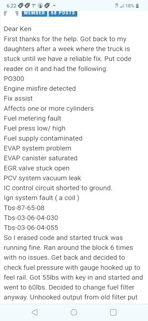

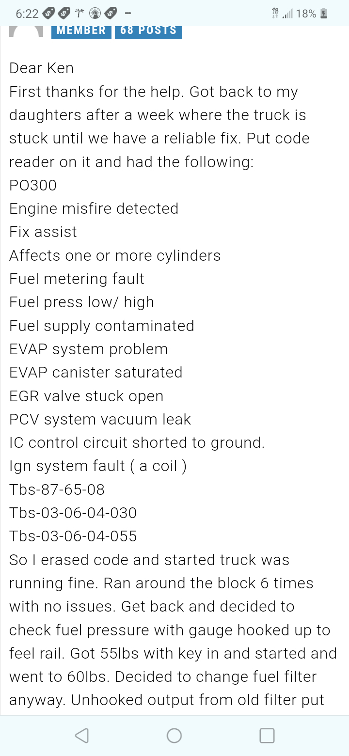

First thanks for the help. Got back to my daughters after a week where the truck is stuck until we have a reliable fix. Put code reader on it and had the following:
PO300
Engine misfire detected
Fix assist
Affects one or more cylinders
Fuel metering fault
Fuel press low/ high
Fuel supply contaminated
EVAP system problem
EVAP canister saturated
EGR valve stuck open
PCV system vacuum leak
IC control circuit shorted to ground.
Ign system fault ( a coil )
Tbs-87-65-08
Tbs-03-06-04-030
Tbs-03-06-04-055

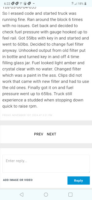

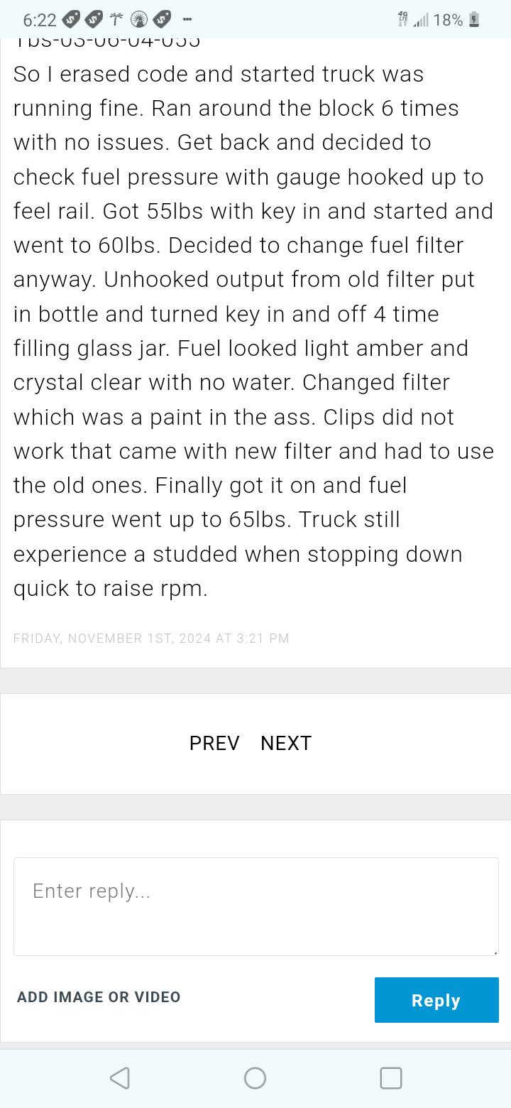

So I erased code and started truck was running fine. Ran around the block 6 times with no issues. Get back and decided to check fuel pressure with gauge hooked up to feel rail. Got 55lbs with key in and started and went to 60lbs. Decided to change fuel filter anyway. Unhooked output from old filter put in bottle and turned key in and off 4 time filling glass jar. Fuel looked light amber and crystal clear with no water. Changed filter which was a paint in the ass. Clips did not work that came with new filter and had to use the old ones. Finally got it on and fuel pressure went up to 65lbs. Truck still experience a studded when stopping down quick to raise rpm.

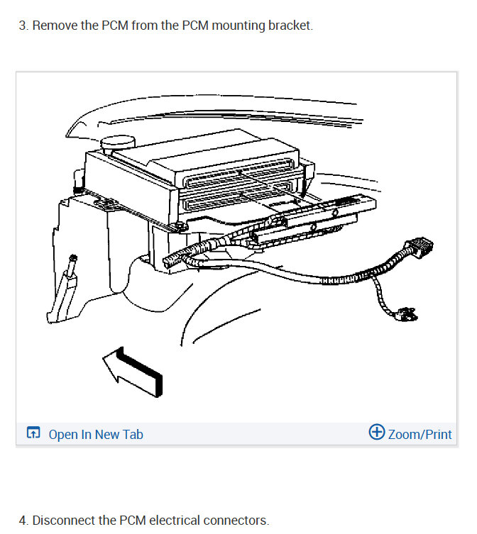

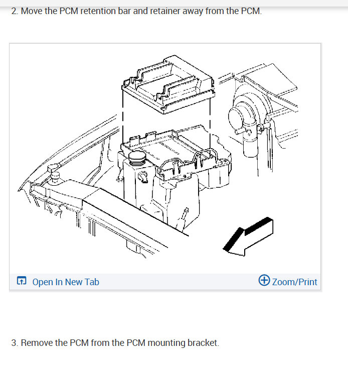

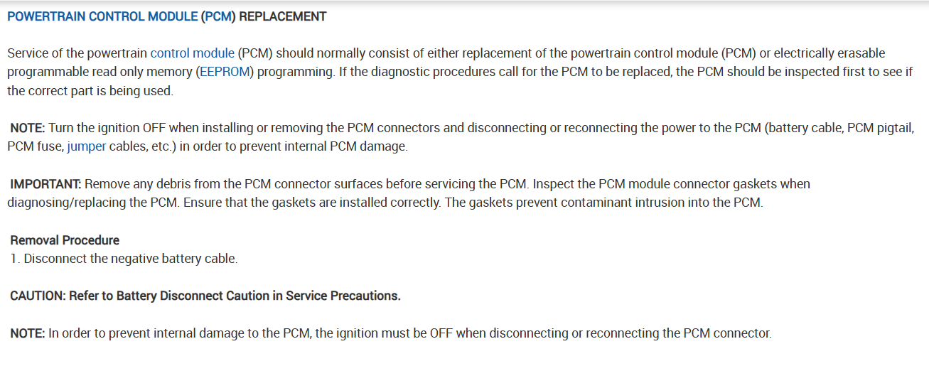

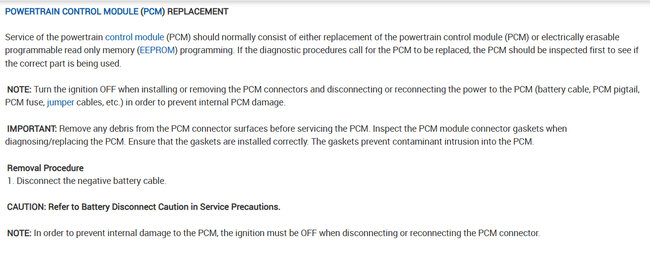

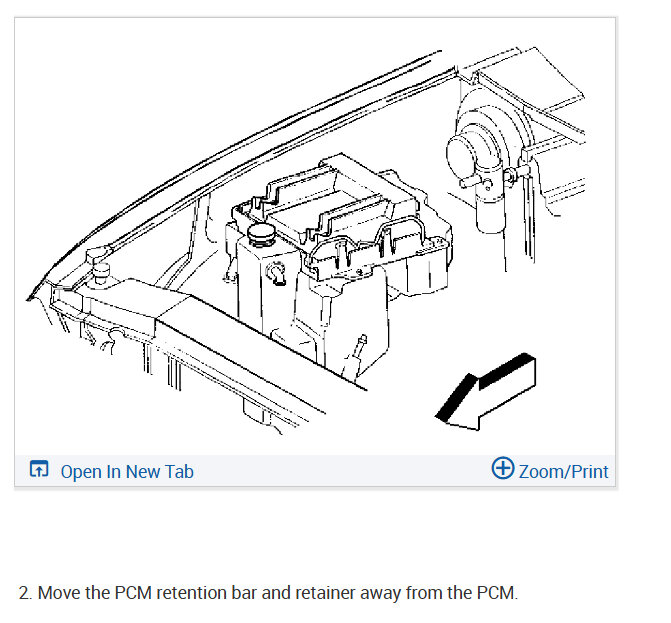

With all of these codes it seems like the PCM is bad, you can remove it and send it in for testing to confirm. Here is the location of the PCM and how to change it out. You can get a preprogrammed unit by searching Google or Ebay. Check out the images (below). Please let us know what happens.

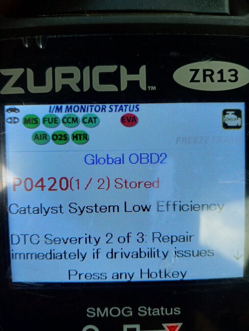

Reset code. Put Lucas engine conditioner in fuel tank. Headed home with no service engine light until 6 miles out. Stayed on without flashing until I got home. Truck ran normally. Once home put code reader on it and got.
Sunday, November 10th, 2024 AT 3:48 PM
RWALBROEHL
  • 127 POSTS
New update.
Reset code. Put Lucas engine conditioner in fuel tank. Headed home with no service engine light until 6 miles out. Stayed on without flashing until I got home. Truck ran normally. Once home put code reader on it and got PO420 catalyst system low efficiency. Also, a small red icon that says EVA.
Sunday, November 10th, 2024 AT 3:53 PM
KEN L
  • 55,512 POSTS
You could have a partially clogged catalytic converter, please go over this guide to see if that is the issue.
Please go over this guide and get back to us.
Monday, November 11th, 2024 AT 8:53 AM
RWALBROEHL
  • 127 POSTS
Checked the cat after driving awhile temperature at input was 303 degrees and the output was 500 degrees. Ran truck about 5 miles with no light up and 5 miles back. Then went a 33-miletrip and back to the store and there was no service engine light yet. Afraid to go too far because I can't afford a tow truck trip. This is after putting the Lucas complete engine conditioner in two weeks ago and driving it back 14 miles it which time got the light halfway back. Since then, reset code and no light yet with these short runs. Any suggestions? Thanks
