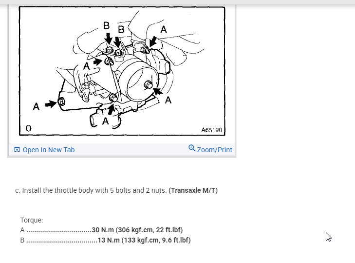

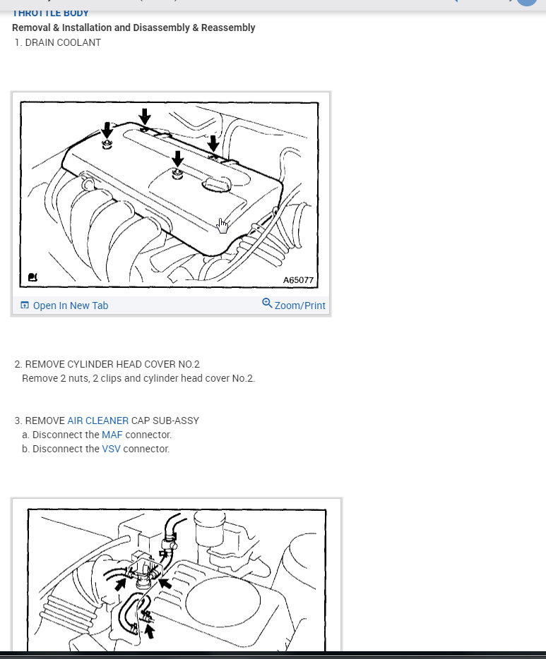

Hi and welcome to 2CarPros. I would recommend you clean the throttle body first. Here is a link on throttle body issues:
Clean it out first and let us know if that help the issue.

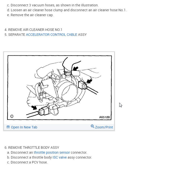

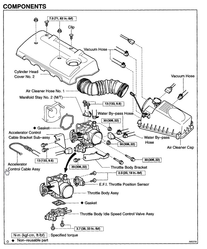

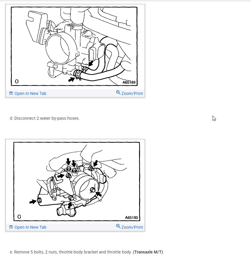

This could be as simple as the idle control valve is causing it to stall. However, this normally causes a stall at start up not only when it is warm. However, it would be a good idea to clean the throttle body and ISC valve.
If this does not correct the issue then we need to check for a vacuum leaks. Here is a guide that can help with that. Let me know what you find and we can go from there. Thanks

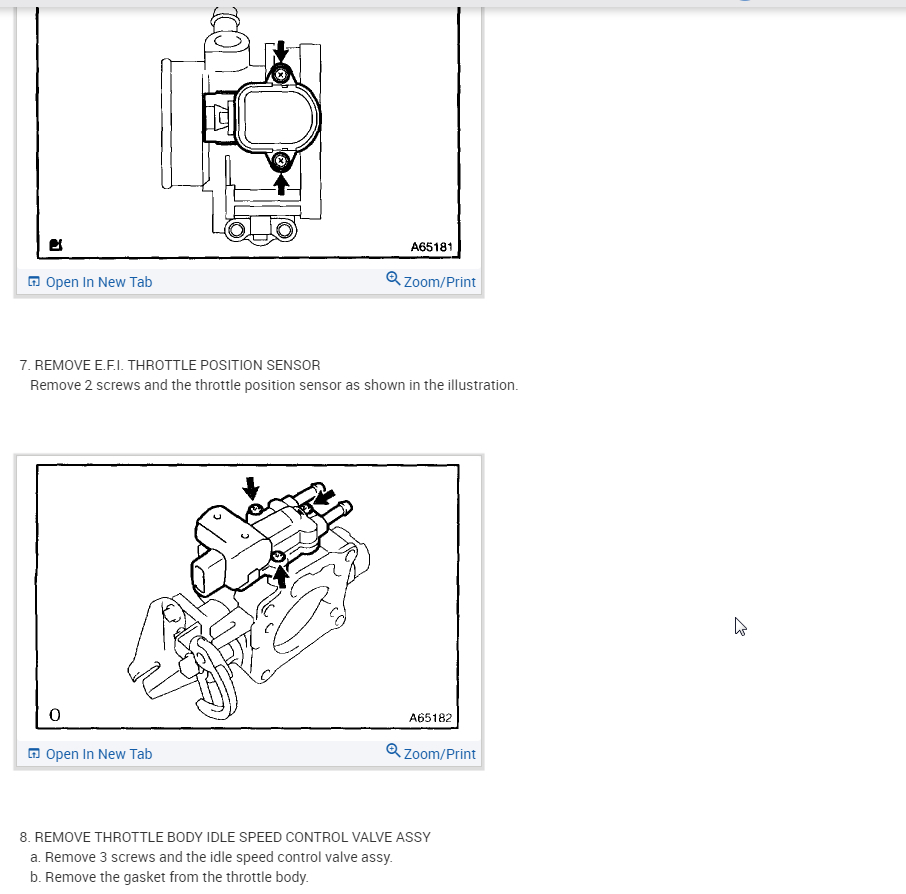

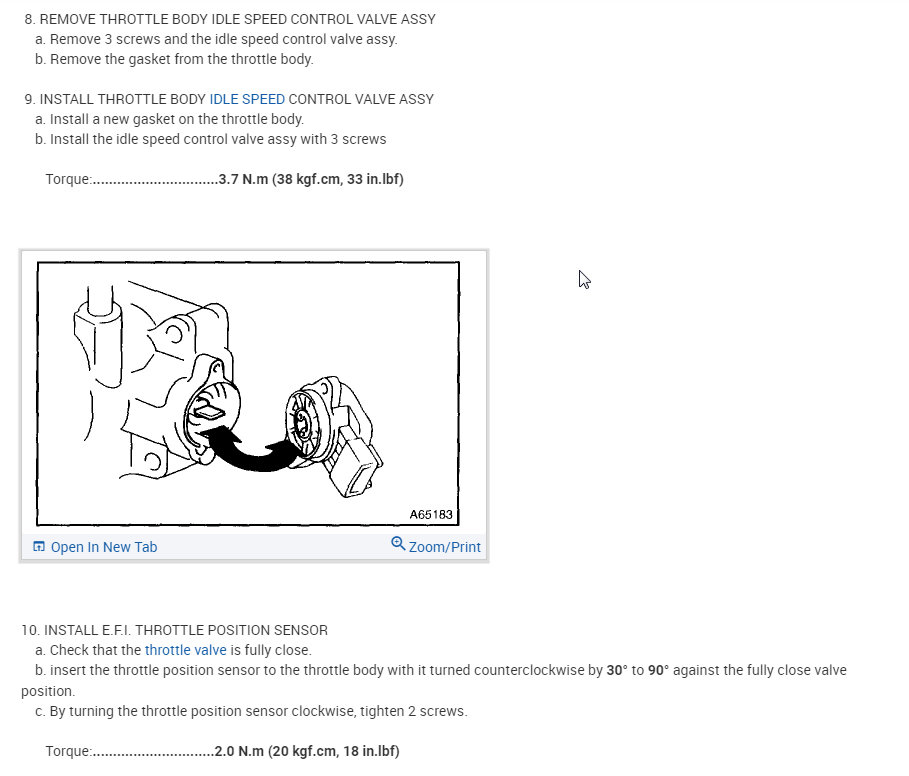

Try cleaning the Idle Air Control Motor. Also clean out around the butterfly in the throttle bore with carb cleaner and a rag. This should help stabilize the idle. Also be sure the tune up is in good shape, at that mileage you should be on your second major tune up

Clean out the idle air control valve, test the TPS and MAF sensors-to include checking the EGR valve

The IACV is on the throttle body and the mass airflow meter is on left side of engine compartment in air intake duct.
