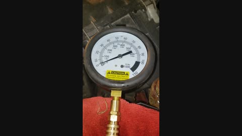

I start it up starts right up but then it shuts off seconds later. Checked fuel pressure seams fine. When running fuel is coming coming out and when it shuts off fuel is still coming out.

Was that line open from the pump? It should stall with an open fuel line as the pressure drops.
What did the pressure drop to when it started?

Did the pressure drop off when it stalls?

No it did not in my gauge but for some reason even when you release pressure my gauge still shows pressure.
Could not tell if pressure moved or not. My gauge does not like to move that well, but the friend of mine that owns the car kept saying it is the fuel pump and I tried to say no I do t think it is. Well he insisted that I put a fuel pump in it and it does the same thing as before so not fuel pump issue like I thought.

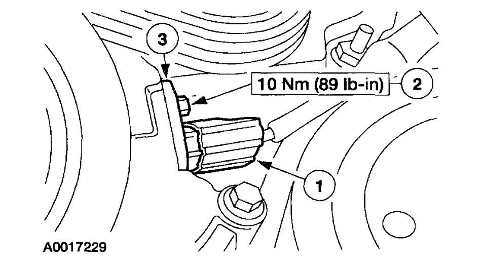

Do you have a scan tool?
Is there any codes set? Yes, it could be but needs to be confirmed. A crankshaft position sensor also comes to mind but need to confirm that as well.
crank sensor
REMOVAL
1. Raise and support the vehicle.
ImageOpen In New TabZoom/Print
2. Remove the bolts and the right front lower splash shield.
3. Remove the crankshaft position (CKP) sensor.
1 Disconnect the electrical connector.
2 Remove the bolt.
3 Remove the sensor.
INSTALLATION
1. To install, reverse the removal procedure.

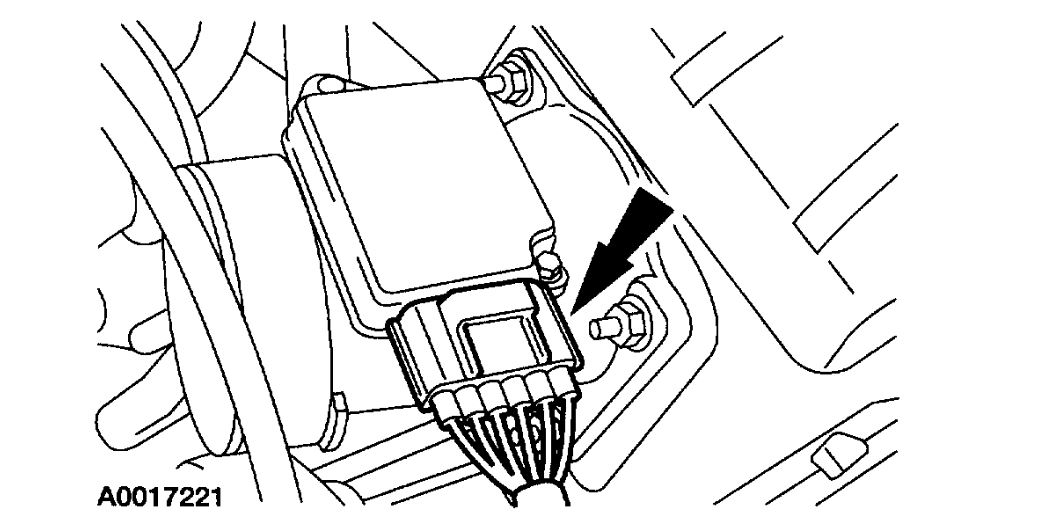

Mass air flow
REMOVAL
1. Remove the air cleaner outlet tube.
2. Disconnect the mass air flow (MAF) sensor electrical connector.
3. Remove the four nuts and the MAF sensor.
INSTALLATION

I do have a scan tool but does not show much it is a Harbor Freight one. I was playing with the vehicle last night unhooked the MAS sensor and it stayed running but of course rough. I am thinking replace MAS sensor then?
Wednesday, November 14th, 2018 AT 5:43 AM
  • 52,797 POSTS
No, that is not a test for the mass air flow at all.
This is a partial flow chart for the mass air flow sensor. It is involved.
It is also an expensive guess if you are wrong. I like to diagnose once, repair once.
