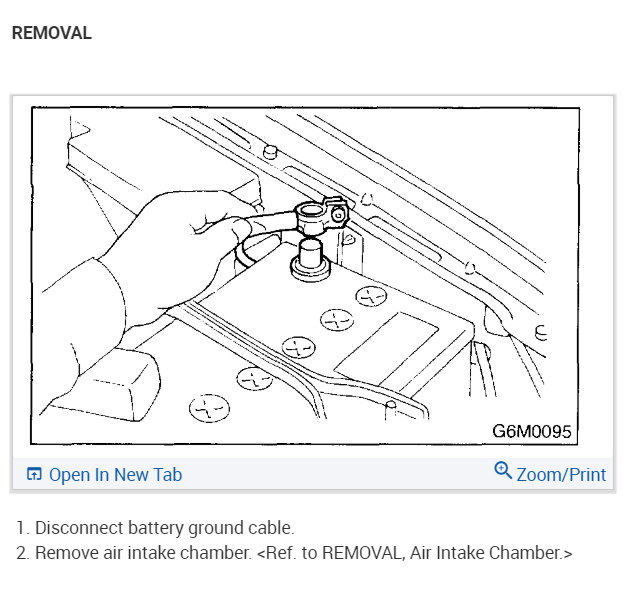

Starts an runs just for a few seconds
2002 SUBARU OUTBACK
150,000 MILES • 3.0L • 6 CYL • 4WD • AUTOMATIC
SCOUT2494
  • 12 POSTS
i have replaced the fuel pump, fuel pump relay, fuel pump regulator and removed the fuel line before it goes in fuel filter. gas squirts very little. could it be the crank shaft sensor?

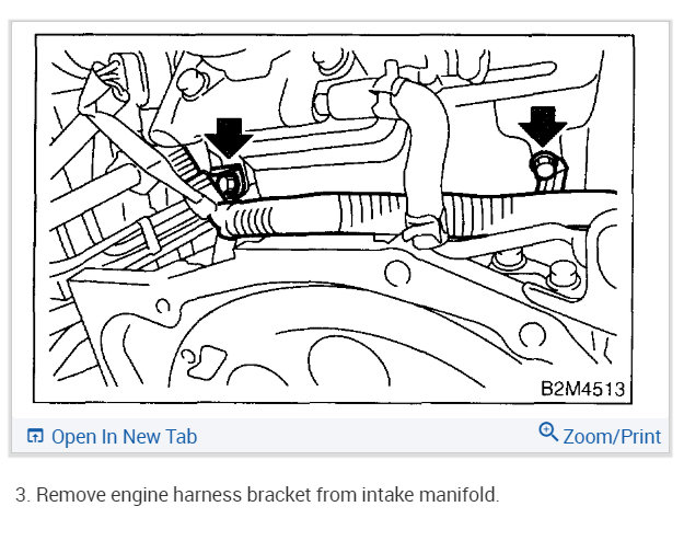

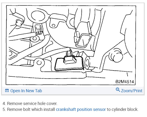

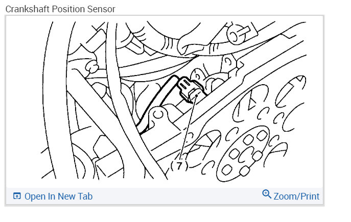

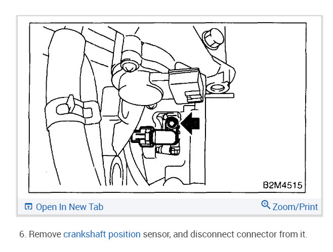

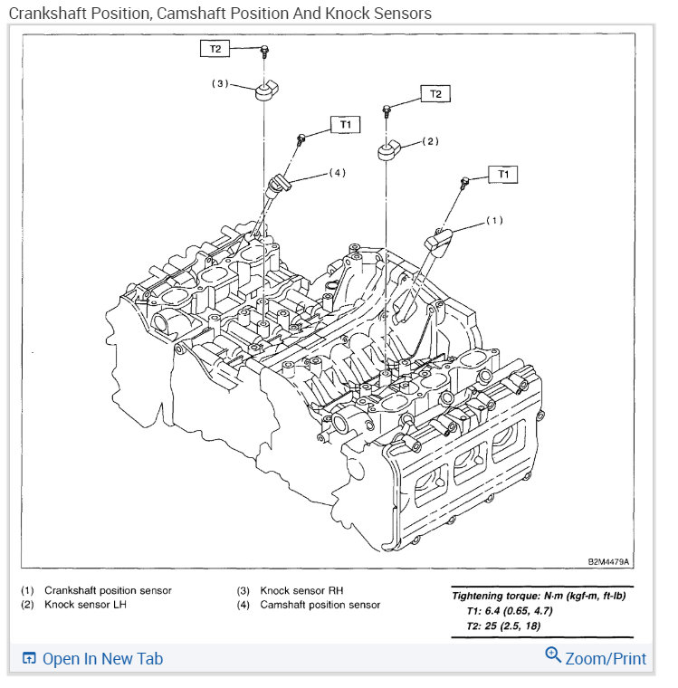

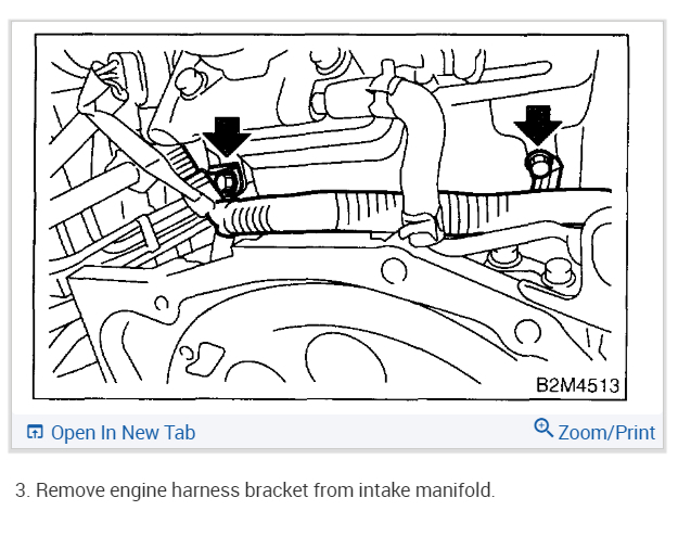

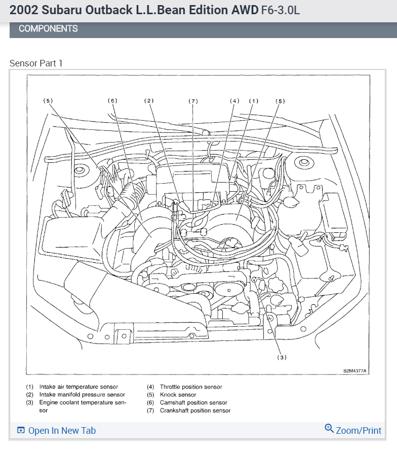

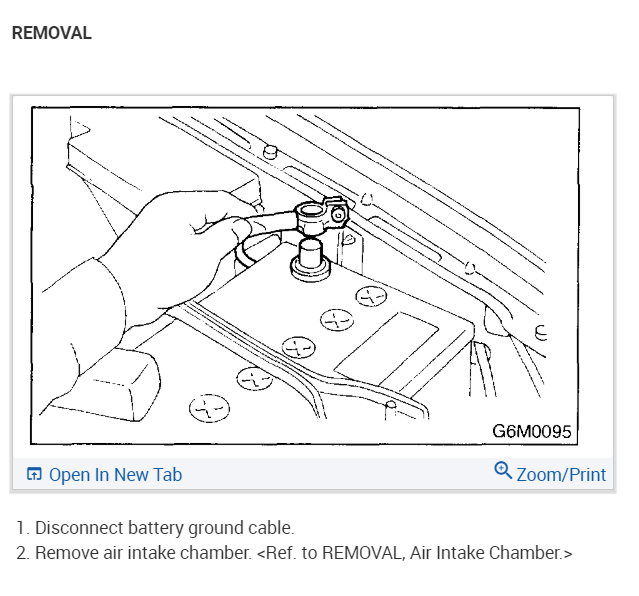

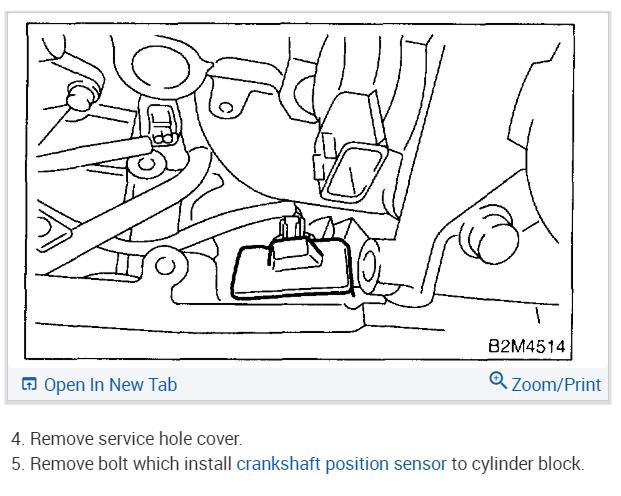

on the 2002 Subaru Outback 3.0 the crank senor is it located on top of the bell housing because it`s not under alternator?
Nov 22, 2019 at 4:38 PM
  • CAR REPAIR CONTRIBUTOR
  • 54,436 POSTS
Here is the location of the crankshaft sensor and the instructions on how to replace it in the diagrams below. Check out the diagrams (below). Please let us know what happens.
