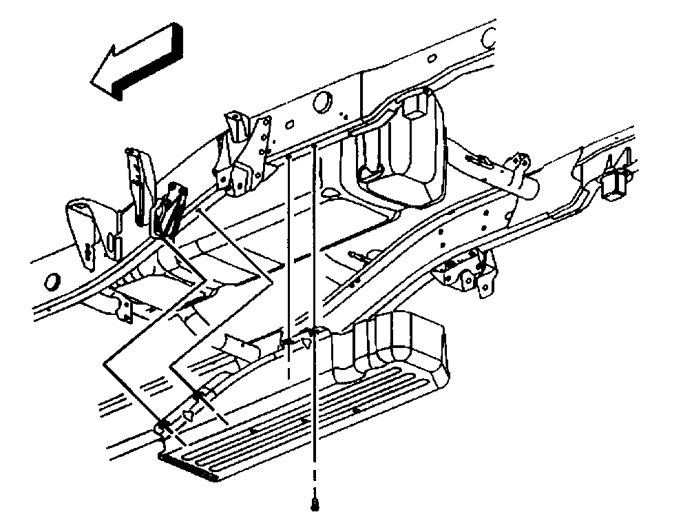

5. If equipped, remove the fuel tank shield bolts.
6. Remove the fuel tank shield.
Pic 2

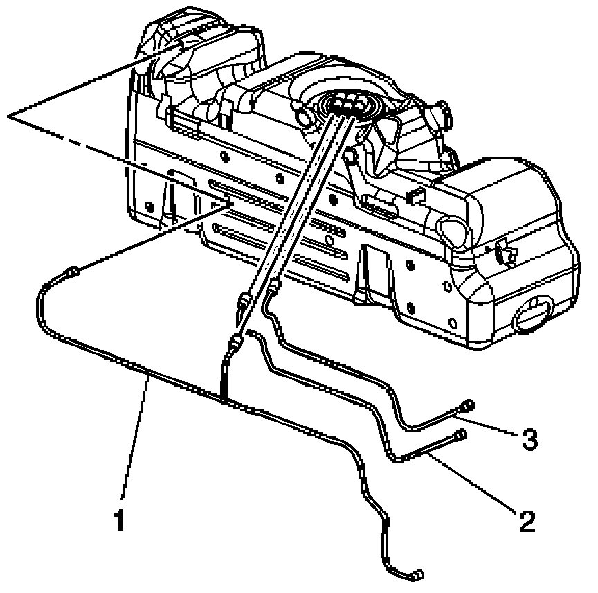

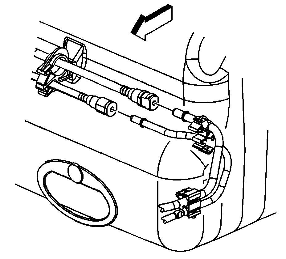

7. Disconnect the fuel feed/return pipes from the fuel tank pipes.
8. Cap the fuel and EVAP pipes in order to prevent possible fuel/EVAP system contamination.

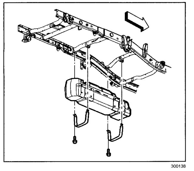

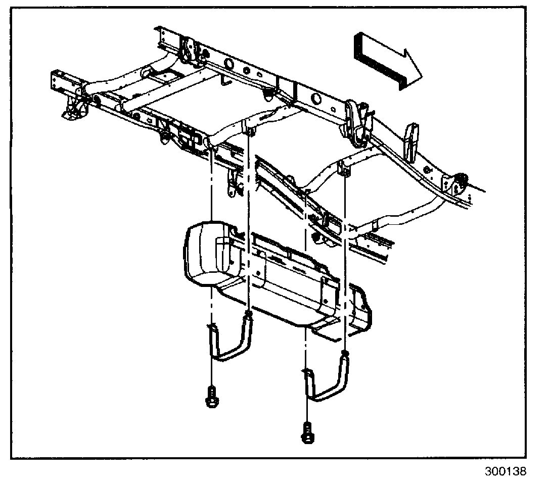

9. Place a suitable adjustable jack under the fuel tank.
Pic 3
10. Remove the fuel tank strap bolts.
NOTE: Refer to Damage to Fuel Tank Straps Notice in Service Precautions See: Fuel Tank > Vehicle Damage Warnings > Damage to Fuel Tank Straps Notice.
11. Remove the fuel tank straps.

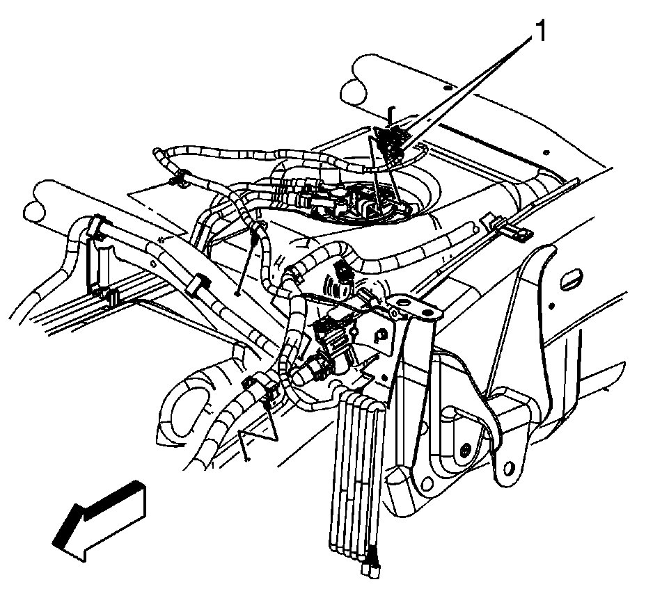

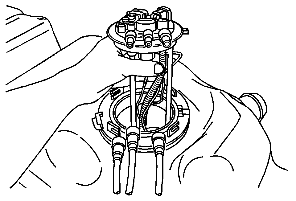

12. Lower the fuel tank until the electrical connections are accessible.
Pic 4
13. Remove the fuel sending unit connector position assurance (CPA) connector.
14. Disconnect the fuel sending unit and pressure sensor electrical connectors (1).
15. Completely lower the fuel tank.

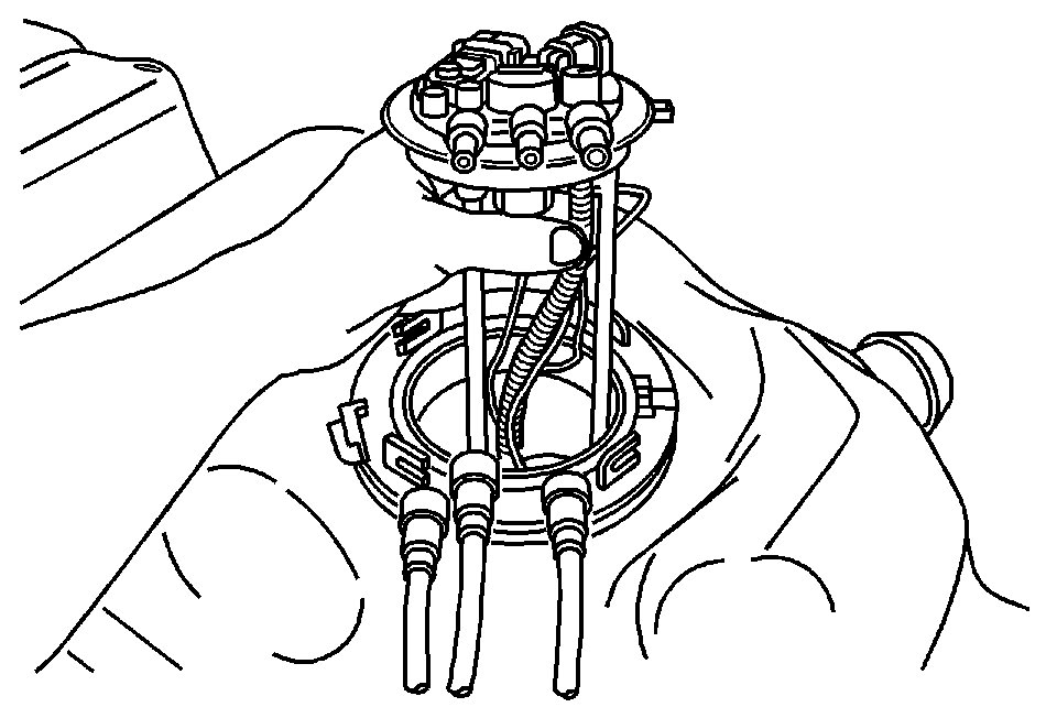

Pic 5

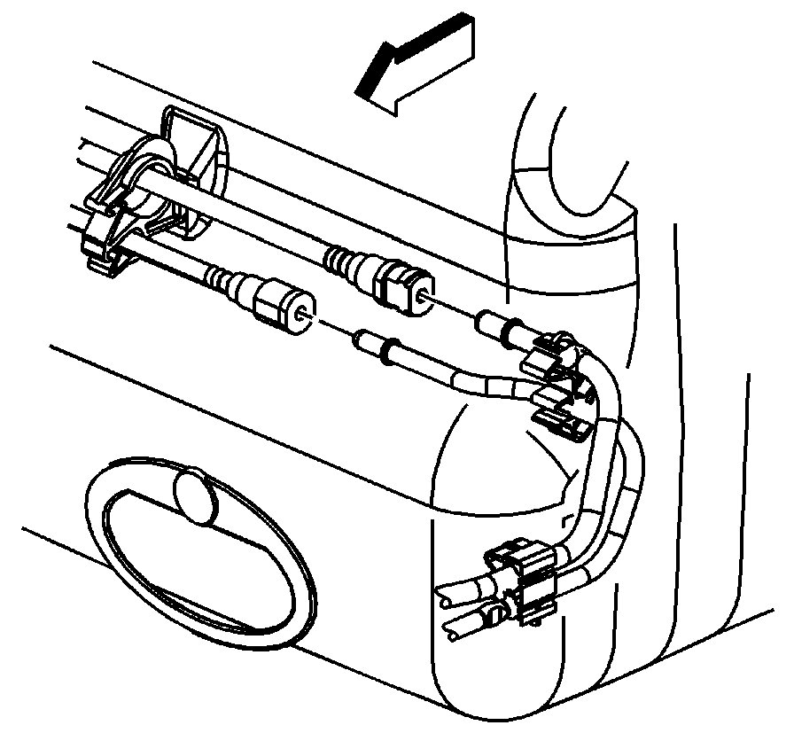

17. Disconnect and remove the fuel feed (3) and return (2) pipes from the sending unit and retaining clips.
18. Disconnect and remove the EVAP pipe (1) from the sending unit, roll over valve (3), and retaining clip.
19. If replacing the fuel tank, remove the sending unit.
Pic 6

8. Install the fuel tank straps.
NOTE: Refer to Fastener Notice in Service Precautions See: Powertrain Management > Vehicle Damage Warnings > Fastener Notice.
9. Install the fuel tank straps bolts.
Tighten
Tighten the bolts to.40 N.M (30 lb ft).
10. Remove the adjustable jack from under the fuel tank.

Fuel Sender Assembly Replacement
Vehicle Powertrain Management Fuel Delivery and Air Induction Fuel Tank Unit Service and Repair Procedures Fuel Sender Assembly Replacement
FUEL SENDER ASSEMBLY REPLACEMENT
TOOLS REQUIRED
J 44402 Fuel Tank Sending Unit Wrench
pic 12
REMOVAL PROCEDURE
1. Remove the fuel tank.
2. Disconnect fuel lines from the sending unit, if required.

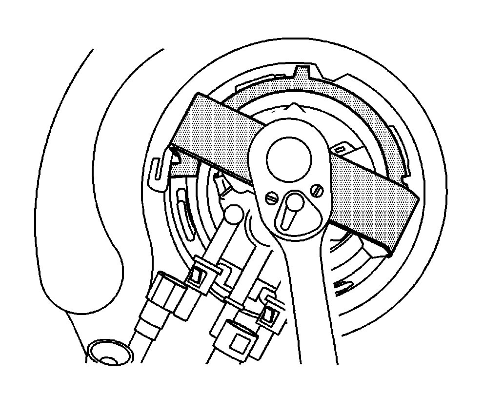

3. Using J 44402, remove the sending unit lock ring.
Pic 13
4. Remove the sending unit and seal. Discard the seal.
CAUTION: Drain the fuel from the fuel sender assembly into an approved container in order to reduce the risk of fire and personal injury. Never store the fuel in an open container.
