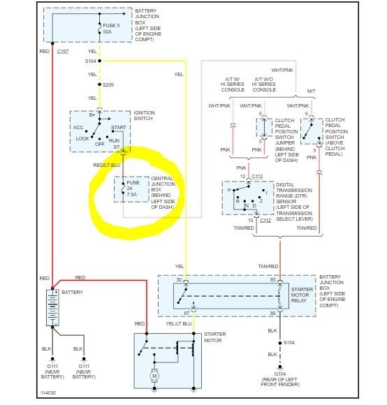

Starter not working engine not cranking over?

Hello, I have the SUV listed above v6 efi engine ohv I believe. The SUV ran and started fine before today. Now when I turn the key I hear a click, it sounds like it is coming from inside the vehicle and it is not starting. Is it the starter?

Good morning,
It is possible but needs to be verified.

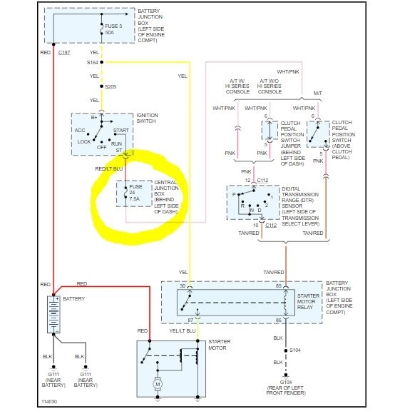

I attached a wiring diagram for you to view to check for powers going to the starter.
These guides can help us fix it
and
Check the fuse circled for power on both sides with the key in the start position. Check out the diagrams (Below). Please let us know what happens.

That fuse is inside the vehicle in the fuse box? How would I properly check if it's power coming from it?
Monday, February 25th, 2019 AT 10:12 AM
You need a test light. You can get it at a parts store for under 10.
Test for power on both sides.

Update: well don't I feel embarrassed the SUV wasn't fully in park, my gear shift has an issue to where you have to secure it into park especially on a hill. Now it is starting, lol. But thank you for all your helpful information.

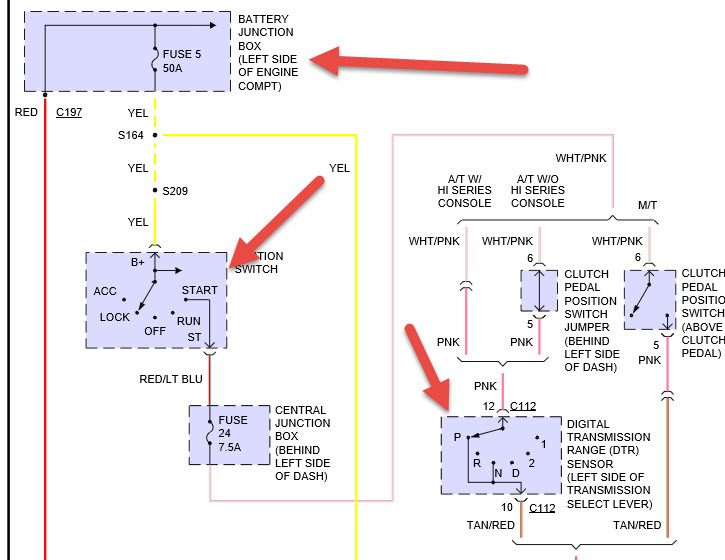

At first I could shift in neutral and it would crank but after a few days it wouldn't do that. But when the engine cools completely down it cranks fine in park. But when the engine gets warm it won't. I thought it was the safety neutral switch but I've never had one do that before. Usually it goes out its out. Any ideas?
Thursday, December 31st, 2020 AT 8:53 AM (Merged)
HMAC300
  • 48,601 POSTS
Check items in pic and starter relay for corrosion on prongs, use dielectric compound on them then have it scanned for codes to see if range selection switch on trans is bad. Auto parts does for free.
