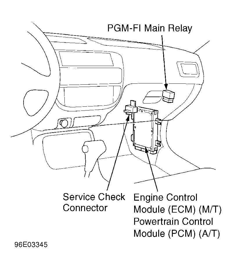

Car will not start and when I turn the car on there is a clicking noise from behind the glove compartment. What could it be not making it start?
Sunday, February 25th, 2018 AT 7:15 AM
9 Replies
PATENTED_REPAIR_PRO
  • 1,853 POSTS

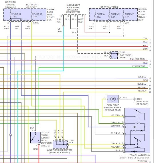

I am assuming that is the PGM-FI Main Relay which is shown in this diagram.
It runs the fuel pump.
Can I assume the starter is cranking over but the engine just will not start?
I will assume your answer is yes, so first check the fuses #31, #13 in the under dash fuse box and #44 in the under hood fuse box. If they are all okay, try a new PGM-FI Main Relay.

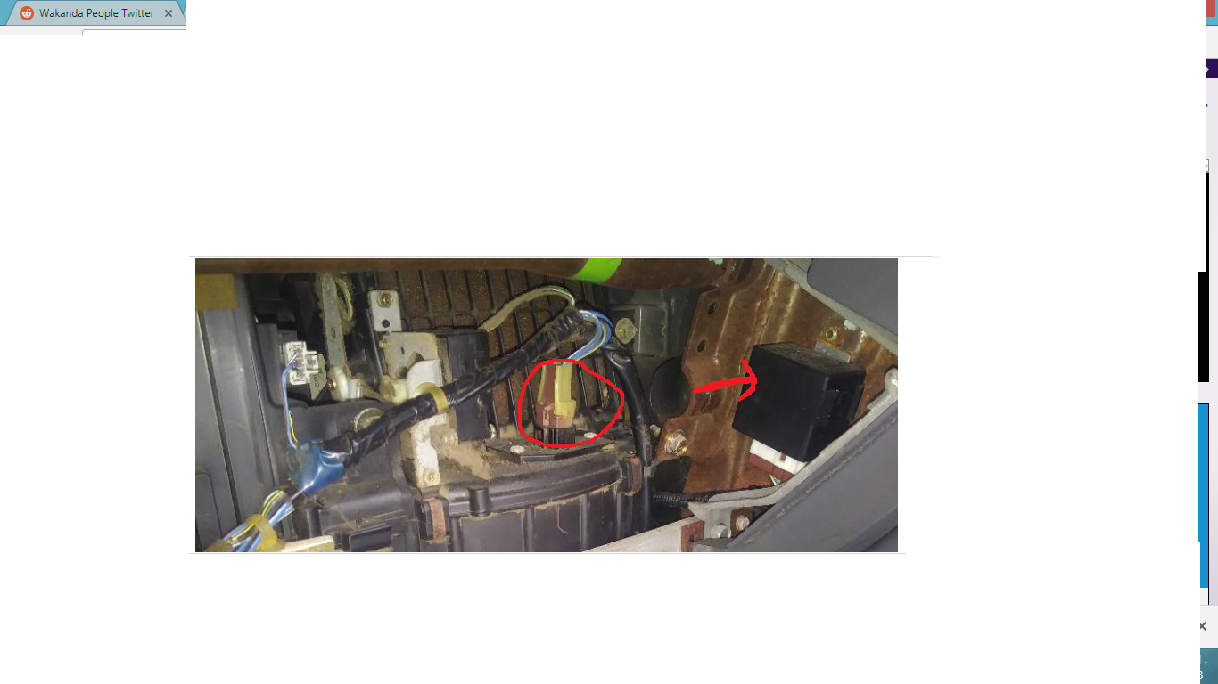

The black box is what is clicking and the circled item. Is that the main relay?
Wednesday, February 28th, 2018 AT 9:51 AM
PATENTED_REPAIR_PRO
  • 1,853 POSTS
They are both clicking? Have you tried disconnecting the wiring plug to each, starting with that item that you are pointing to, which appears to be that PGM-FI Main Relay and listen if the clicking goes away?

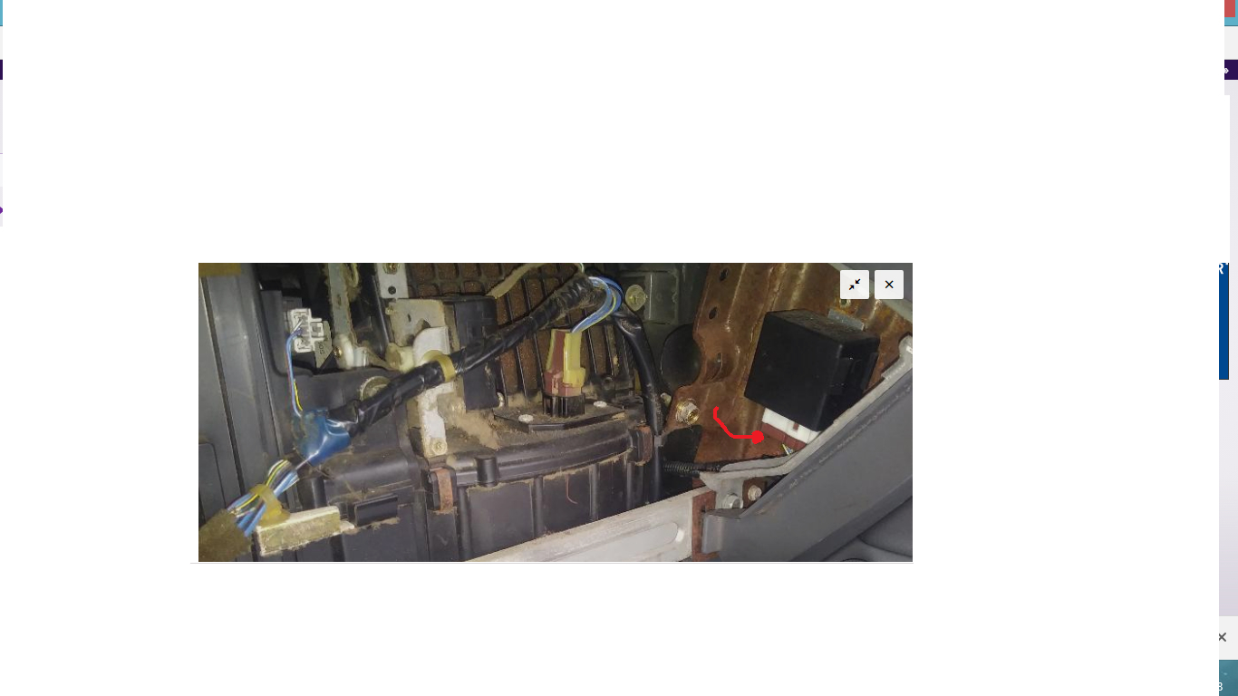

Oh so the black box is the main relay? Thats the only thing that clicks when I turn the car on. Do I unplug it from where I put the arrow?
Wednesday, February 28th, 2018 AT 10:19 AM
PATENTED_REPAIR_PRO
  • 1,853 POSTS
Yes, unplug it there.
If it stops clicking after unplugging it, go ahead and check those fuses I mentioned earlier and if they are all ok, try a new PGM-FI Main Relay
