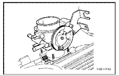

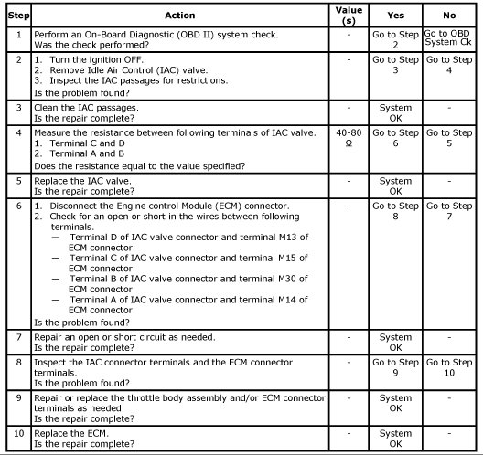

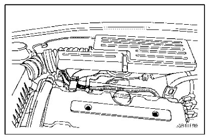

My car will not start unless I pump the accelerator, then backfires bad then starts. But revs as high as it can go and does not stop. So I have to shut it off right away. What is going on with it?

Hi and thanks for using 2CarPros. Com. Your vehicle has an idle air control valve, IAC. The component allows metered air to enter the engine so it can run without touching the throttle. The first thing I would recommend is to scan the computer to determine if there are trouble codes stored which may indicate where the problem is coming from. If you find nothing, I have attached a flow chart to guide you. Additionally, here are the directions specific to your vehicle from AllData. Please pay close attention to the relearn section. If for any reason the power supply was interrupted, you must go through the relearn process.

The IAC valve is extended and retracted by the IAC driver. IAC valve movement is verified by an engine speed change. If no change in engine speed occurs, the valve can be removed from the throttle body and tested. Connect the IAC driver to the removed IAC valve and turn the ignition ON. Do not start the engine.
This step checks the quality of the IAC valve movement in Step
Fully extending the IAC valve may cause an engine stall. This may be normal.
Steps 2 and 5 verify proper IAC valve operation. This step checks the IAC circuit for a wiring or ECM fault.

The idle air control valve is located on the throttle body. This component is at the end of the air induction tube that runs from the air filter box to the engine. I have attached a picture for your review. Additionally, I attached a picture of where the IAC is located on the throttle body.
I hope this helps.
