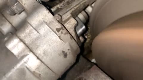

I shimmed the starter a couple months back and the scratching noise went away and a few weeks back it returned and I re-shimmed again, but the noise is still there.

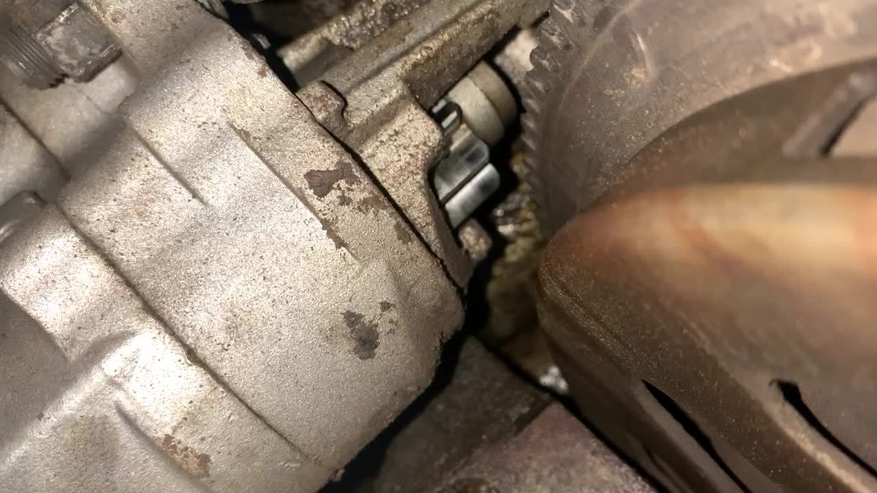

Okay, I couldn't wait, and I took a closer look and the flex plate (I think that's what it's called) is cracked and I think that's what's causing the noise. Let me know what you think.
Thursday, June 30th, 2022 AT 11:44 PM
YBJUAN
  • 15 POSTS
Here's a video of the Flex plate and starter (which I see isn't the problem now) and you can see the cracks on the flex plate.
Thursday, June 30th, 2022 AT 11:51 PM
  • 110,192 POSTS
Absolutely, if it is cracked and it appears it is, that's what you are hearing. Also, based on the video, it sounds loud in that area.

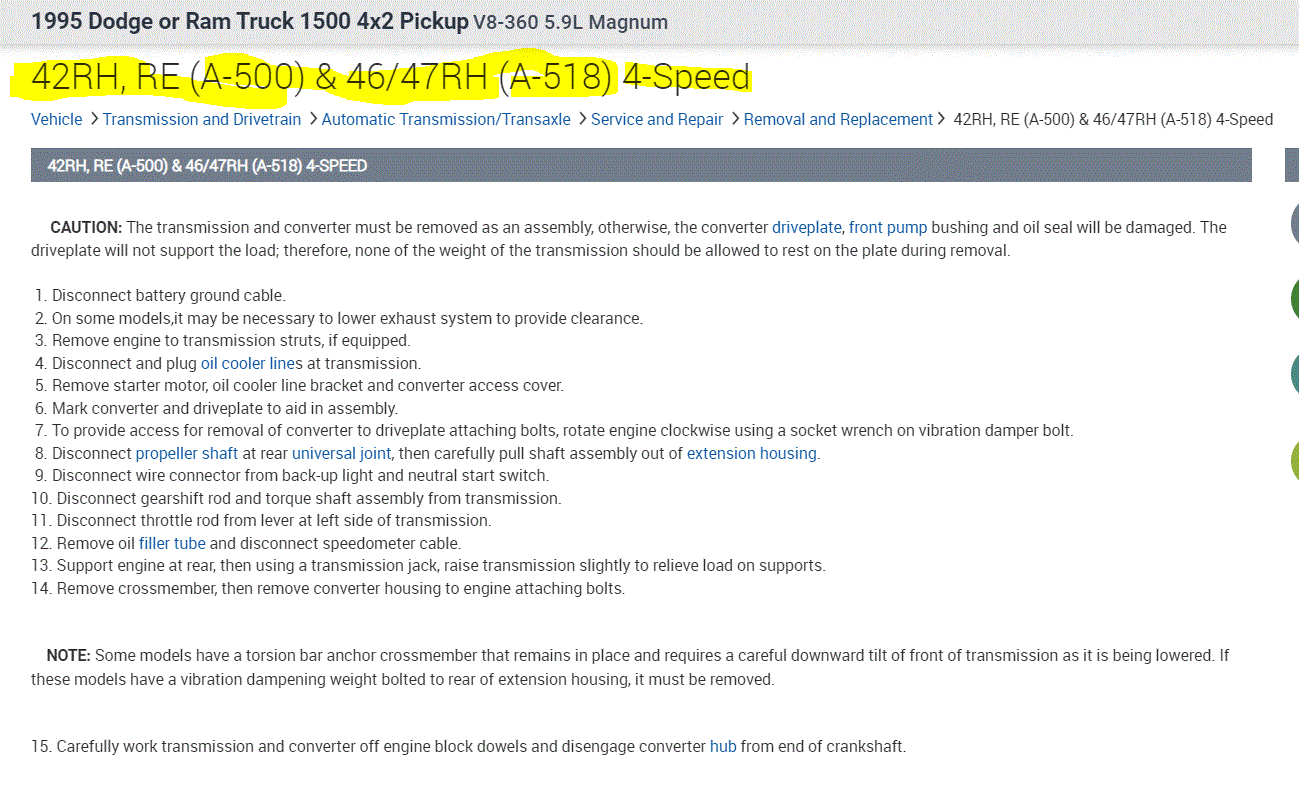

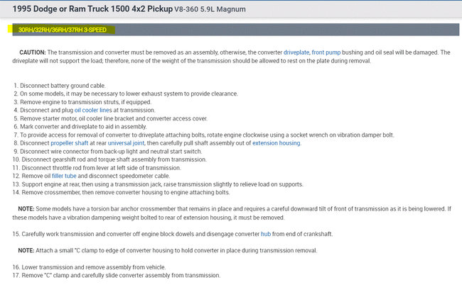

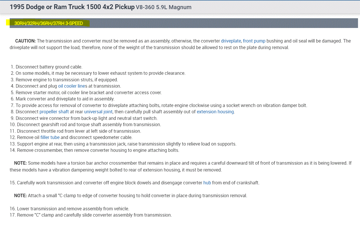

You will need to remove the transmission and torque converter to access the flex plate. I'm not sure if you have a 3-speed auto or 4-speed automatic transmission, so I attached the directions for replacing both below.

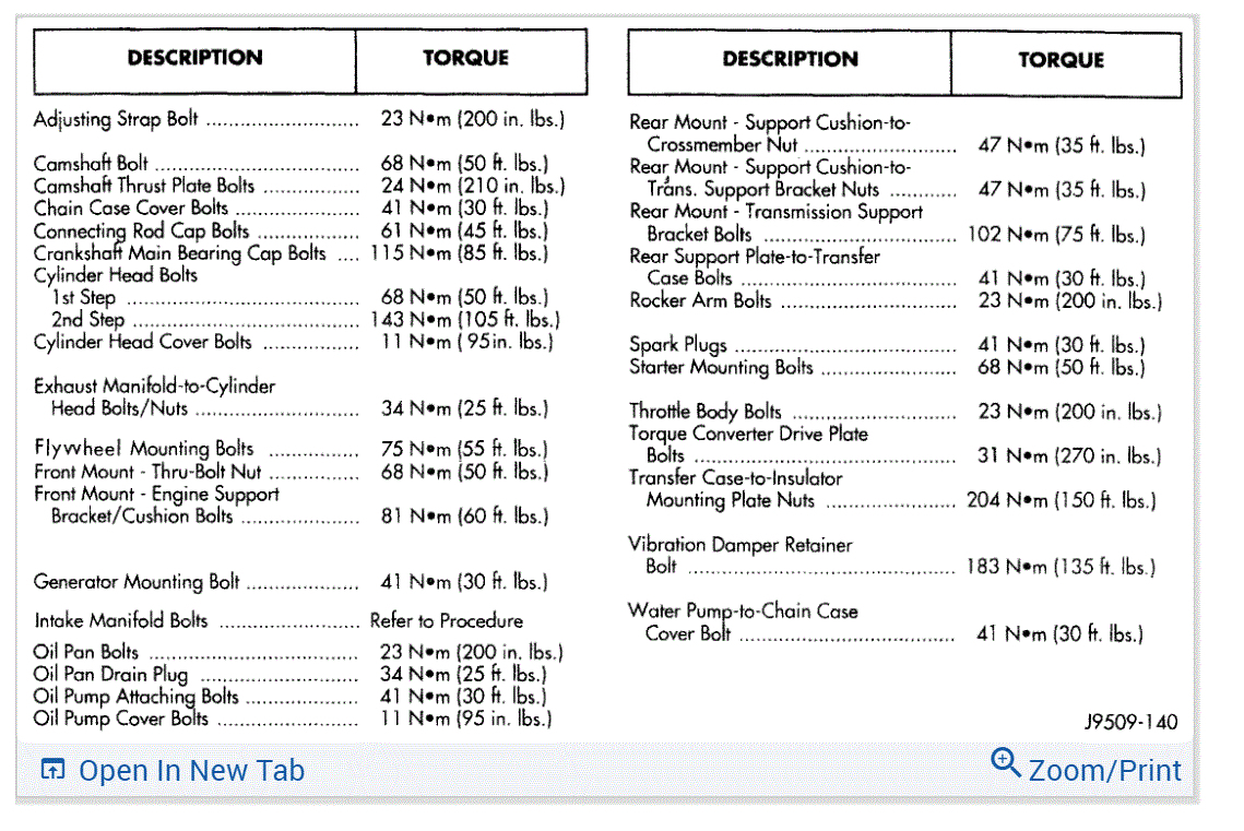

Additionally, pic 3 shows the torque specs for the things you will be working with.
