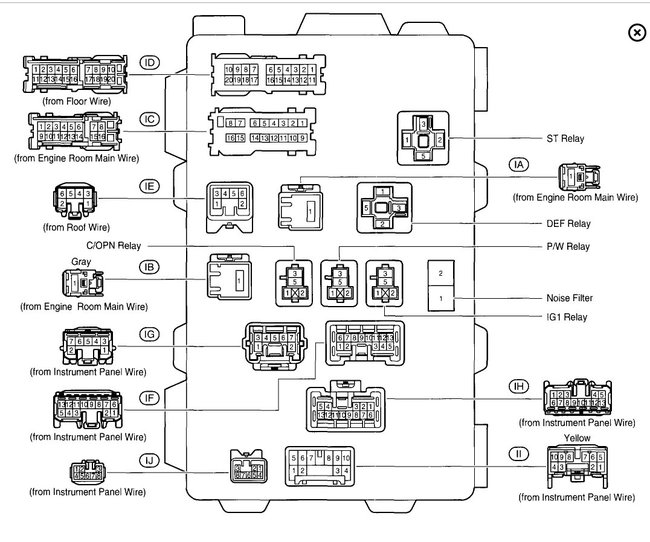

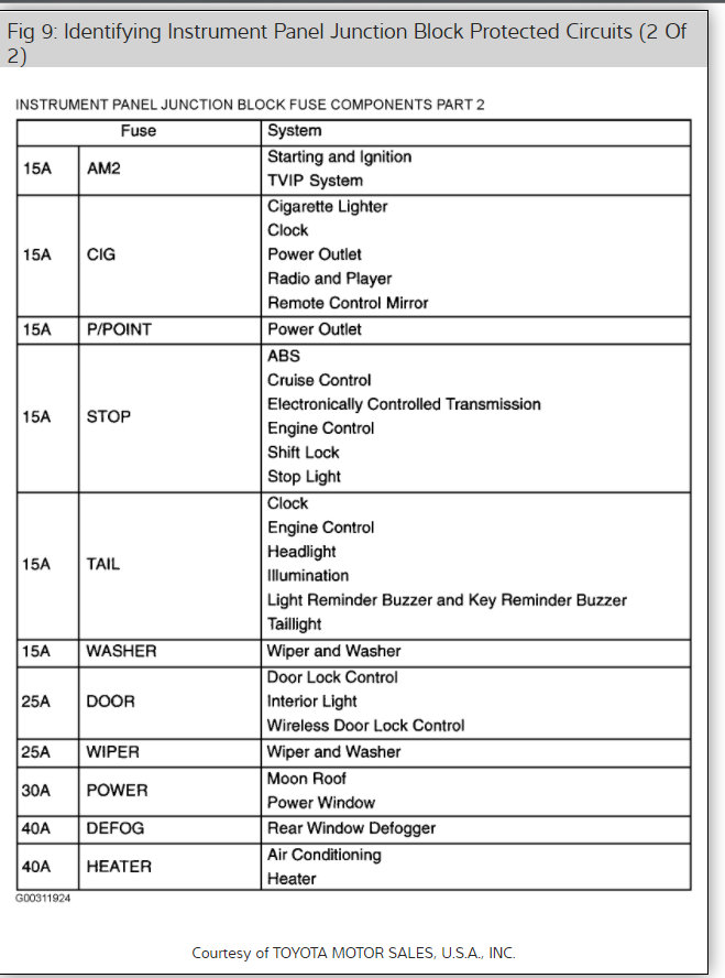

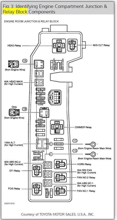

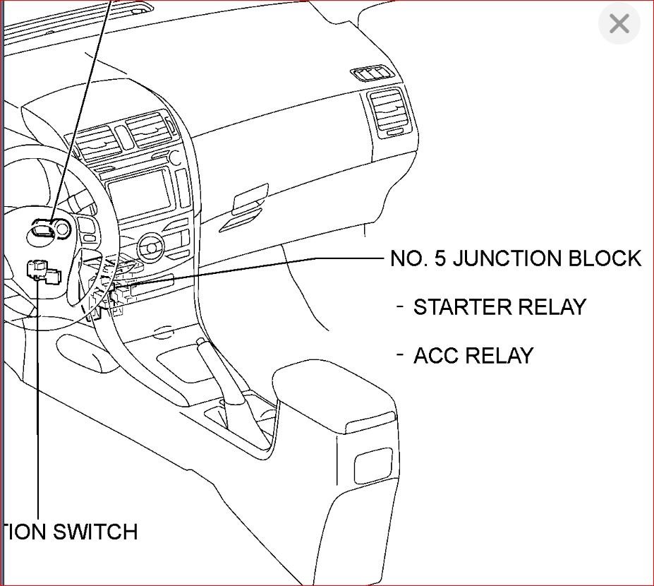

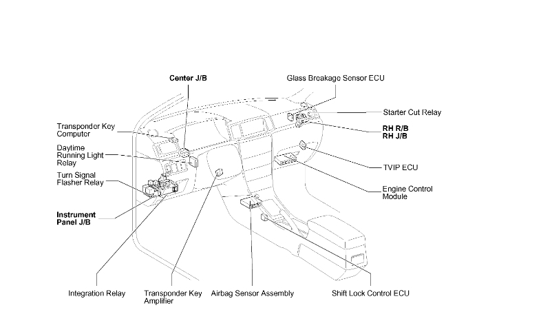

Where’s the starter relay located?
No crank, no start. Replaced couple of fuses.
Monday, June 17th, 2019 AT 12:13 PM
19 Replies

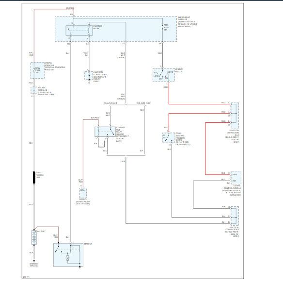

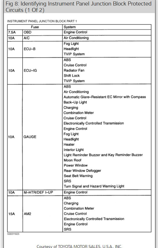

Hi Sichavez,
Attached is the location of the relay. Looks like it is in Junction Box 5.
This guide can help you test it
Check out the diagrams (Below). Please let us know if you need anything else to get the problem fixed. Please let me know if you need more information. Thanks

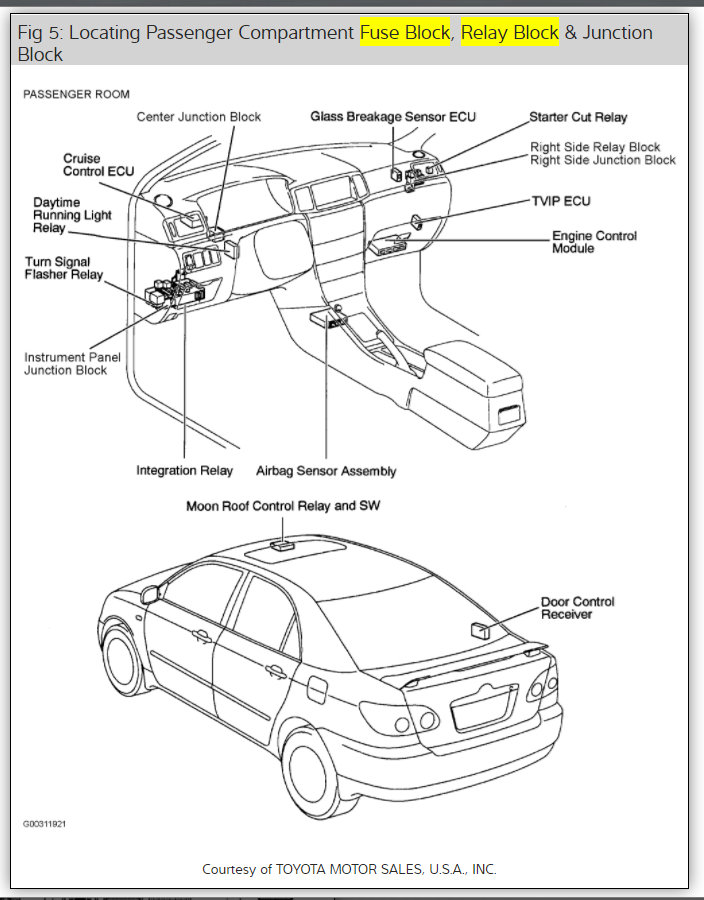

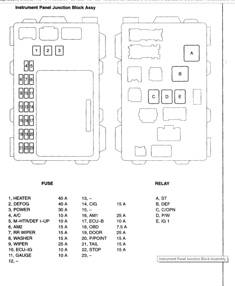

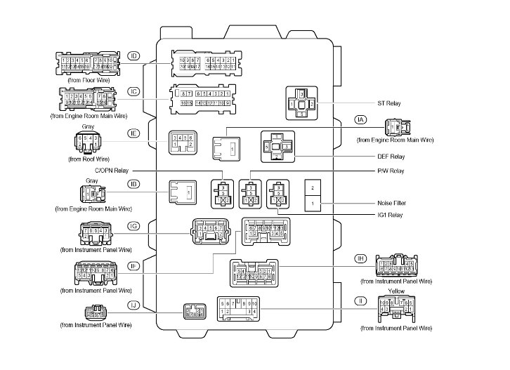

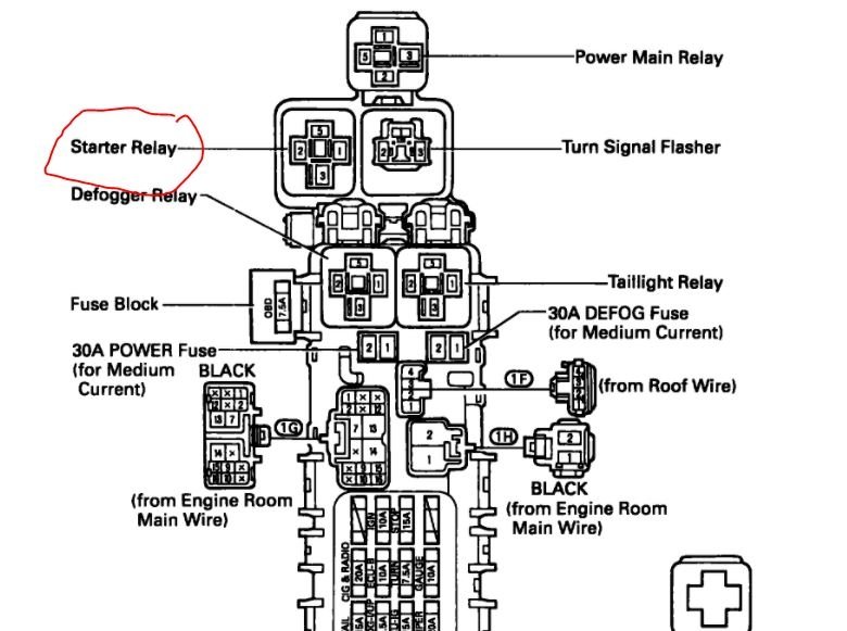

Where is the starter relay located in the CE model?
Friday, January 8th, 2021 AT 7:17 PM (Merged)

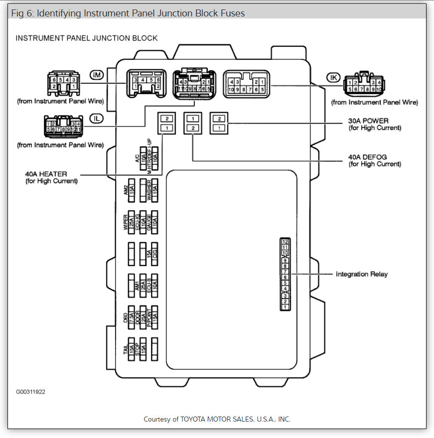

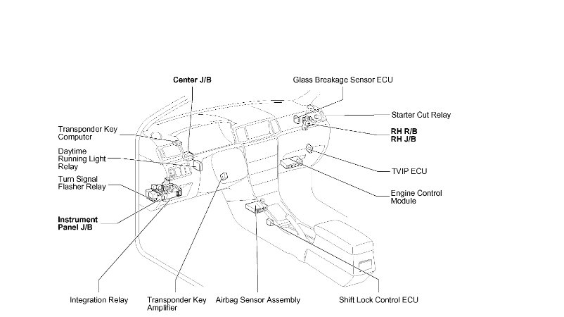

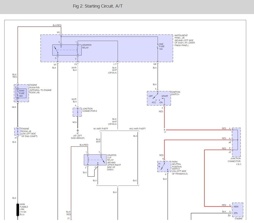

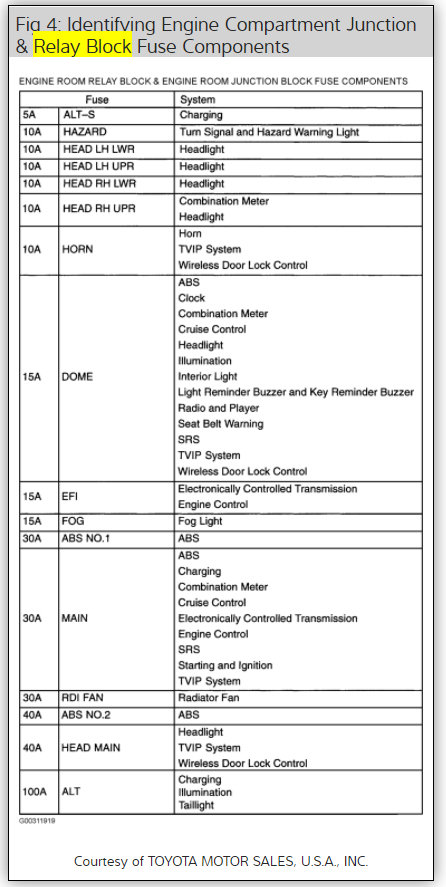

Good afternoon,
It is in the junction box in the car under the left side (ST relay). I attached pictures for you of the location and where the relay is located as well. I also attached a wire diagram of the starting system for you. Check out the diagrams (Below). Please let us know what happens.

The starter relay is in the inside fuse box on the left side of the dash.
If the jumper cables were switched, there are likely a number of blown fuses. Check those first if you have a problem you're trying to solve.

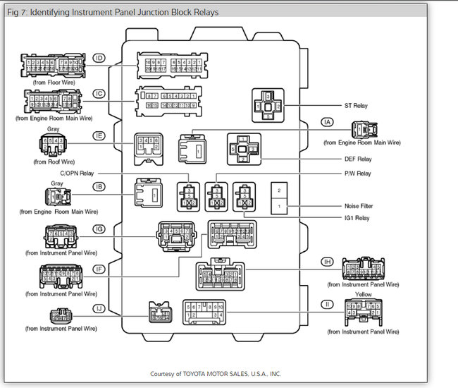

I am looking for the starter relay and I cant find it?
+2
Wednesday, January 13th, 2021 AT 9:34 AM (Merged)
KEN L
  • MASTER CERTIFIED MECHANIC
  • 54,695 POSTS
It is the ST relay in the relay/fuse box In the diagrams below.
Here is a guide that will help you test the relay along with a wiring diagram (below) so you can test the system.
and
Please run some tests and get back to us so we can continue helping you.

Where is the starter relay and fuse located?
KEN L
  • 54,695 POSTS
The starter relay is located on the passenger's side under the dash. Here is a guide to help test it.

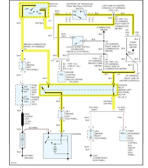

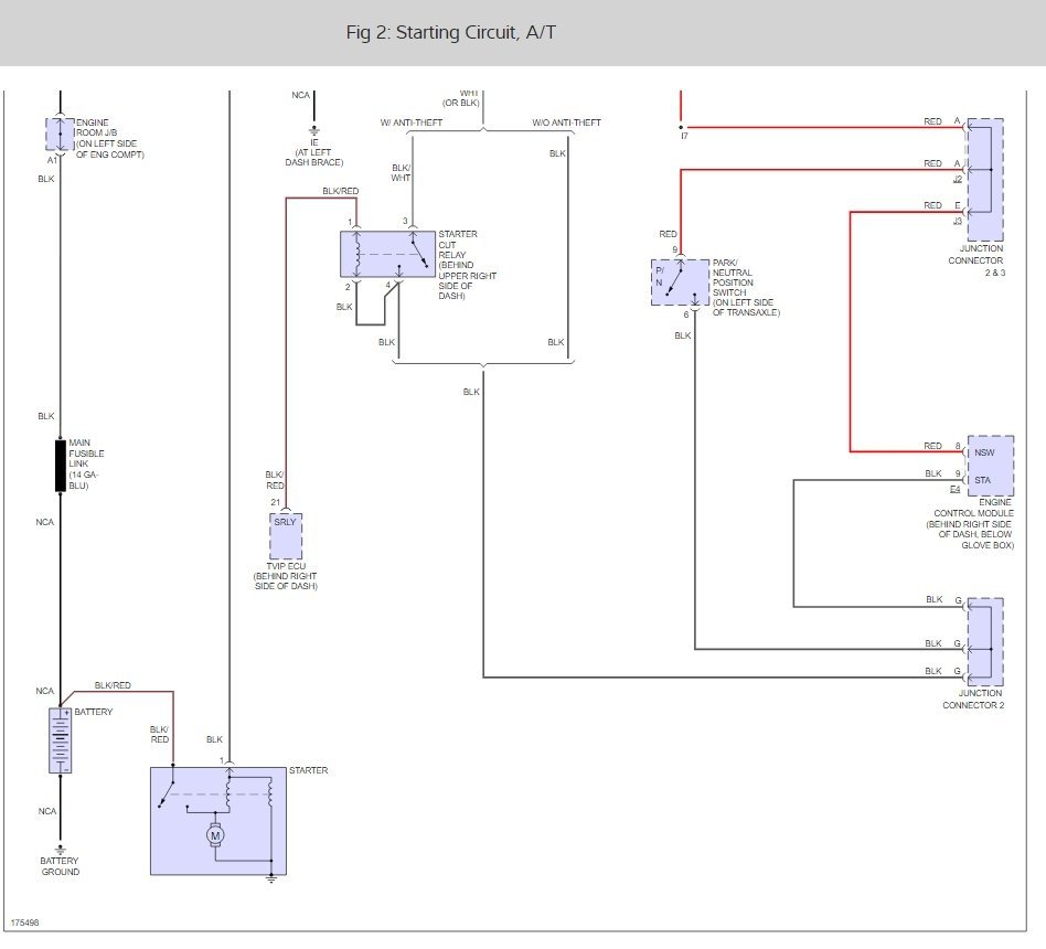

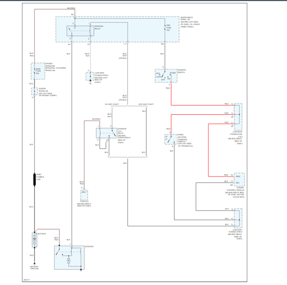

I had a no click no crank start issue and proceeded to replace the starter relay. When I replaced the relay the 30a fuse blew out. So I replaced it only to have it blow again. Did a little research online and decided to replace the ignition switch, the starter and replace the blow 30a fuse. After completing all this I went to reconnect the battery terminal and the starter started cranking the engine without me turning the key. It does this every time I try to reconnect it. Any advice would be very much appreciated.
Good afternoon,
Since all this started with the relay, I would go back to that. You may have the wrong relay or have installed it wrong.
I attached a diagram of the system for you to view.
Check for power to the relay with the key on. Then test for power on one terminal in the start position.
