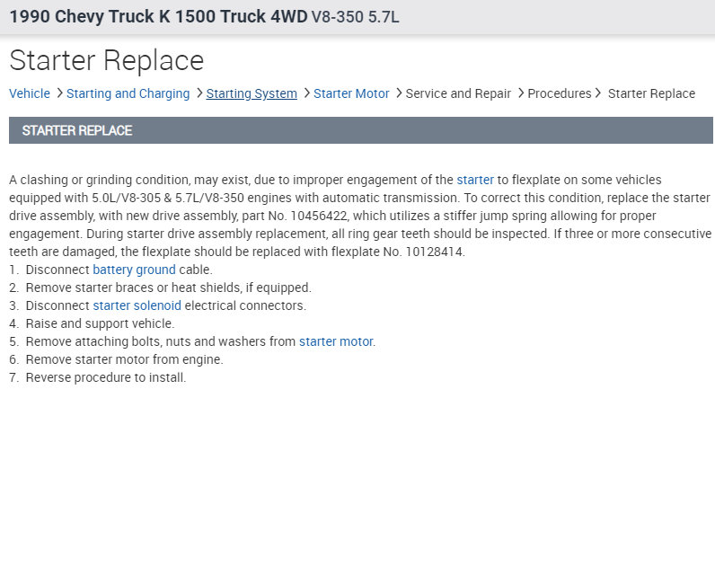

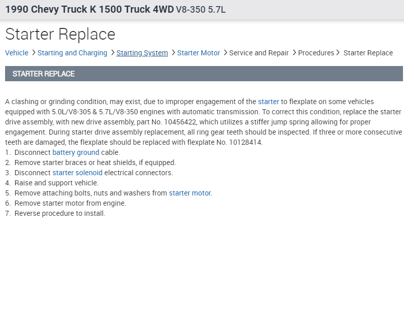

The starter from a 2007 will not fit a 1990.
Also, in 1990 they didn't have a 5.3L option. It was 5.7L or 5.0L, or a 4.3L V6.
Here is a helpful guide on starter replacement:
Let me know of any questions.
