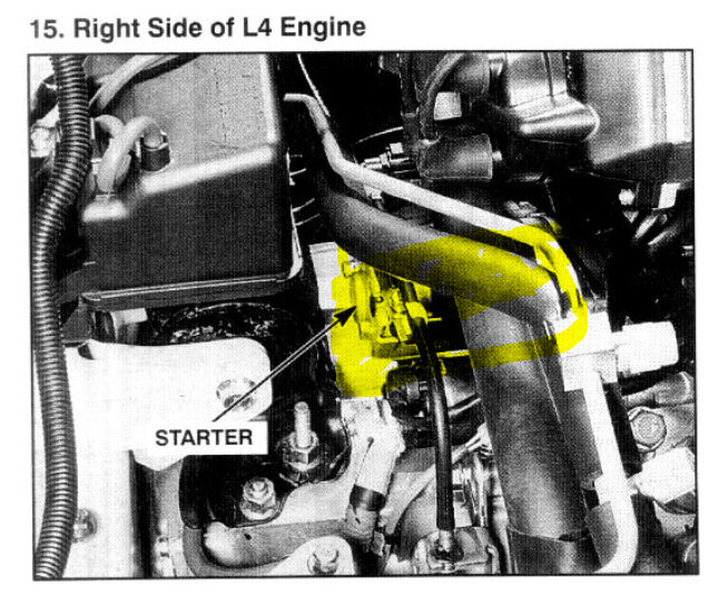

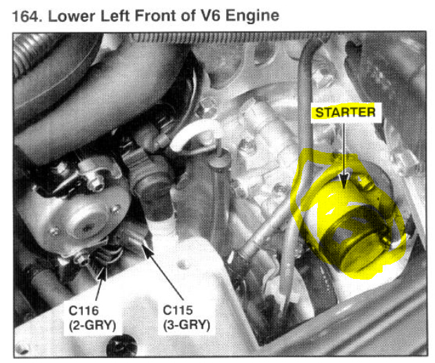

I'm not sure if you have a 4-cylinder or the V6, so I attached pics of both. If you are replacing it, let me know which engine you have, and I'll get you the specific directions for your vehicle.
Also, here is a link that explains in general how one is replaced:
Let me know if this helps or if you have questions.
see pics below.
