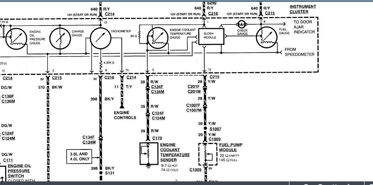

Did you check for power to the sender at the fuel tank?
Diagram attached.
Check the yellow/white wire for power with the key on.
Image (Click to make bigger)
