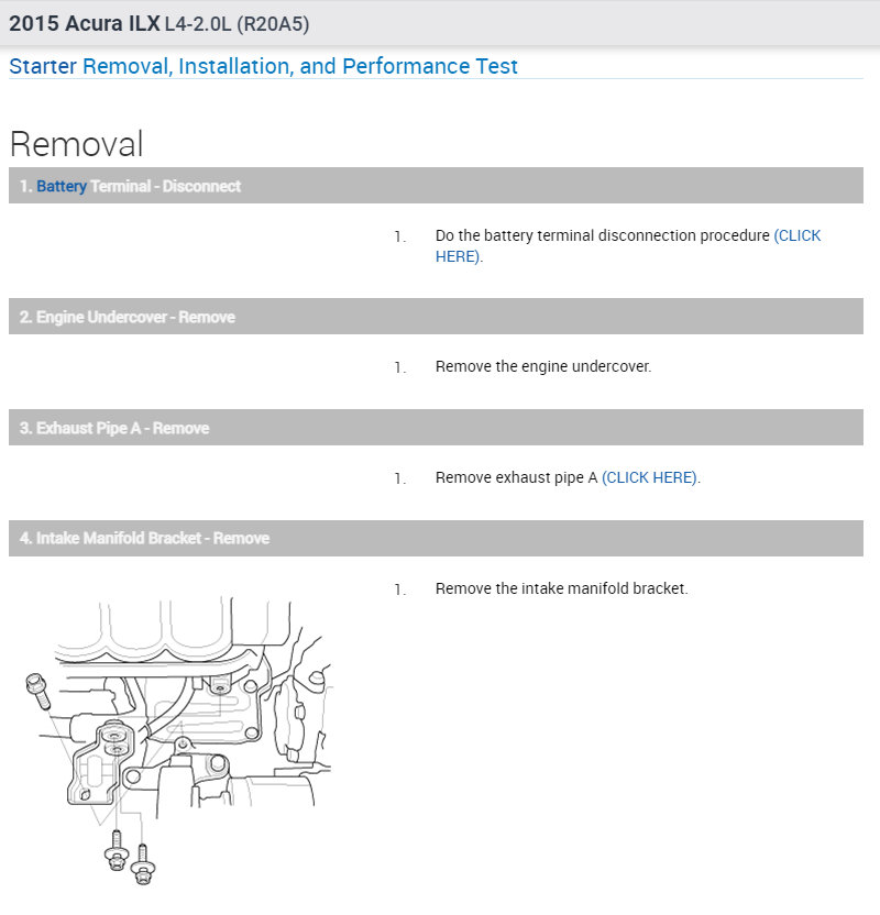

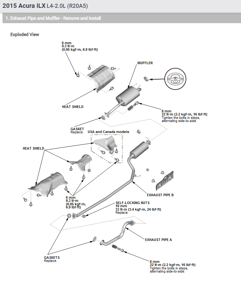

Starter location needed.
Saturday, September 24th, 2022 AT 1:31 PM
3 Replies
SQM
MECHANIC
6,383 POSTS

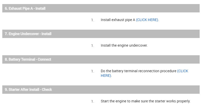

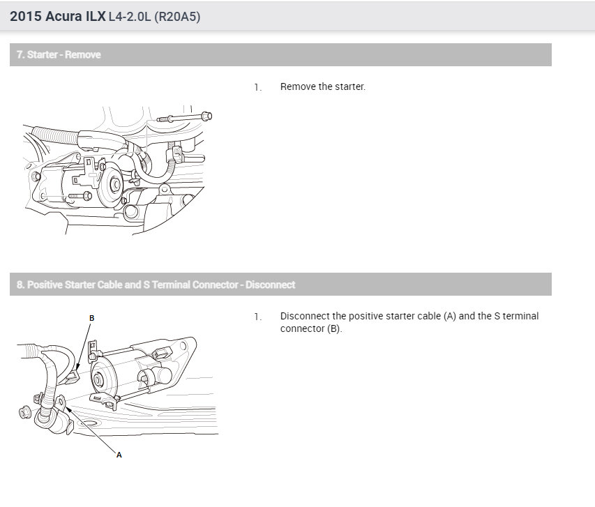

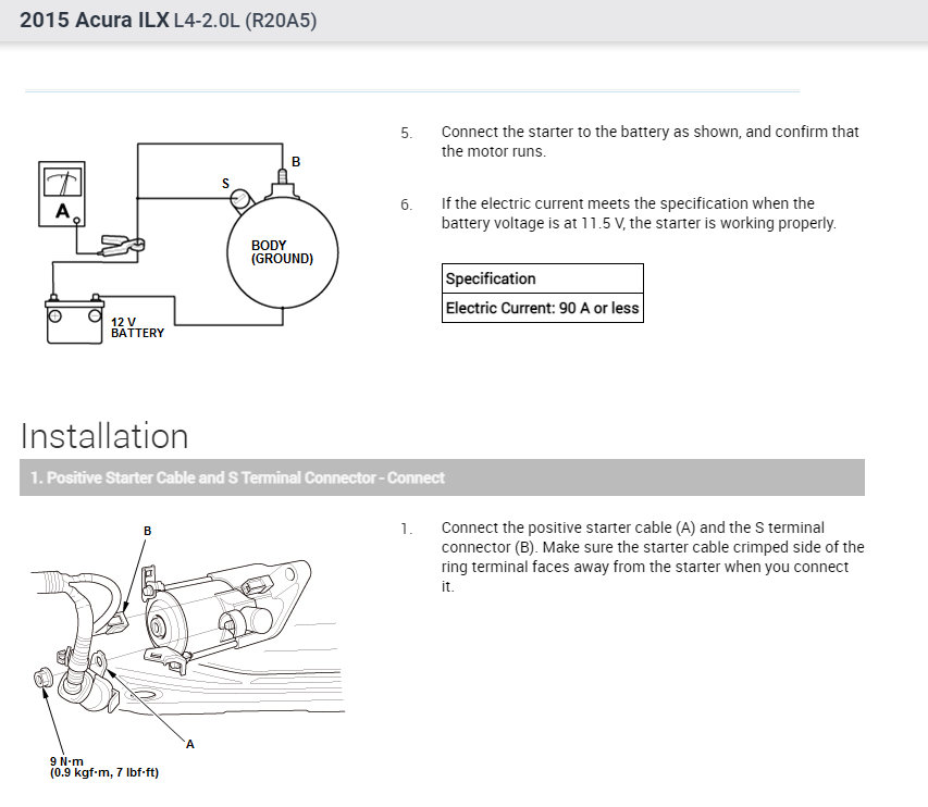

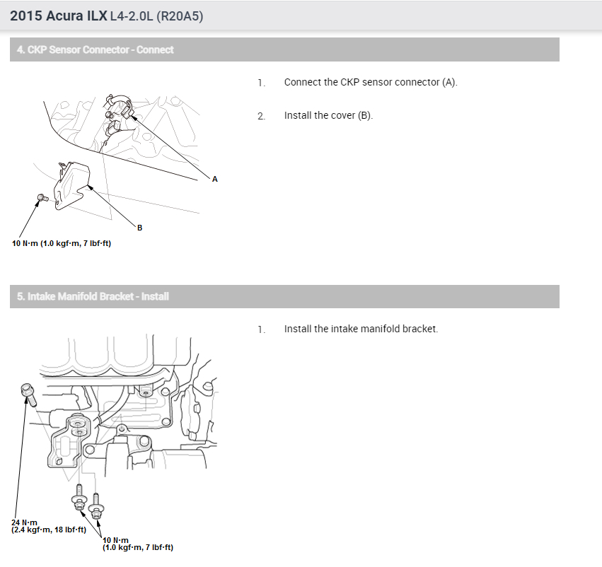

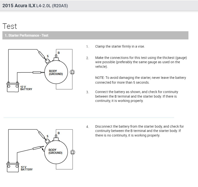

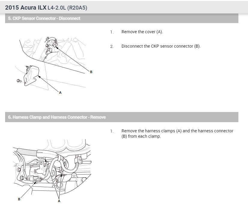

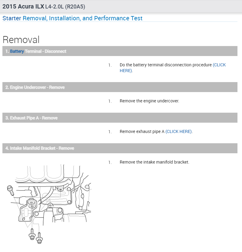

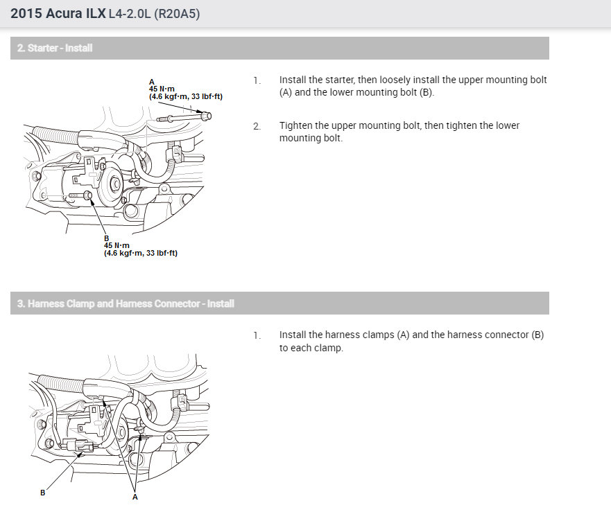

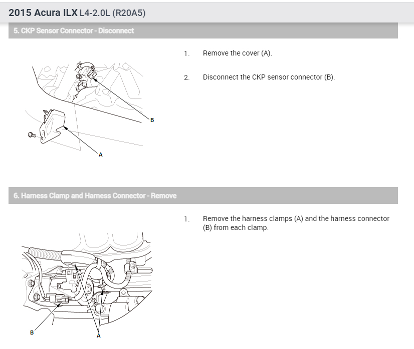

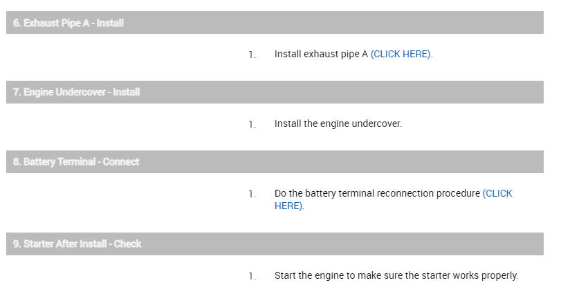

The starter is located on the front lower part of the engine. I have attached the replacement procedure below for your reference. Here is a generic guide to help you see the steps with instructions below to show you how on your car.
Check out the images (Below). Please let us know what happens. Let me know of any questions. Thank you.

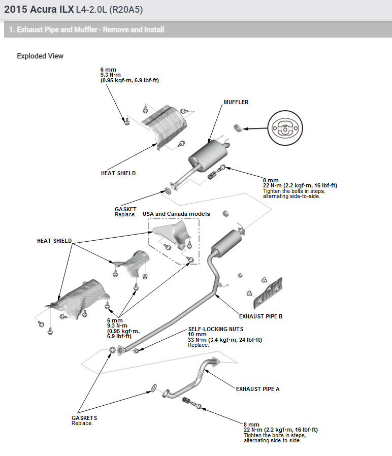

That’s awesome, thanks. Can you provide more detail on removing the exhaust manifold? I have to remove that to get to the starter.
-1
Saturday, September 24th, 2022 AT 5:52 PM
SQM
MECHANIC
6,383 POSTS
See attached for the exhaust diagram.
Image (Click to make bigger)
