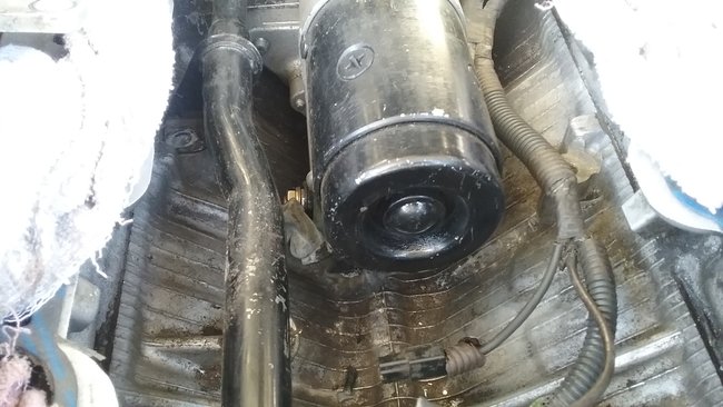

I have recently purchased a new starter and put it in, put it all back together and when I went to start it it started to start before I got the key to the start position. so now I have recently checked the battery and it is good, I also checked the big wire that goes to the starter it had power. so I checked the little wire's and neither had power. i hope you will help me with my car. Sincerely, Tim Newton

I tested the fuse box where the starter relay switch is and I used a test light the big wire had power but the one that plugs in did not. The one on the solenoid does not either.

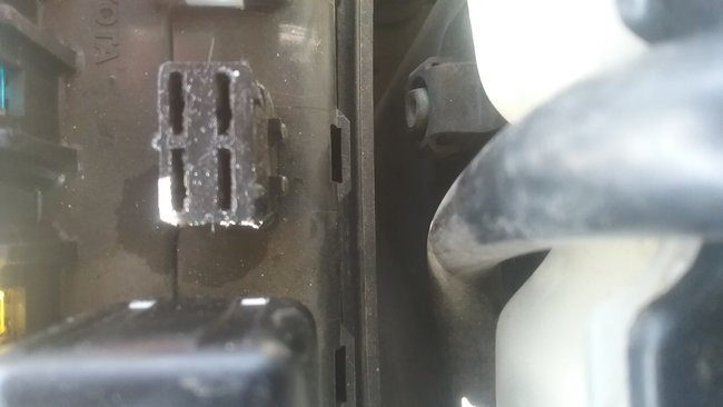

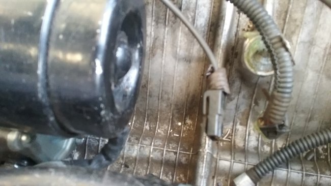

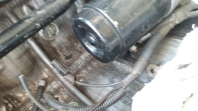

Here are those pictures you requested:
Apr 24, 2018 at 6:41 PM
TIMMAHANEY
  • 65 POSTS
Here are some pictures:
Apr 24, 2018 at 6:42 PM
TIMMAHANEY
  • 65 POSTS
And more.

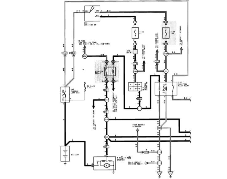

Okay, sorry I thought you meant it was fixed.
I attached a wire diagram for you to view.

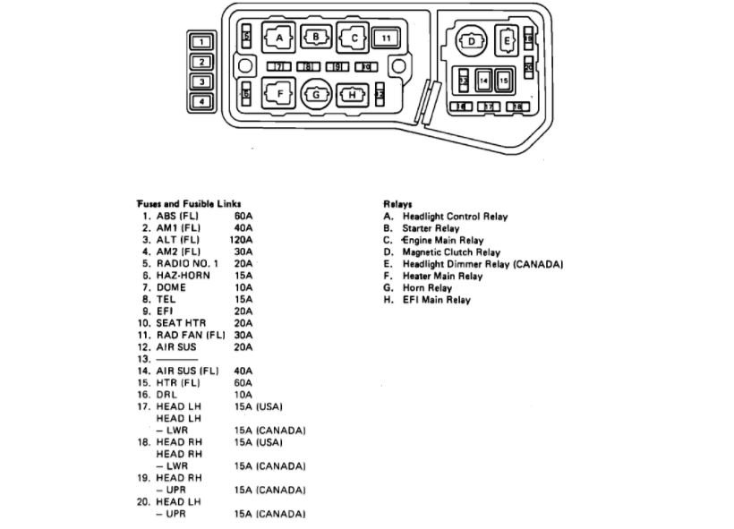

Do you know where the starter relay is located?
Apr 26, 2018 at 4:03 PM
TIMMAHANEY
  • 65 POSTS
Yes, in the fuse box on driver's side under the hood.

Okay, can you check for power to the relay with the key on? remove the relay and test. Leave the little wire for the starter off.
Apr 26, 2018 at 4:18 PM
TIMMAHANEY
  • 65 POSTS
I tested and there is power in one hole bottom right.
Apr 26, 2018 at 4:25 PM
TIMMAHANEY
  • 65 POSTS
Tested power bottom right hole.

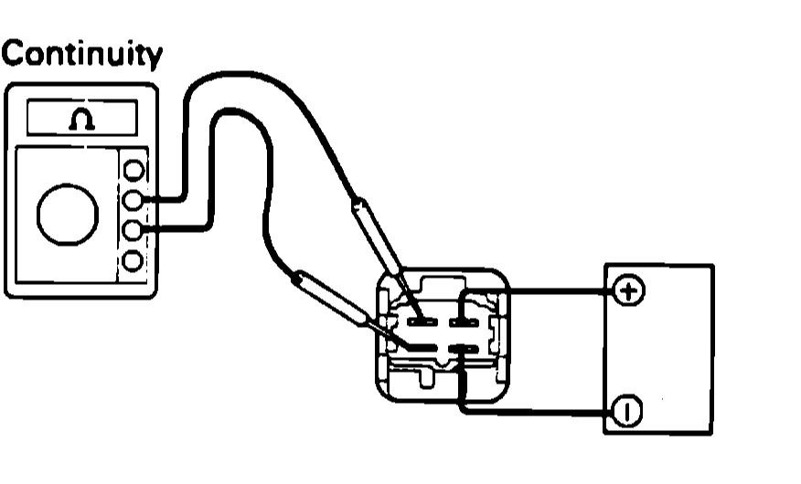

Relay test:
1. Apply battery voltage across terminals 1 and 3, Fig 6.
2. Using an ohmmeter, ensure there is continuity across terminals 2 and 4.
3. If no continuity exists, replace relay.
Apr 26, 2018 at 4:36 PM

No, the test for the relay is done with the relay out of the fuse block. You need to apply power and ground to the relay terminals as shown in the diagram I sent you, then you measure the ohms on the other two terminals.
Apr 26, 2018 at 6:08 PM

And tell me inside the fuse box where the starter relay is. there are four pins. One always hot correct and that would be pin number two and I have to turn the key to the crank position right?
