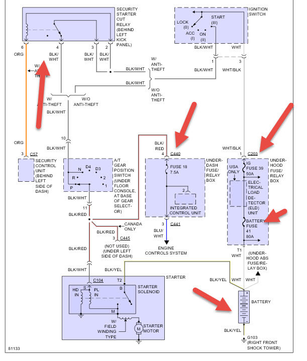

My car won't start the battery is charged and I got gas and oil inside the car what do I need to do to start my car in what part do I need to buy or replace

You don't replace anything until you find what is bad with it. It may have a security problem and needs to be reset look online for that. Otherwise check battery for condition including load test. Check items in pic if it turns over then check for spark
