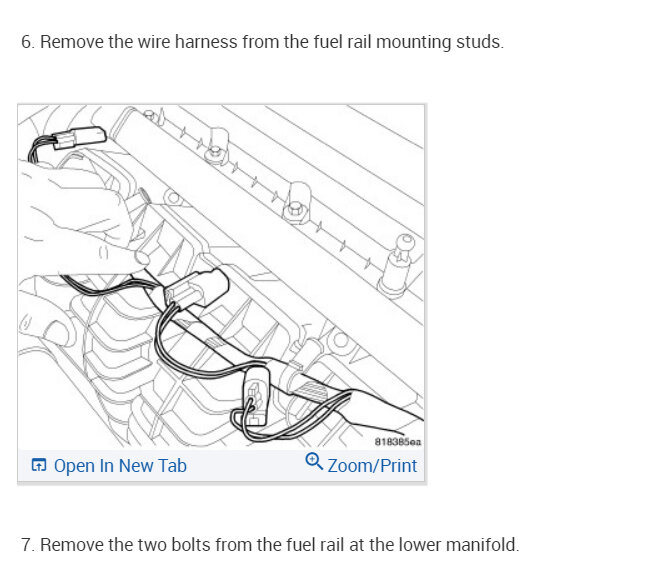

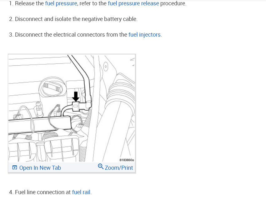

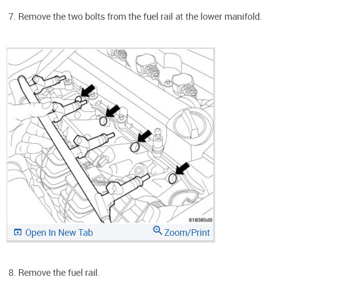

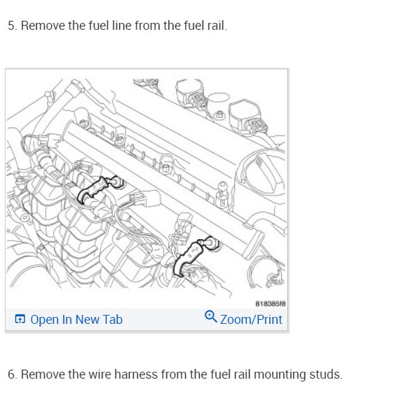

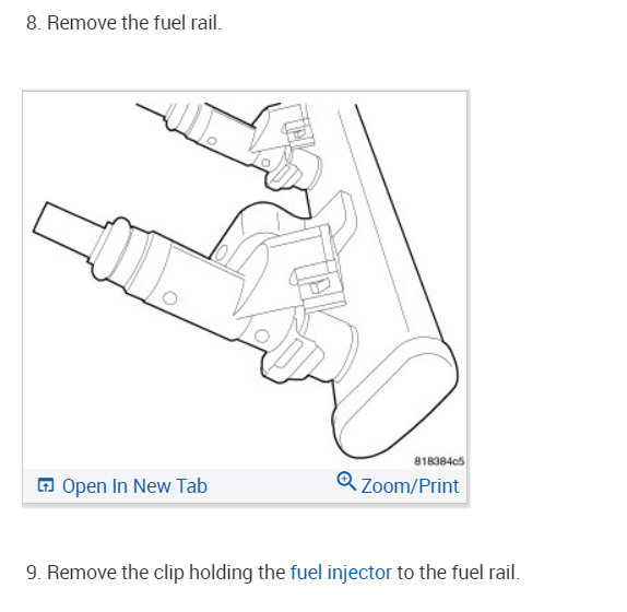

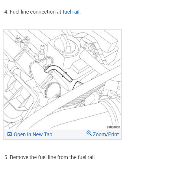

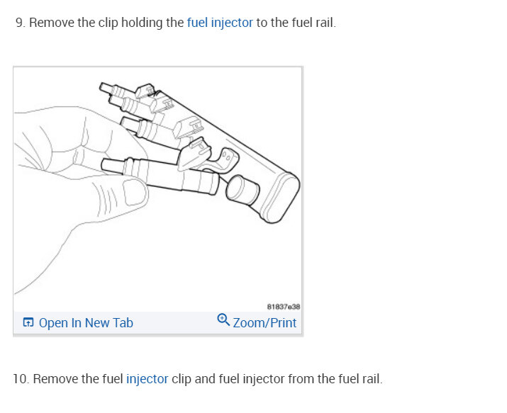

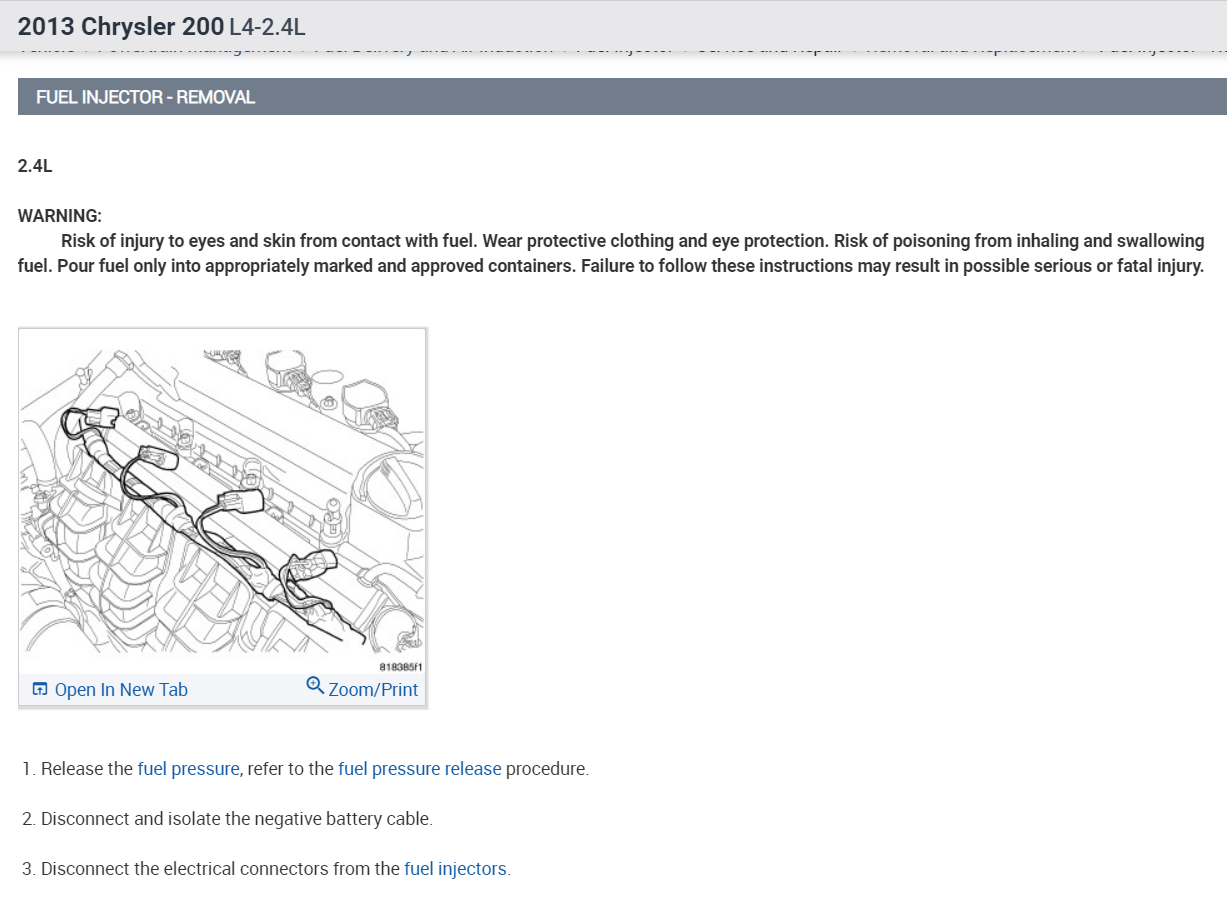

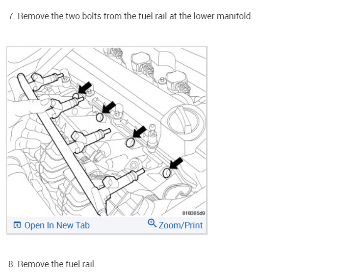

Can I ask you how the engine is running? Can you please shoot a quick video with your phone of the engine running under the hood? That way I can tell for sure what's going on. You can upload it here with your response. From what you have said it only leaves low compression or a fuel injector. Here is a guide to help check the compression and if that is okay to change out the fuel injector in the images below.
