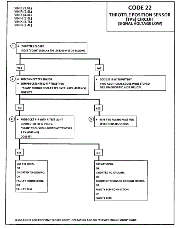

Thanks! I have 3 of each 22 and 45 codes. Throttle position sensor and O2 rich exhaust. Is the TPS part of the throttle body itself or is it separate? As the O2 sensor has been replaced could that be because of some kind of blockage in the exhaust? Maybe a piece of an old catalytic converter?
Tuesday, October 13th, 2020 AT 11:11 AM
  • 110,194 POSTS

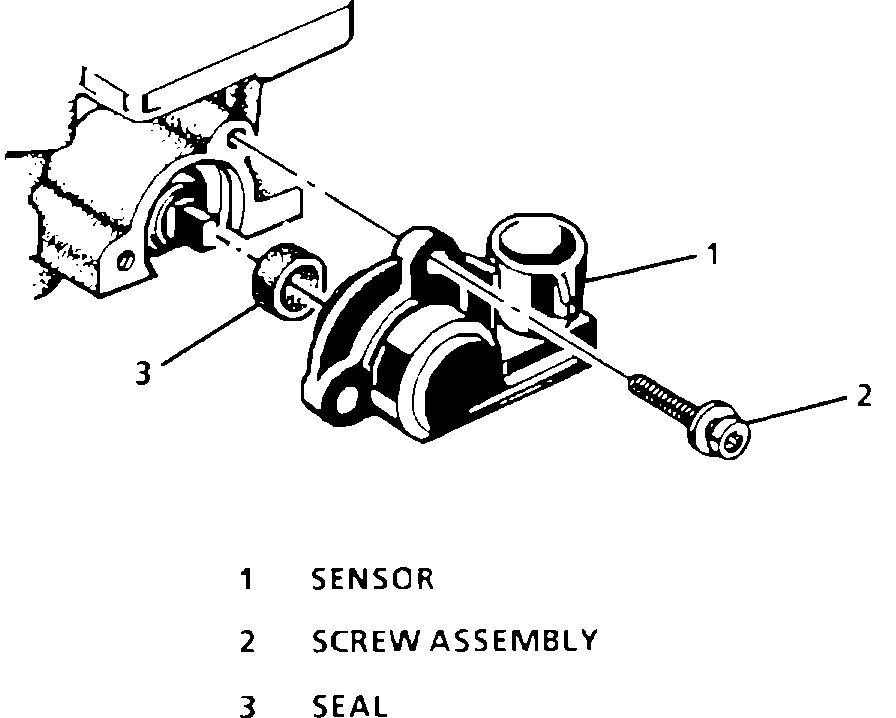

The code 45 is likely the result of the 22. As far as the TPS, it is on the throttle body and can be replaced. However, before you replace it, take a look through the diagnostic flow chart I attached below. (pic 1) It will help determine if it is bad or if there is a wiring issue. The code indicates low voltage, so chances are it is a loose connection, corroded connection, shorted wire and so on.

If you decide to replace it, here are the directions. Pic 2 correlates with these directions.
____________________
1990 Chevy Truck C 1500 Truck 2WD V8-350 5.7L
Throttle Position Sensor (TPS) Replacement
Vehicle Powertrain Management Fuel Delivery and Air Induction Sensors and Switches - Fuel Delivery and Air Induction Throttle Position Sensor Service and Repair Procedures Throttle Position Sensor (TPS) Replacement
THROTTLE POSITION SENSOR (TPS) REPLACEMENT
Throttle Position (TP) Sensor
Pic 2
REMOVAL:
1. Disconnect electrical connectors.
2. Remove the TPS attaching screw assemblies and retainer, (if applicable).
3. Remove TPS from throttle body assembly.
NOTE: The TPS is an electrical component and must not be soaked in any liquid cleaner or solvent, as damage may result.
INSTALLATION:
1. Install TPS to throttle body assembly, while lining up TPS lever with TPS drive lever on throttle body.
2. Install the two attaching screw assemblies. Tighten screw assemblies to 2.0 Nm (18.0 lb-in).
3. Install electrical connector to TPS.
4. Check for TPS output as follows:
a. Connect an ALDL scanner to read TPS output voltage.
b. With ignition ON and engine stopped, TPS voltage should be less than 1.25 volts. If more than 1.25 volts, replace TPS.

I ended up replacing the TPS and it has not fixed the problem. I started it up, put it in gear, put the emergency brake on and within 20 seconds it shut off. Could it be the throttle body itself?
Tuesday, October 20th, 2020 AT 10:04 AM
  • 110,194 POSTS
Did you have a chance to go through the diagnostic flow chart I provided above? That is what I suggest at this point. As far as the TB, yes it could be bad, but before you replace it, it really should be checked out.
